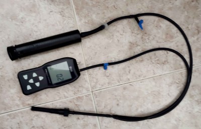

Postby Frank » 22 Dec 2022, 14:52
I have made a measuring tool to help me inflate the Roho cushion properly. When I am sitting in the cushion and have about 1.5 cm gap between me and the seat pan the reading on the meter is 60 mmhg. This reading looks high but it’s like that on my meter. I feel that the cushion is inflated properly like this.
Frank
Posts: 94
Joined: 09 Sep 2020, 11:17
Location: Malta
Re: PINNED - Cushions
Postby Burgerman » 22 Dec 2022, 14:59
So now you can inflate to that pressure without anyone there. No hand needed. You must do it with the air valve "open" on a multi chamber cushion. And close it while seated correctly. Also do it with arms rested on armrests. Lifting them raises the pressure! You may be better with a smaller gap, and using a different scale for your pressure. To get a finer more detailed pressure reading.
Posts: 71101
Postby Frank » 22 Dec 2022, 15:44
BM, when I connect the measuring tool to the Roho cushion and open the cushion's valve, the reading in the meter starts going down which means air is leaking. Yours is also like this or air does not go out and the reading stays the same? And do you use mmhg for measuring or something different?
Frank
Posts: 94
Location: Malta
Postby Burgerman » 22 Dec 2022, 16:30
You have a leak. No mine stays solid. Those little valves can leak, pipe connection can leak. The pumps all leak but a good one way valve shouldnt.
(28mHg) arms on armrests averaged although fairly consistent.
(31mmHg) arms lifted up also averaged and rounded to full digits.
Acceptable limits of peak pressure (generally over the ischial tuberosities) are 40-80mmHg if pressure is regularly relieved. Every 15 to 20 mins. According to many studies. People vary. This is from mapping via a pressure mapping services and lots of studies.
Safe pressure is around 27 to 32 mmHg without damage in several online pressure mapping clinical trials. And this is hard to achieve. Only the deep roho seems able to match this figure regularly with careful setup.
Considering that in a roho the pressure is always equal throughout the air cushion then the actual measured pressure is = to the pressure on your backside or a pressure mapping result.
It would seem that you are either on a cushion that is too big for your body, hence higher pressure needed, or/and you are not immersed adequately. Go for 10mm finger thickness. And you got to find the leak. Soapy water and a brush.
