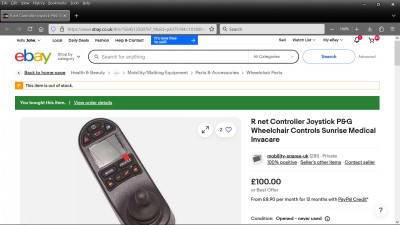

And a simply joystick
https://www.ebay.co.uk/itm/156553463731
But not what you are looking for. But you are in no hurry. Just check daily. If things appear cheap, buy! They very rapidly vanish as people like me grab them fast!

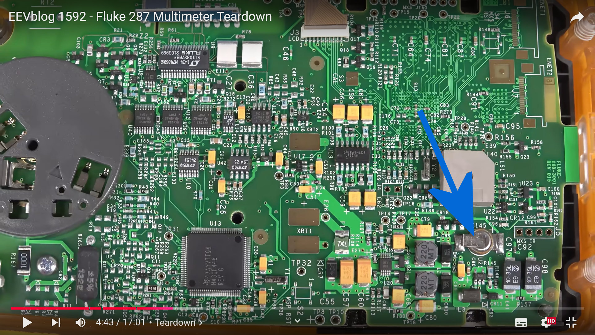

My fluke 289 has a similar issue. Or it did. On its main board theres a tiny supercapacitor. It dies.
All it does here, is hold the time and date while you swap batteries. I have twice sent this in to fluke and they replace with a brand new meter... Every 5 or 6 years a replacement! Lifetime warranty.
See pic. This is MUCH smaller in reality than it appears to be in this image.
Check the PM on your chair for something similar. Its 5.5V. Some are 2.7V. Theres lots available so swapping it shouldnt take more than a few mins.
