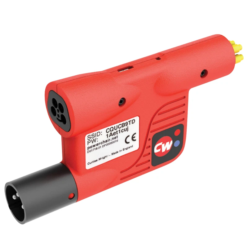

Can vr2,vsi be programmed with PG Drives R-Net dongle? So can I program old version joysticks and drivers?
https://i.ebayimg.com/images/g/nX0AAOSwlTdjRxXZ/s-l1600.webp

No.
Even if you do get an r-net programmer for r-net control systems, dont get that one. Get the PC based one for a few reasons.
What you really want is the PGDT mobility programmer. That needs software that is quite easy to find around here and a special cable that woodyGB can make at a sane price.
