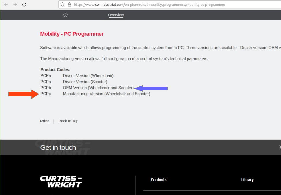

> https://www.cw-industrial.com/en-gb/med ... programmer
Suppose I own a powerchair with VR2.
I manufacture a PC to powerchair cable.
Is the manufacturer's software more complete than the OEM's software?

Postby Burgerman » 18 Jan 2025, 22:41
Not by much. But we have that too.
