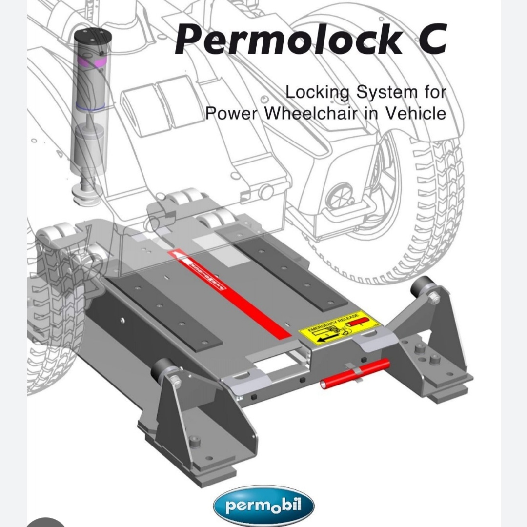

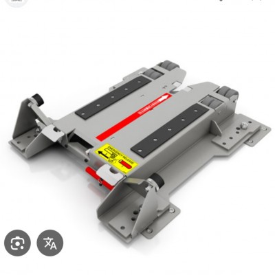

Postby Raro » 04 Feb 2025, 20:25
Does anyone here have a permolock c installed and use a permobil F5 corpus VS chair? I ask because I don't know if they are compatible.

Postby slomobile » 05 Feb 2025, 04:49
I think an F5 would require the Permolock C3 with 2 pins rather than the single center pin. https://www.motusmedical.co.uk/wp-conte ... ock_C3.jpg

Postby Raro » 05 Feb 2025, 11:26
Surely it is as you say slomobile, the permolock c must be for older chairs

Postby scottnj@gmail.com » 06 Feb 2025, 03:20
Unfortunately, Permobil disconnected their locks several years ago. Any of their newer chairs will not be compatible.
