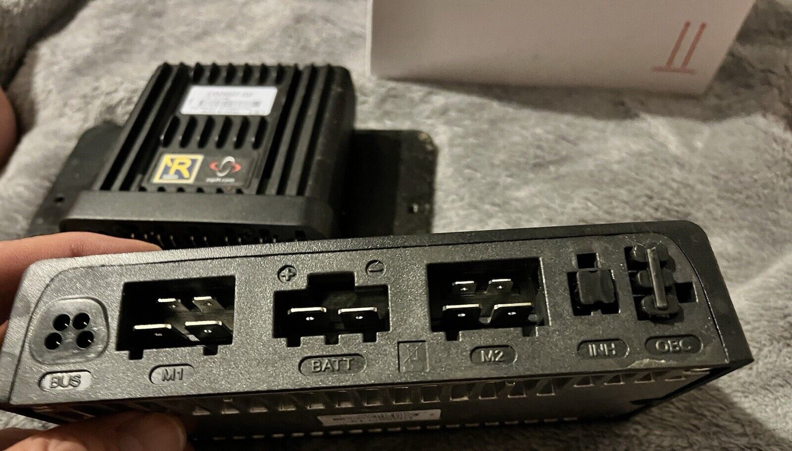

Look at the picture below.
130 total $ DOLLARS. NEW/or UNUSED. Ebay.
For knowledge, if going that route , i need to change the power module wich is the computer at the back of the chair correct?
Does it fit in my chair? would the motors and all the other stuff be able to plug in . Compatibility issues. ( in dont need incline or leg lift)
As far as I know, yes it should all just plug in.
But it WILL need a little knowledge and programming...
THIS is all you need!
If only interested in go. No seating options.
I paid £45 ($55 dollars US) for the Power Module. Thats 120A capable, much better than you have now!
I paid £150 ($190 US) for the CJSM2 brand new joystick.
I paid £15 ($20) for that bus cable.
In fact I bought a LOT of brand new R-Net stuff cheaply!
I bought a low end LED joystick for £45 too. So the COMPLETE system would have cost you £105 or $130 US. But you
MUST BUY RIGHT! Most I see are way overpriced.
And you WILL NEED a R-Net programmer. But you should have one for any chair regardless if you ever hope to be in control.

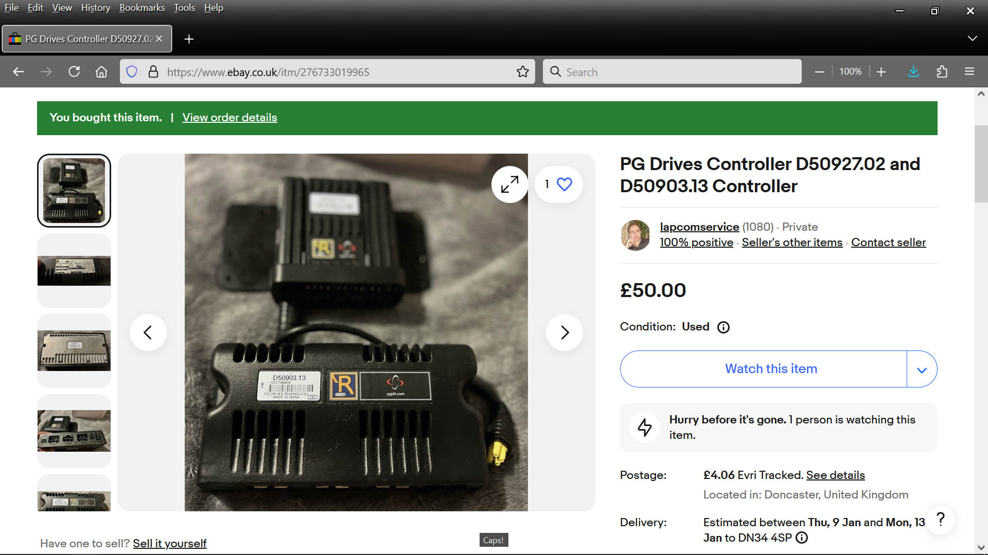

Here is an EXAMPLE of what I just bought on Ebay JUST NOW. While looking because of you... This is more than you need.
I fish ebay for months at a time and only buy pristine or new stuff. CHEAPLY. If the price is too high, wait. I now have 6 sets of R-net complete systems. But when its cheap its good to have spares.
1. £50 (65 US dollars)
For an unmarked 120A R-Net power module. Now I have 4...
A ISM6-L 6 channel seating and lighting module. Now I have 4 of these too!
A bus cable thats worth the £50 alone... I have a box of these.
https://www.ebay.co.uk/itm/276733019965

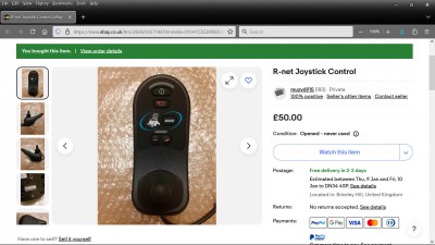

2. A basic LED R-net Joystick BRAND NEW! £50
Brand new i=unused R-net joystick. I have 5 now...
https://www.ebay.co.uk/itm/296929357144
For ONE HUNDRED TOTAL COST, a complete system inc all seating and lighting! All brand new or as good as new. All 4 items, I bought TEN MINUTES AGO!!! Both sellers 100% feedback. Full rehab chair capable system.
Thats everything needed for power drive, powered seating lift, recline, tilt, power footrest angle and length, And lights and one channel left over!
Note, it says I BOUGHT THIS power module, bus cable, and seating and lighting module (all 3) literally 10 mins ago...
Note, it says I BOUGHT THIS JOYSTICK (literally 10 mins ago)
Posts: 71100

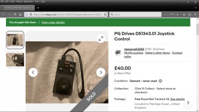

For e.g. I wanted a "attendant" joystick.
I only buy new or at least AS new.
They sell for 135 to 400 pounds on eBay... Crazy to me. But I just check OFTEN and watch carefully in many countries and a huge number of search terms. When one appears that is way too cheap, I dont buy. I make a 50% offer. Or wait until it FINISHES and then do so by contacting seller.
So when one of these appeared yeterday and was NEW for £40 delivered, I offered 20...
And won it super cheap.
Offer
Accepted
Posts: 71100

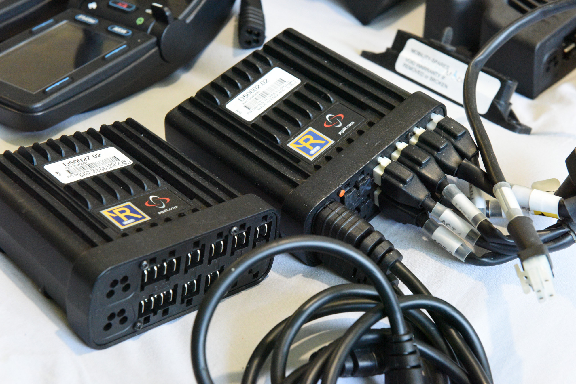

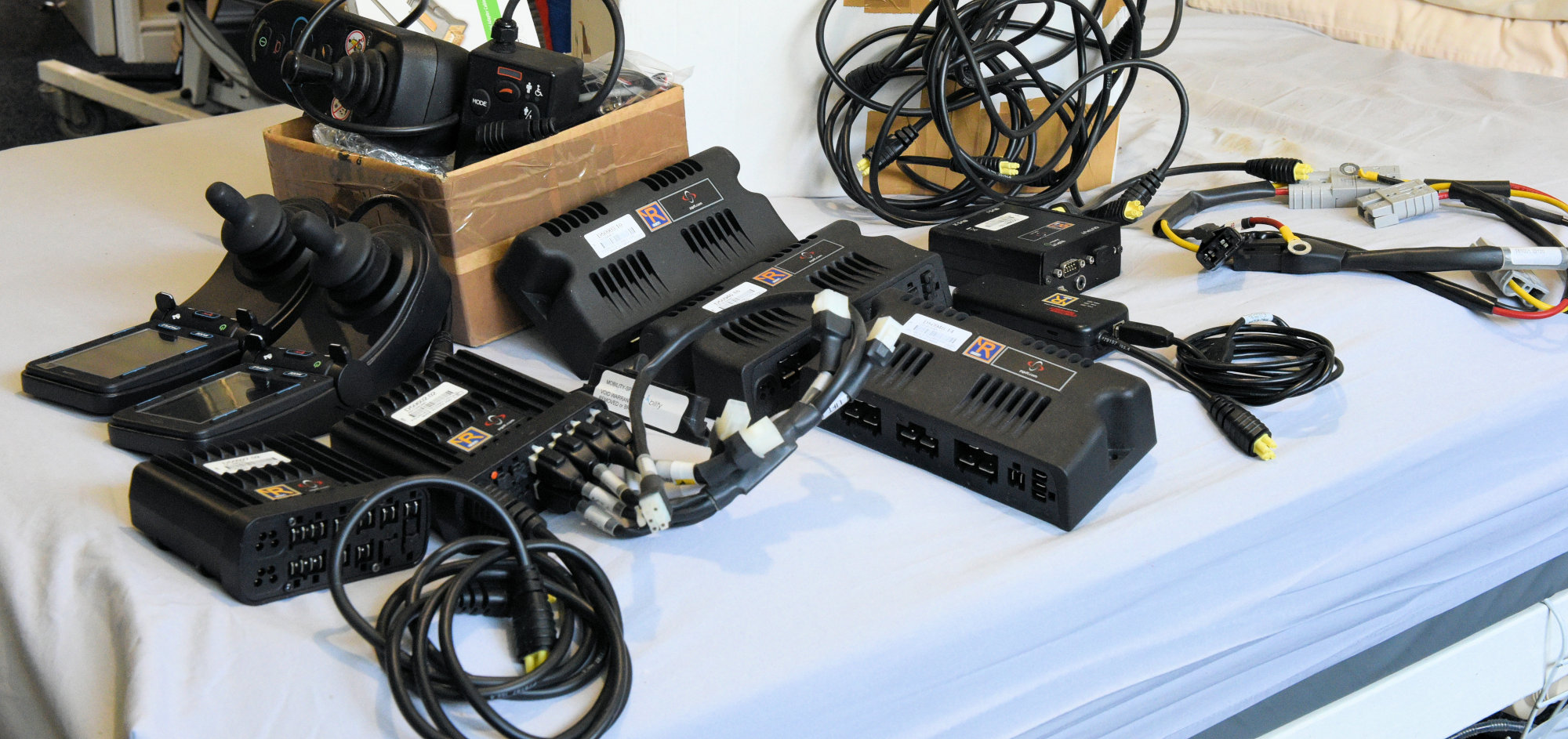

More stuff I already bought silly cheap by learning to "fish" on eBay...
The total price is under £1k for ALL ofthe following combined:
Enough to fully equip 4 complete rehab powerchairs from scratch sat on my shelf!
FOUR of the 120A R-net power modules not new, but they all look it!
THREE of the fancy CJSM2 joysticks. All brand new.
ONE of the CJSM1 joysticks, new.
TWO of the LED joysticks both brand new. One with lights buttons, one without.
FOUR of the ISM6L seating and lighting modules. 2 new, 2 used. Some included full seating looms.
TWO of the multi bus cable blocks.

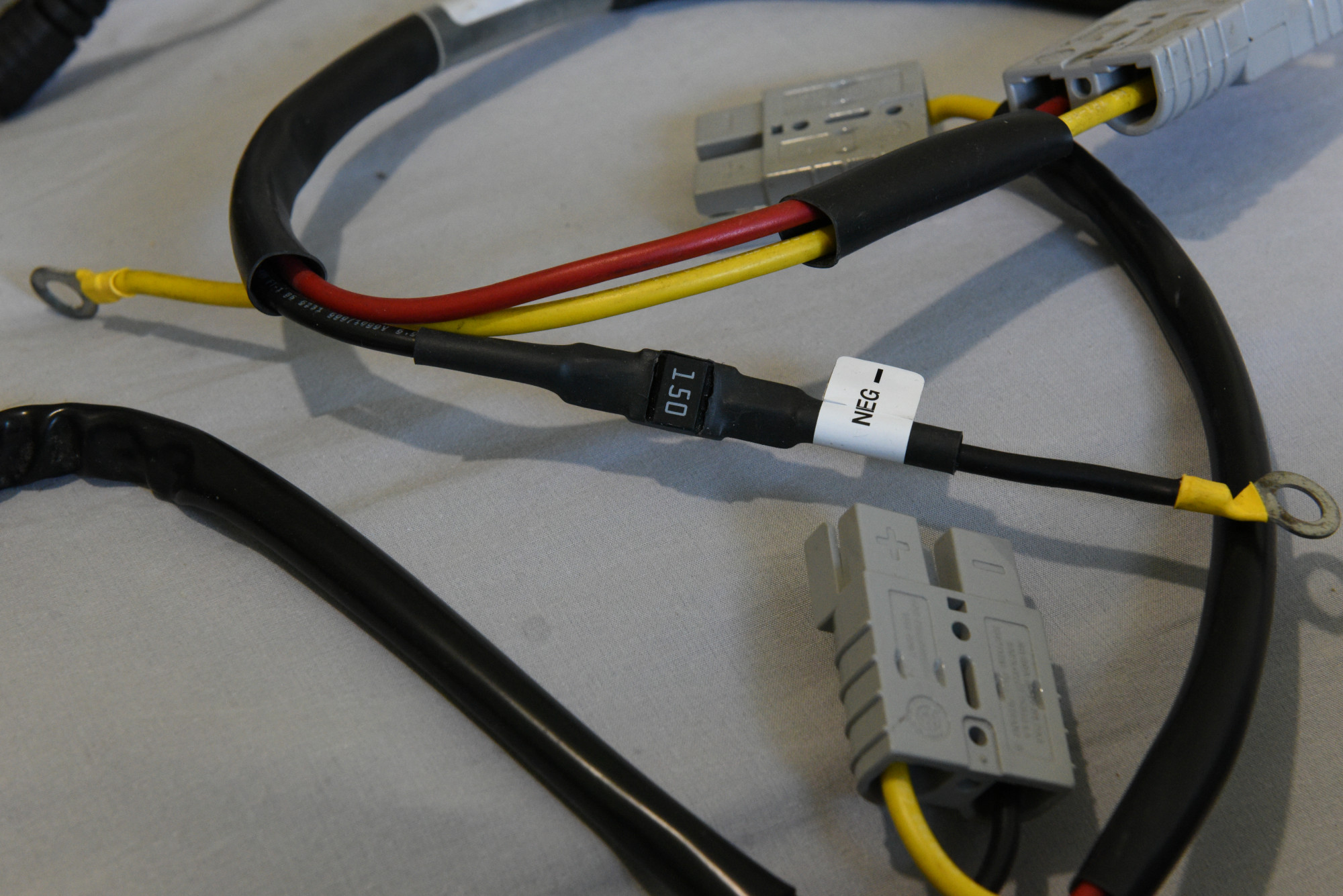

A huge box of battery loom and bus cables of various lengths all tessted and with 150A fuses. All used. But cleaned/exmined and look new.
An attendant R-net Joystick, just bought below:
An IOM module.
An R-net gyro...
This week alone I paid £50 for brand new R-net LED joystick.
And...
And £50 for a R-net 120A power module complete with another R-net ISM6-L seating module, and a "free" bus cable! :shifty:
Posts: 71100

Postby Burgerman » 09 Jan 2025, 12:07
Some of it...
Posts: 71100

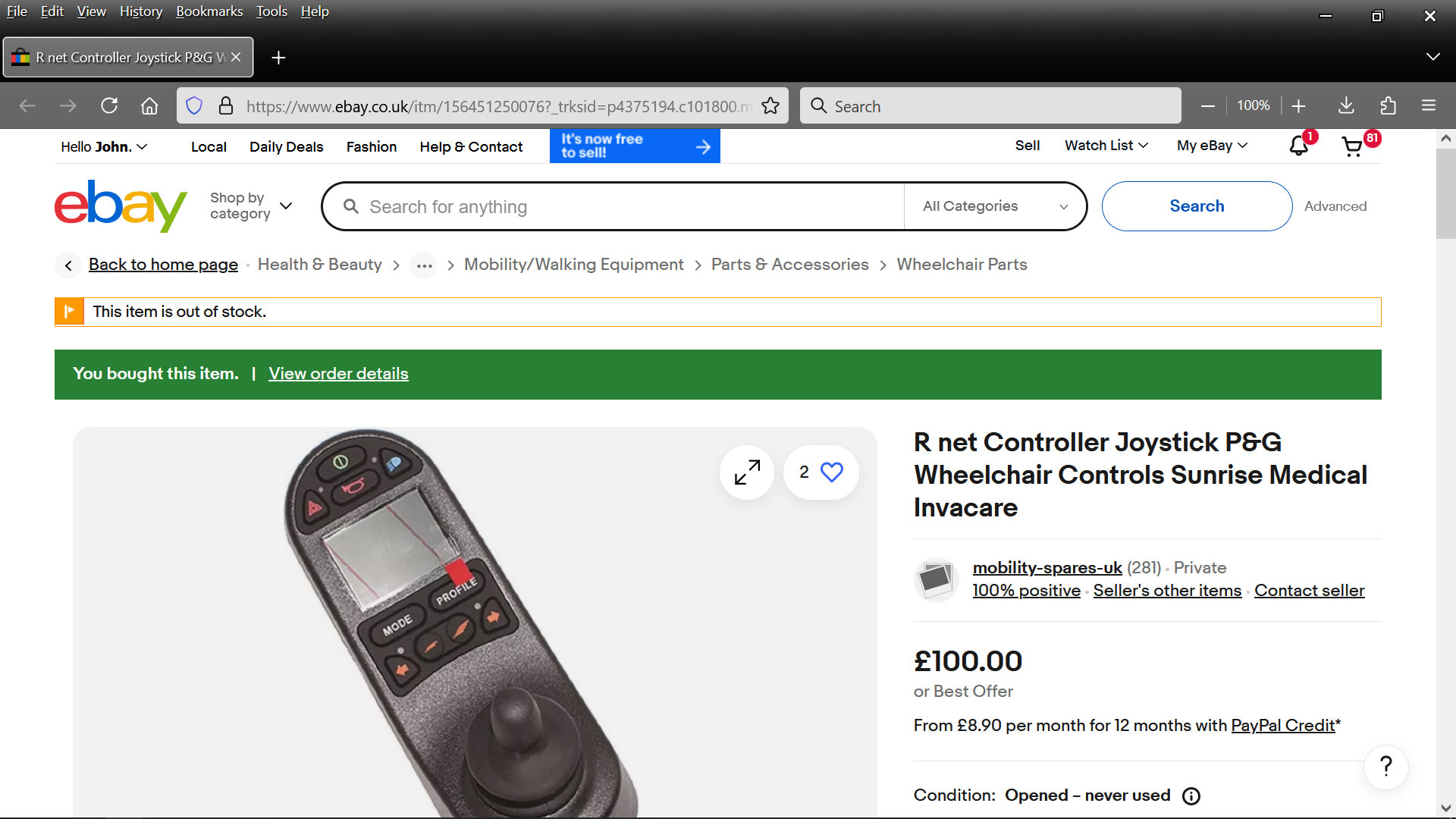

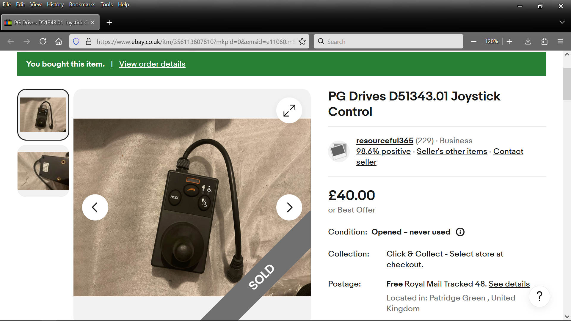

Heres another I won on an £80 offer, brand new a few months ago.
Posts: 71100

So that is an offer is hard to refuse as would vito coleon say. :ak47
So for my quickie 646 se serial number show in opening post , what are the pieces i could ask for that would be most helpfull?
Personnally i feel like getting a backup joystick and probably motors would be the most helpfull since i can not come up to him with 10 items, overwelming him .
What is the number of the j[b]oystick i am using? see pict?[/b]
also for the motors, it might me more difficult since from what i understant there are different CPU modules. I dont know if all motors are compatible with all cpu modules maybe because of connector ? I do not know . What i do know is that the chair serial number of my chair has never had any electric replaced(only the joystick has been resoldered.) What are the motor name number i can ask for that would be compatible?
any other parts I would be wise to ask for?

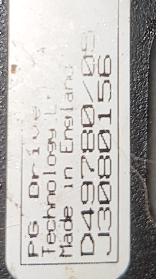

Are power module something that break easily? if not maybe I will try to focus him on looking for qtronix joystick .
The person needs part number . so here is a pict of my 2 qtronix stick (at bottom)
PG Drive technology
D49780 /09
J3080156
PG Drive technology
D49779 /06
J7050301
Is there a way to have all the numbers corresponding to the qtronix Joystick?
I imagine there are more than 2 ..
yeshelp
Posts: 382
Joined: 11 Jan 2021, 14:56
Location: canada quebec
Re: How to dertermine wich joystick can fit on my quickie 64
Postby Burgerman » 23 Feb 2025, 02:37
No he doesent need a part number.
ANY Qtronix or Pilot plus joystick, and any redel cable will work. Thousands of different numbers!
