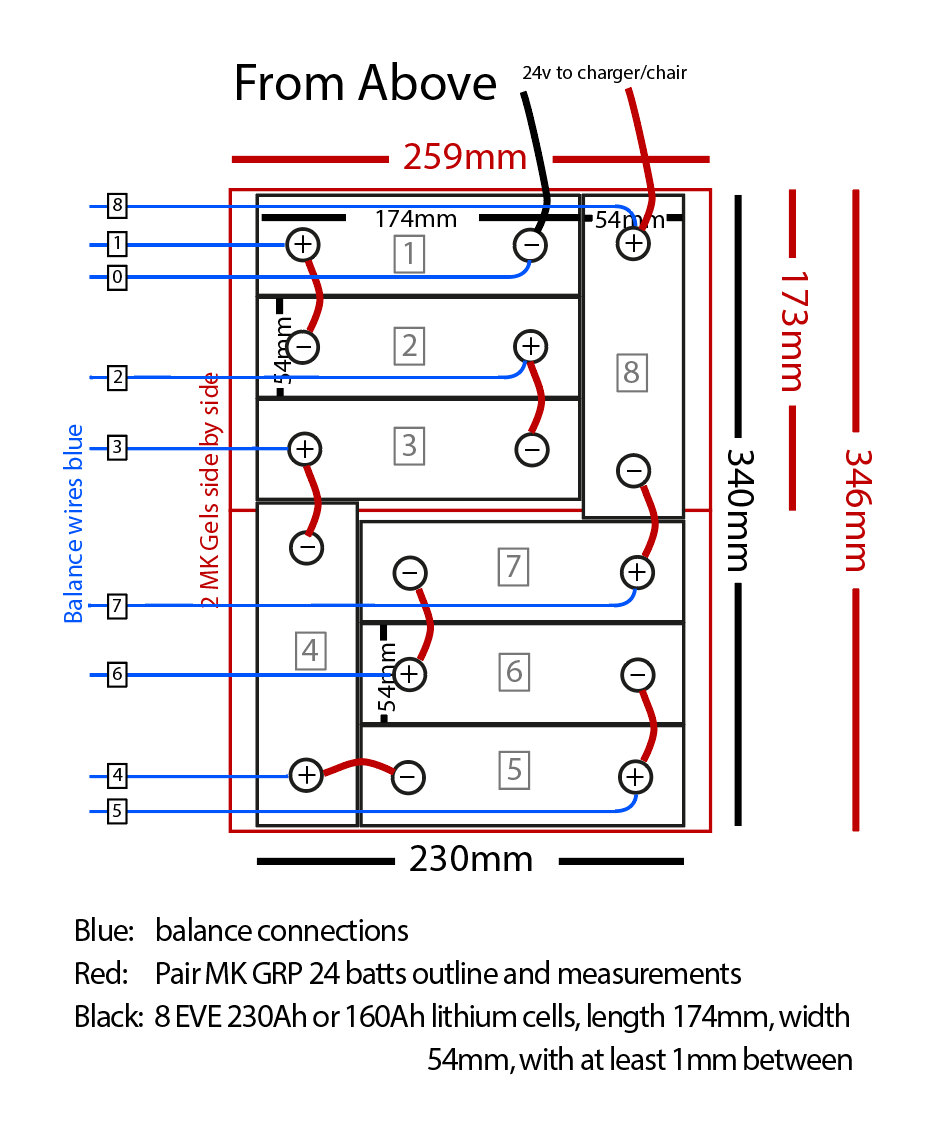

Postby Burgerman » 06 Feb 2025, 00:46
GRP 24 ones, your chair has 2.
They take up this space, shown here with 230Ah cells x 8.
260 long, 170 wide, 220 tall. Permobils are problematic with height and the terminals aparently, I dont have one, and so as shown here the shorter height 160Ah cells must be used instead. Amy? Dont know.
For drop in bricks, you need 2x 12 or 24v grp24 sized ones. And measure first, twice, before ordering anything... :clap
But its not he only thing to look at. You need to be able to take up to 240A peak, for a couple of seconds too or the bms those things use will chop off power... Like a switch.

Re: Amylior R3
Postby Burgerman » 06 Feb 2025, 09:09
One wont fit. Or it will waste half the space. Battery area is almost square. 340 x 259mm. As drawing.
You need TWO 24v, or TWO 12v.
