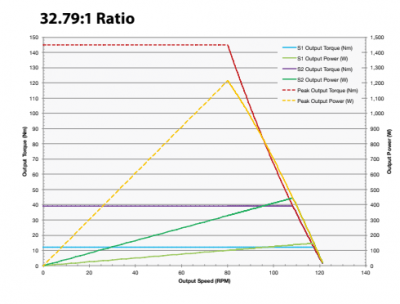

Peak Current (5 sec) (Amps) 65.0
Peak Power (5 sec) (Watts) 714
S1 Current (Continuous) (Amps) 15.0
S1 Power (Continuous) (Watts) 253
Seems a long way short!

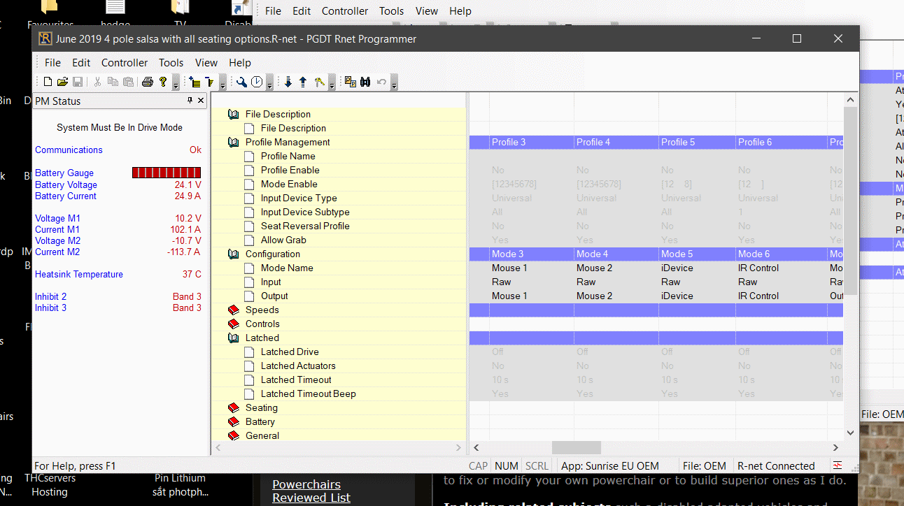

Postby Burgerman » 29 Jun 2025, 18:27
Heres my 4 pole 6mph SALSA chair.
I tied a turn in place in my hallway on thick carpet.
Take a look at the 2 MOTOR CURRENTS. M1 and M2.
And voltages M1 and M2 voltages neded to create this current...
Then take a look at the total BATTERY current.
(A real time screenshot of the data during a turn displayed by R-Net.
Can you tell me why the total battery load Amps, is far far less (24.9A) than even a single motor current? Which is 102A + 115A.
(Look at the motor volts and the battery voltage.)
See if you can understand that? And then explain it to me.
And again, as a side note, that you need 120A controller here on a 6mph chair! So even MORE Amps would be drawn on a taller geared (or higher RPM wound) chair motor. This is why an 8mph motor isnt much good. Low torque... hanged
Look at the BATTERY CURRENT.
Look at each motor current.
Tell my why.
Its important that you understand this as its fundamental to your project and to your choices of motor and controller spec, programming, pulsewidth etc inc battery specs, etc.
Can you tell me why this situation REVERSES as you speed up? Because at speed the motor current is much lower than the battery current.

Are you referring to the back EMF generated by the spinning motor? As RPM ramps, the motor becomes a generator that opposes the input current. Was there something specific you think I need to know? Any guidance to chose motor size and gearing for the load? Or defining our load?
No! I mentioned it only because it helps explain what I was trying to tell you. But apparently I wasted my time!
Answer me this question.
Do you know why it is that the battery current can be a quarter or less than the motor current? Or the same. Depending on RPMs?

Burgerman wrote:Answer me this question.
I'm not sure. I would guess it is due to PWM. Every on cycle has a very brief part at the beginning before the coil EM field is up where there are only resistive wire loads. There is brief large inrush current. At low PWM duty cycle, that inrush represents a larger proportion of the total on time.
I'm not very confident in that answer at all. I've seen you post this information before as a question, but never seen you give the answer. So what is it? You aren't wasting your time, I just haven't learned that lesson in a way that makes intuitive sense yet.

Postby Burgerman » 14 Jul 2025, 14:25
The answer is FUNDAMENTAL and very important that you grasp this.
And thats exactly what the long post that you didnt understand above tries to explained. I cant re-rite it. Read above slowly and ask questions.
It explains for e.g, once you grasp it, why the post above that says that hammer motor is HIGH SPEED and HIGH TORQUE is nonsense!

Here I was going to look at the 24v MPP36 configured with 32.79:1 gear ratio to calculate what the PWM% and top speed would be for both 24v and 48v batteries. But ran into a snag which you already pointed out. While writing this next part I fell into wrong assumptions. I don't think its right because it never even uses the coil resistance or inductance, but I don't know the actual right way. Welcome corrections to what follows if it can be salvaged. I guess I really am still missing some fundamentals.
First, peak current is listed at 100A. So 120A Rnet is already exceeding the motor spec. 150A RoboteQ is 150% of spec. 1214Wpeak * 150% = 1821W which is the new peak power we will aim for at the higher voltage. 1214W 100A is what you get at 100%PWM at 24Vbatt. Our corresponding operating point on the chart is 1821W 50%PWM at 48Vbatt. So if I use 16s LFP battery at 58.4V our 24v PWM averaged equivalent is at 41.14% duty cycle. 24 is 41.14% of 58.4. We never operate above that duty cycle with these motors and batteries.
Typical 4, 6, 8mph labels are not included with these spec sheets so we need to extrapolate. For a 14" wheel
4mph = 96 wheel RPM
6mph = 144 wheel RPM
8mph = 192 wheel RPM
For this high torque low speed motor/gearbox selection, 122RPM no load top speed on a 14" diameter tire is 5.08 miles per hour at 24V.
Peak torque of 144.89Nm falls off above 80RPM which is 3.33mph(5.36km/h). This is a 4mph class motor.
With the 24v MPP36 configured with 32.79:1 gear ratio 122RPM top speed will have peak starting torque of 144.89Nm
Gear Ratio 32.79:1
Operating Voltage (VDC) 24
No Load Speed (RPM) 122
Peak Torque (Nm) 144.89
Peak Current (Amps) 100
Peak Power (Watts)) 1214
S2 Torque (15 min) (Nm) 39.20
S2 Current (15 min) (Amps) 30.0
S2 Power (15 min) (Watts) 445
S1 Torque (Continuous) (Nm) 12.03
S1 Current (Continuous) (Amps) 12.0
S1 Power (Continuous) (Watts) 148
Torque Constant (Nm/A) 0.0568
Voltage Constant (V/KRPM) 5.95
Motor Inertia (Armature) (kg.mm²) 1129.23
Motor Winding Resistance (Ohms) 0.3
Motor Winding Inductance ( H) 73
Motor Max Winding Temp (ºC) 155
Motor Poles 4
Motor Mass (kg) 7.17 (MPP36)
