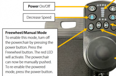

I have just bought a new Scooterpac Atom Power Chair and can't find out how to put the brakes in manual mode so I can push the chair by hand. Can anyone help?

Postby Dan » 07 Aug 2025, 16:25
Freewheel/Manual Mode
To enable this mode, turn off
the powerchair by pressing the
power button. Press the
Freewheel button. The red LED
will activate. The powerchair
can now be manually pushed.
To re-enable the powered
mode, press the power button.
Screenshot 2025-08-07 at 16-24-28 Screenshot 2025-08-07 at 16-23-56 Screenshot 2025-08-07 at 16-23-29 png (PNG Image 935 × 616 pixels).png (PNG Image 984 × 648 pixels).png (PNG Image 766 × 504 pixels).png
