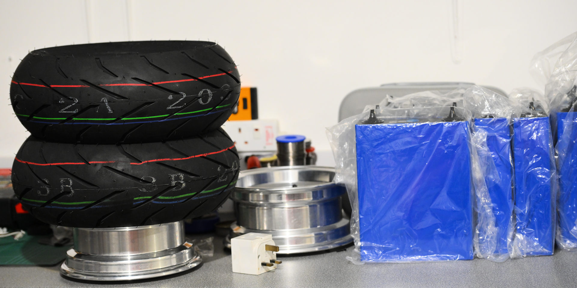

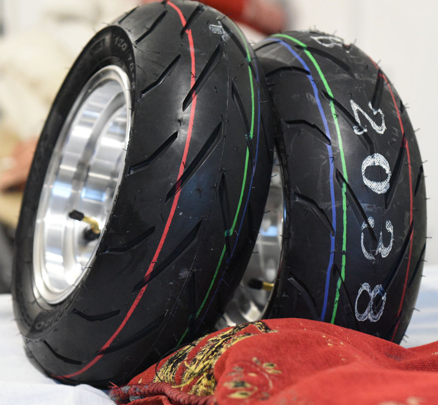

The SALSA chair has adapters that allow me to fit 3.5J x 8 alloy rims. And tubeless 120/70-8 Duro Kitaco tubeless tyres.
The Q700 R is basically the same I made a flat "ring" of metal (actually I ordered it to my specs online to be laser cut). It was driled and tapped with a hand drill for the new wheel. And it was drilled AND COUNTERSUNK for some countersunk allen screws to bolt the adapter to the chairs hub.
That only works with the wider 3.5J rims though at least easily. The Q700 has not got tubeless rims. I wasnt going to keep it as I dont like it.
MY spacers are made from several thinner parts. Because the laser cutter guy said he couldnt cut the thickness I needED. So look carefully! Theres 2 halves, bolted together. Theres countersunk plain holes for the countersunk bolts to fit the adapters. Theres threaded holes for the rims to bolt on.
Theres a smaller "ring" that bolts on, to centralise the wheel while I fit the bolts... Theres a thin alloy plate, as a cover plate. I changed that to stainless and removed the 2 holes... Not needed as the load spread washers that hold the wheel on also hold that on...
Dont ask for measurements as its fitted to a chair! And I cant get to it!
Chair
Rim...
120/70-8 Duro Kitaco tyres. These cost and are worth the money...
Tyres rims not fitted.
Spacers adapters

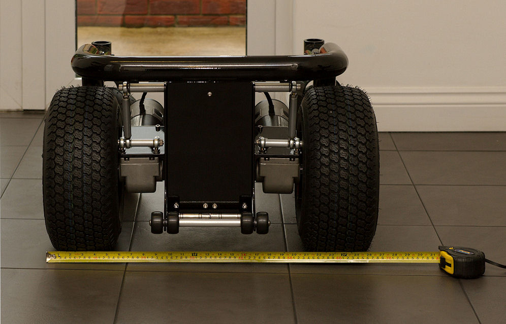

This chair has 6 inch wide tyres. Actually a little more. (15"x6.00"-6" tubeless) It has big fat puncture resistant kevlar reinforced "K-Shield" tubeless tyres. Thats over a foot of rubber. So it can run at a very low pressure like 5 to 7 psi and so a nicer ride.
And its still only 27 inch wide. So you are not really trying! :D
Scroll down to the tape measure...
https://www.wheelchairdriver.com/BM-MK3 ... rchair.htm

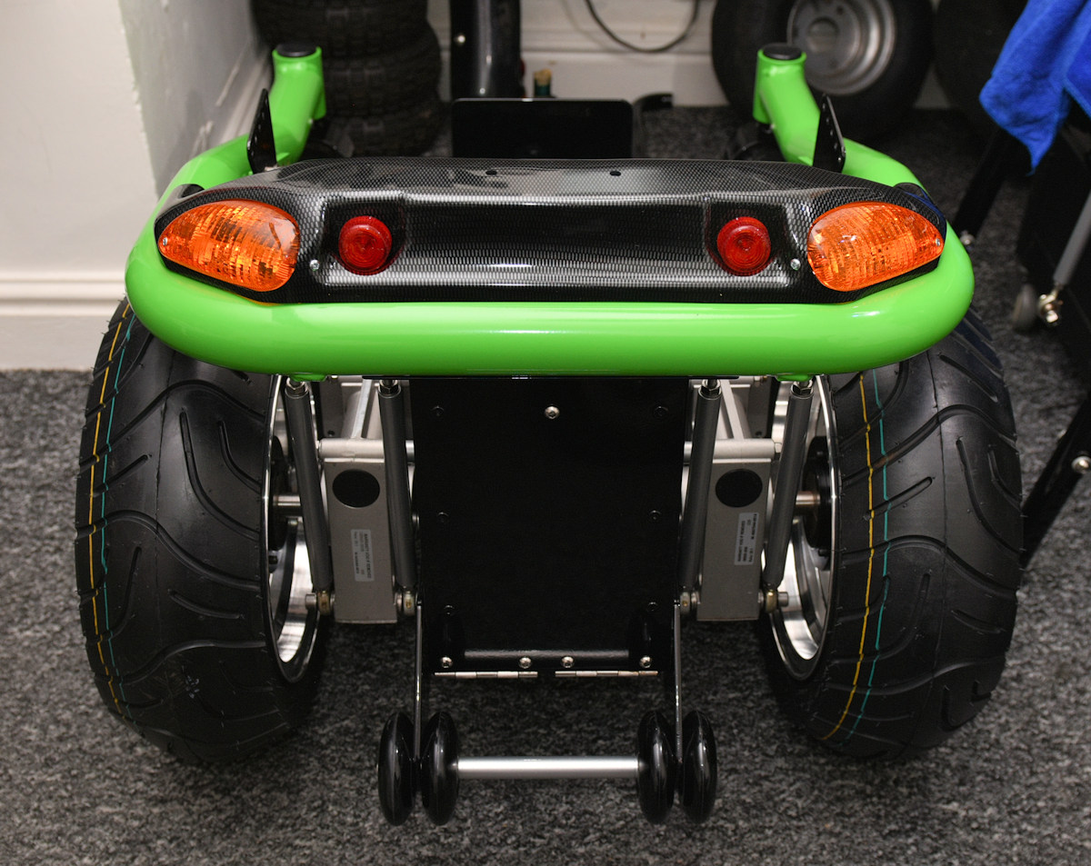

This one has 130/60 tyres on larger rims.
Thats 5 inches of rubber each side, same chair otherwise. So now even with super low profile fat tyres, its 25 inches wide.
https://www.wheelchairdriver.com/board/ ... &start=270
