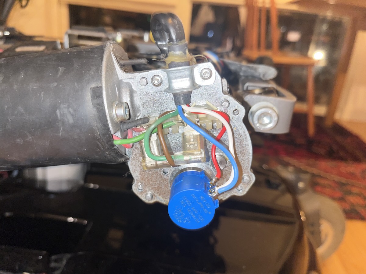

Thanks. I couldn't find a microswitch other than the main one in the middle under the seat under the big plastic plate (which was removed long ago due to the switch being activated when it shouldn't).
The chair will drive now when one of the plugs to the standing actuator is unplugged (with red, white and blue wires), but of course it won't change position then. With the cover off I can see where the wires go, but not sure how that part works.
Someone said the 2G VS has a metering rod next to the actuator to get position feedback, so maybe something in that small round blue device needs to be replaced.

Postby Burgerman » 03 Aug 2025, 00:12
Permobils have twice as many wires as other chairs. So no idea what the blue thing is or what it connects to. But you may be right.
Take apart and see what it is/does. Might be obvious then.

Re: C500 standing actuator maybe

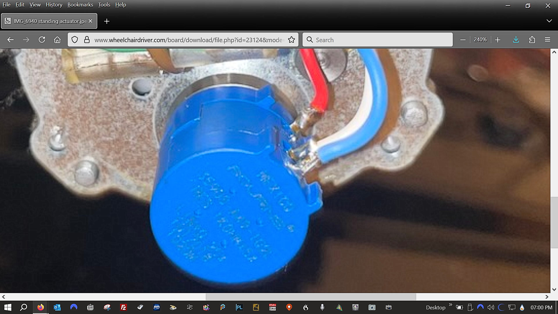

Postby DSmidgit » 06 Aug 2025, 13:59
That blue thing is a potentiometer. It is used to measure the length of the actuator. If that isn't working correctly it could be giving errors. I have not seen one of these that where faulty but I don't have a permobil.

Postby Burgerman » 06 Aug 2025, 19:07
I am not sure that it is.
The wires are in the wrong place, should be radially positioned on a pot. And its too deep. And the size of those wires is the same as the current carrying ones to the motor. And a pot normally has say 10k or 500k written on it too. That soldering is abysmal. Well not the fact that its soldered badly but it should have heat shrink.
Its obviously doing something. Maybe a type of microswitch, or something. Take it apart! Only way to know.

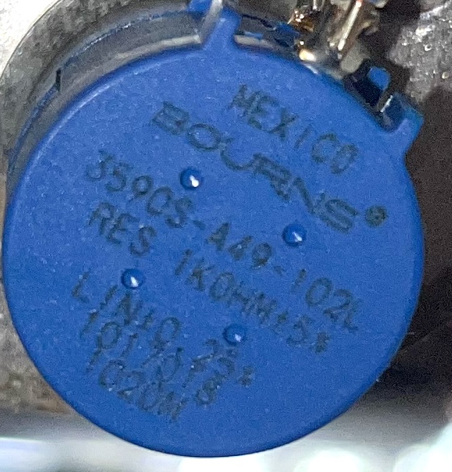

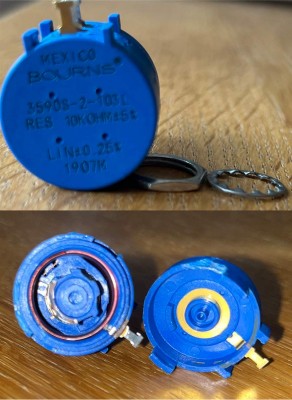

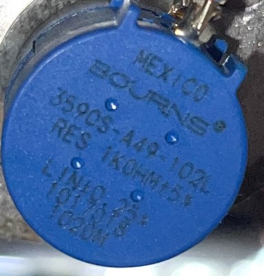

I ordered a replacement on ebay but didn't get around to doing anything for a while. I re-checked and found the old one is a 1K and the one I ordered was a 10K.
I wasn't sure how to open or where to drill so took the 10k one apart.
Seemed to snap back on fine so tried it on the one still on the chair.
Was able to open it, but it didn't snap back on like the other one so put some gaffer tape across it for now.
Sprayed contact cleaner on it twice, let it dry, then tried plugging everything in again. Chair still doesn't move with everything plugged in. But it will go into standing mode and move while standing. When it comes back down (most of the way, but the seat is still elevated) it doesn't move. Unplugged, it moves again.
Text was hard to read in old photo.
MEXICO
BOURNS
3590S-A49-102L
RES 1KOHM +/- 5%
LIN +/- 0.25%
1017018
1020M
Took end cap off (think some plastic tab might have broken)
sprayed contact cleaner inside
taped end cap back on
Text on wrong replacement
MEXICO
BOURNS
3590S-2-103L
RES 10KOHM +/- 5%
LIN +/- 0.25%
1907M

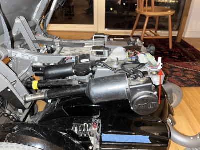

We tried to set the turns to the same place (almost all the way open when in standing position). Put everything back together again, soldered the blue white and red wires back on and nothing has changed. Still has the same symptoms. If the standing actuator is unplugged the chair will move. If it's plugged in, it will stand, and it will move while standing, but about 25% down from standing, the first light on the ICS buttons turns red and it will no longer move. And the joystick only goes between M1 and recline.
Inside the actuator. Photo missing the creme coloured gear wheel which sits next to the black gear wheel.
I was able to use the Permobil "Take me down" mode (press and hold buttons 2 and 6 while off, turn on and hold for 30 seconds until all lights red) to get the chair to lower from the partly elevated mode which is at the end of the lower of the standing mode.
Take me down mode works to elevate or lower (very slowly) when the standing actuator is unplugged, so the chair can currently be used as a backup if someone is around to plug or unplug if I need to stand.
