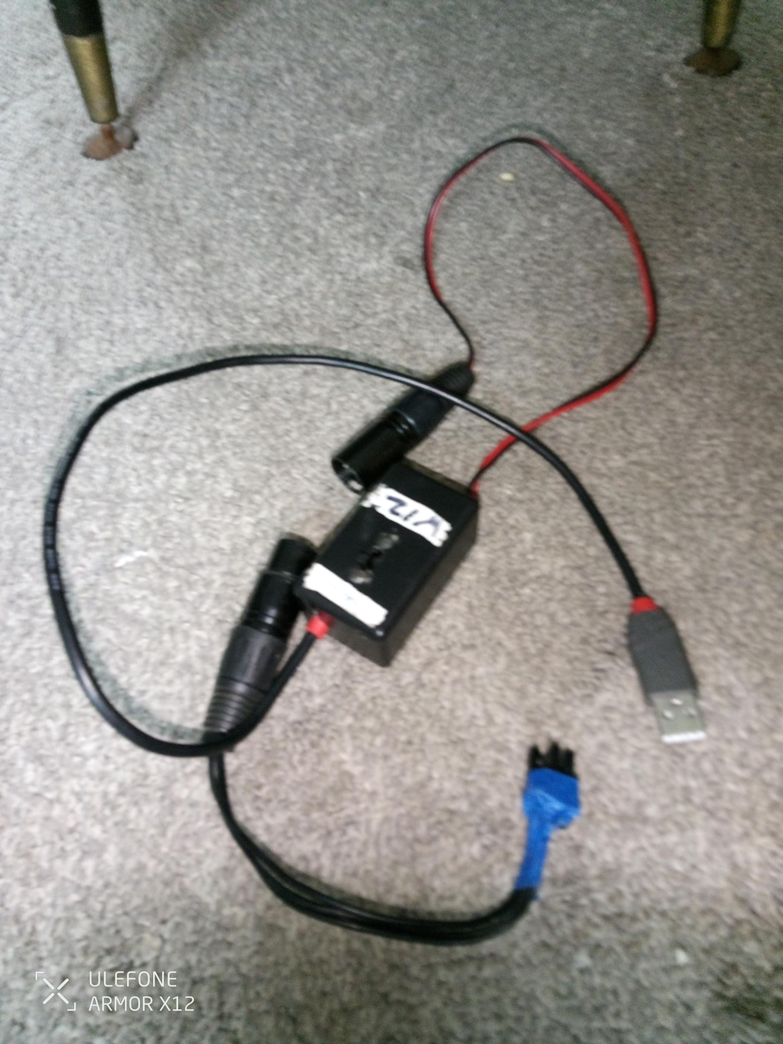

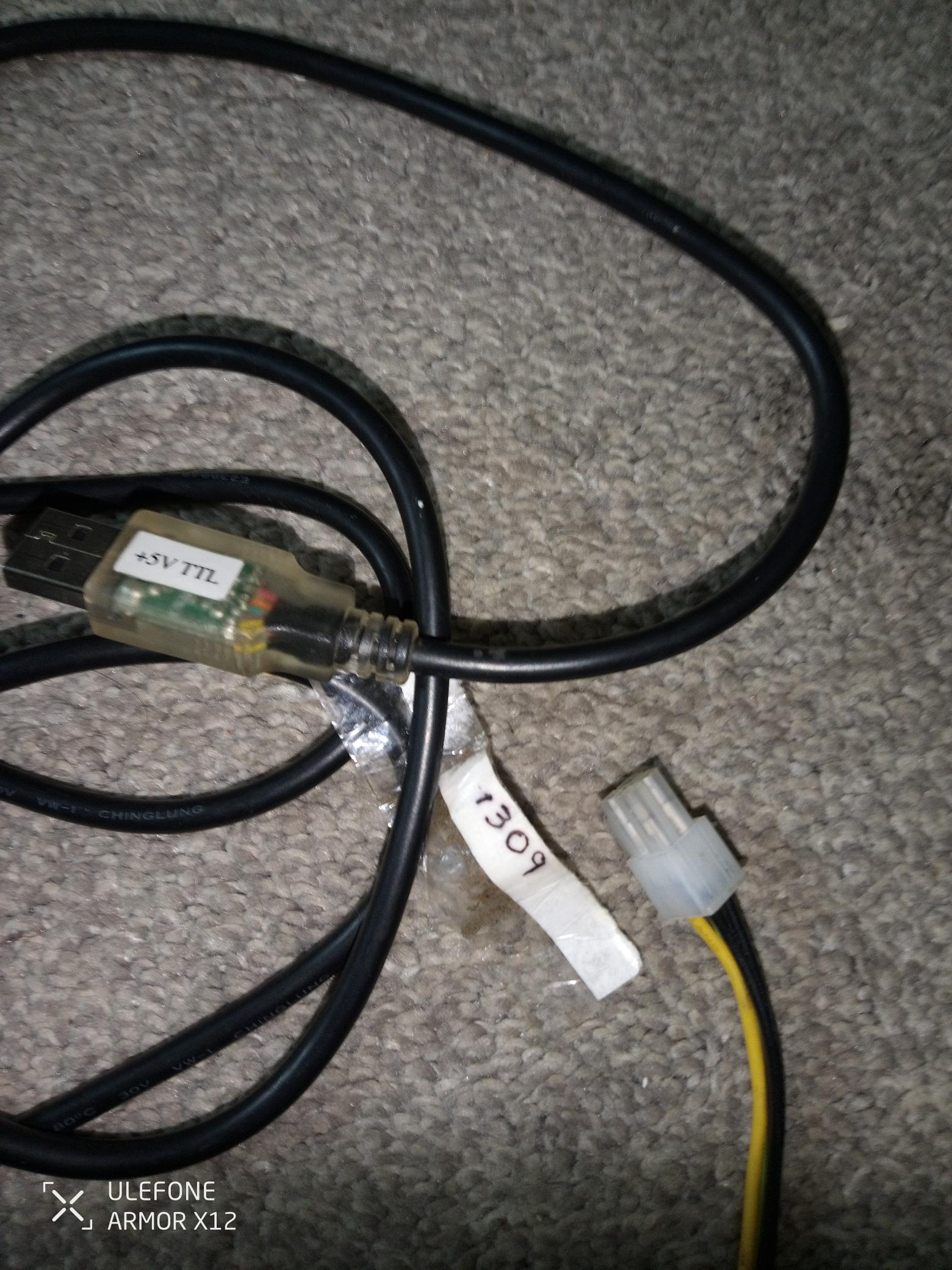

I have changed laptops recently and reinstalled the software for the various systems I use across the range of power chairs and mobility scooters and whilst mobility programmer and wizard are working fine (with their respective switch box cable someone kindly provided attached pic) I cant get the software to work that I have previously used (for curtis programmers when I used the attached cable labeled 1309 and this particular chair invacare TDX SP") Its on windows 10.
Also, I am not sure if I lost a cable when my van was broken into as the 4 pin connector obviously wont fit the socket on the wheelchair, but I know I have managed to programme this chair before as I slowed down the turn speed for the user.

I hope someone can help as you all have been very helpful before which has enabled me to help many customers. I have another cable question but I will ask that seperatley (as I know I need a new cable for connecting to the original purple dynamic rhino controller with the round connector as this was stolen in the break in).
