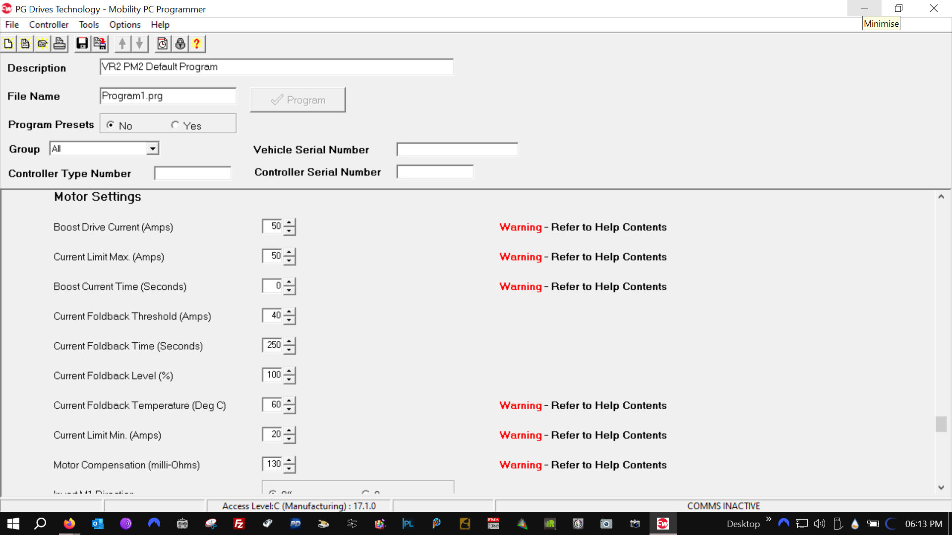

I need to get a clamp meter to measure how may amps my Q300R with 4 pole motors draw on a 90amp unit. Low curbs of 3 cms and the motors stall which drives me crazy. I’m using VR2 90amp. And the chair moves slower and lazy on grass or thick carpet. Why is that? I mean, it does NOT stall on grass but the control unit reduces power I Guess because of the high amps that the motors draw. Can it be changed with programming to NOT reduce power when riding on grass or similar??

The controllers can only provide full current if impedance is low enough or the motor is not turning (stall current) and if load compensation and torque setting is high enough to do so.
The actual amps at the motor depends on all those things. As a chair moves from 0mph to say 3 mph on a 6 mph chair its motor which is a generator too, is now PRODUCING 12V... So now, even if there was no controller in between battery and motor it wouldnt draw that many Amps anyway as you are only applying half the 24V battery voltage. Thats 12V more than the motor is already making on its own So the faster you move the less current is pulled from the battery regardless.
The controller itself has some internal logic that does many things.
It reduces max current over a time limit. This can be 1 second, 3 seconds, 10 seconds...
It reduces max current due to the mosfet temperatre internally. This may begin happening at say 45C and it increases over time/temperature in seconds or minutes depending on history / current boost limits etc.
As a motor internal windings warm up as current increases those too increase in resistance and now draw less current too.
Since most of these settings are at a lower level than any programmer has access to, may vary with firmware versions etc we cant really know how its configured behind the sccenes.
There are a FEW settings that we can CAN change. This is for NEW VR2.
BOOST DRIVE CURRENT - can be set too low? Set to 90 which is max!
CURRENT LIMIT - can be set too low? This is the max current AFTER BOOST ENDS! Set to 80 Max.
BOOST CURRENT TIME - can be set too low? 1 to 10 secs I think on VR2, set to max! But this will heat it up...
BOOST CURRENT FOLDBACK - can be set too low... This is where it goes after the boost ends.
CURRENT FOLDBACK TIME - Set too low?? This is where the 80A normal leve you set above goes when its out of time.
CURRENT FOLDBACK LEVEL - same shit... This is where it drops to when its done its 80A bit.
CURRENT FOLDBACK TEMPERATURE? This is independent of the above, and reduces max current available due to mosfet internal temperature that happens fast under high currents.
CURRENT LIMIT MINIMUM? Dont know what that does???
COMPENSATION? This if set low will absolutely limit current available in ALL scenarios... Like most chairs.
Not sure a current clamp meter will tell you much.
Posts: 71100
Re: torque Values
Postby Burgerman » 24 Jan 2026, 19:29
Remember that the more you increase the settings that allow power/torque the faster it heats up and the faster the temp rollback happens.
The real answer is a 120A controller. Same happens but it has higher output before it gets rolled back.
