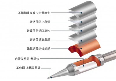

The genuine tips are great. WELL shaped, well tined, heavily plated, and very accurate temperature control and calibration.
The cheap and cheerful tips, are a very mixed bag. SOME seem quite good. Most are either way too hot, dont keep temperature accurately, and are badly shaped and less precise. And some are harder to tin or keep tinned over a few uses.
So I suggest you take the ones it comes with and use them for odd occasion when you need that shape. And buy a larger 4.5 or 5mm genuine one in a hoof or chisel shape for most larger stuff.
