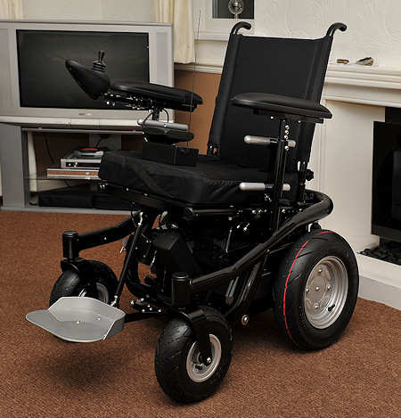

Because if you can find someone with a few skills its trivial to make what you are looking for and can buy from other non US places where theres loads of rear drives available to look at - used. Or even new depending on budget. They dont cost telephone numbers here. Or the EU. You can buy even new ones online and get a good discount too.
You see this wreck???
This is the result of a couple of years landing from 4 inch curbs, use and abuse.
The rear motor mounts are bent... The tyres are not meant to be slicks on either end!
The front casters are also bent "sideways" from landing about a million wheelies badly.
Every time a chair gets to look like this they are basically knackered. So I totally strip. Then throw away motors, all bearing, all bolts, tyres, possibly wheels, upholstery and arms. I then ether replace or repair any bent or worn parts that are left.
Then I send those main frame parts off to the powder coater.
Buy new rims, tyres, (off road?) eBay but new Joystick or any electrical parts. New bolts in stainless, new axles, bearngs, etc. Then new upholstery, probably different to what it had before. And motors of choice.
When reassembled with CARE and every part better than stock and refurbed, powder coated it *is* a new chair only better than any you could by.
That typically costs about 1000 UK pounds, + any old junker.

After that got tired and abused, it was stripped, rebuilt all over. As the one below...
Same chair ended up as this one too!
It started off as a red one in 97. I am still using it. Its literally as new today. 29 YEARS and about 6 total rebuilds, later.
I originally paid 500 for it. Used! I had another purple one that ended up as the BM2 in the same way. All cheaply. With NEW motors, loom, bolts, spacers, axles, wheels, tyres, control systems, joysticks, upholstery and batts every time. And the rest just blasted/powder coated etc.
Now its green.
