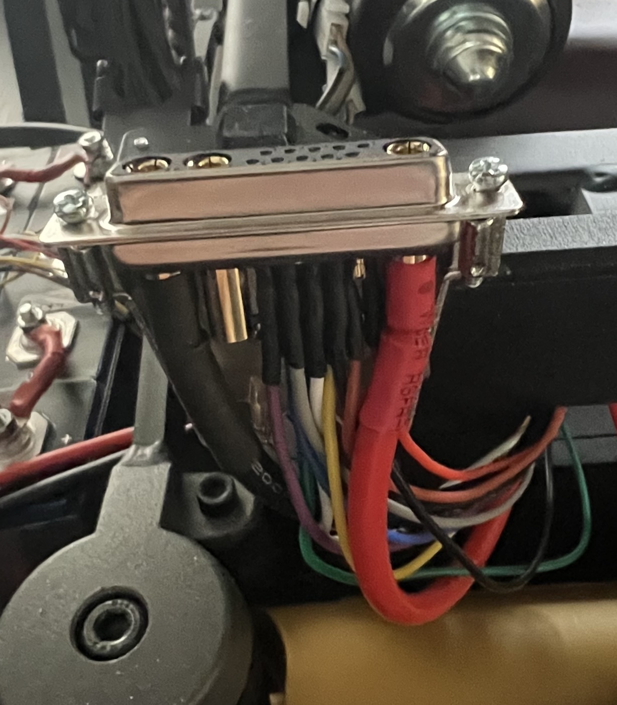

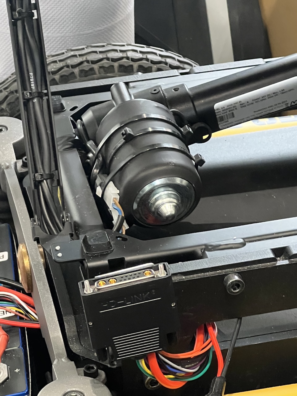

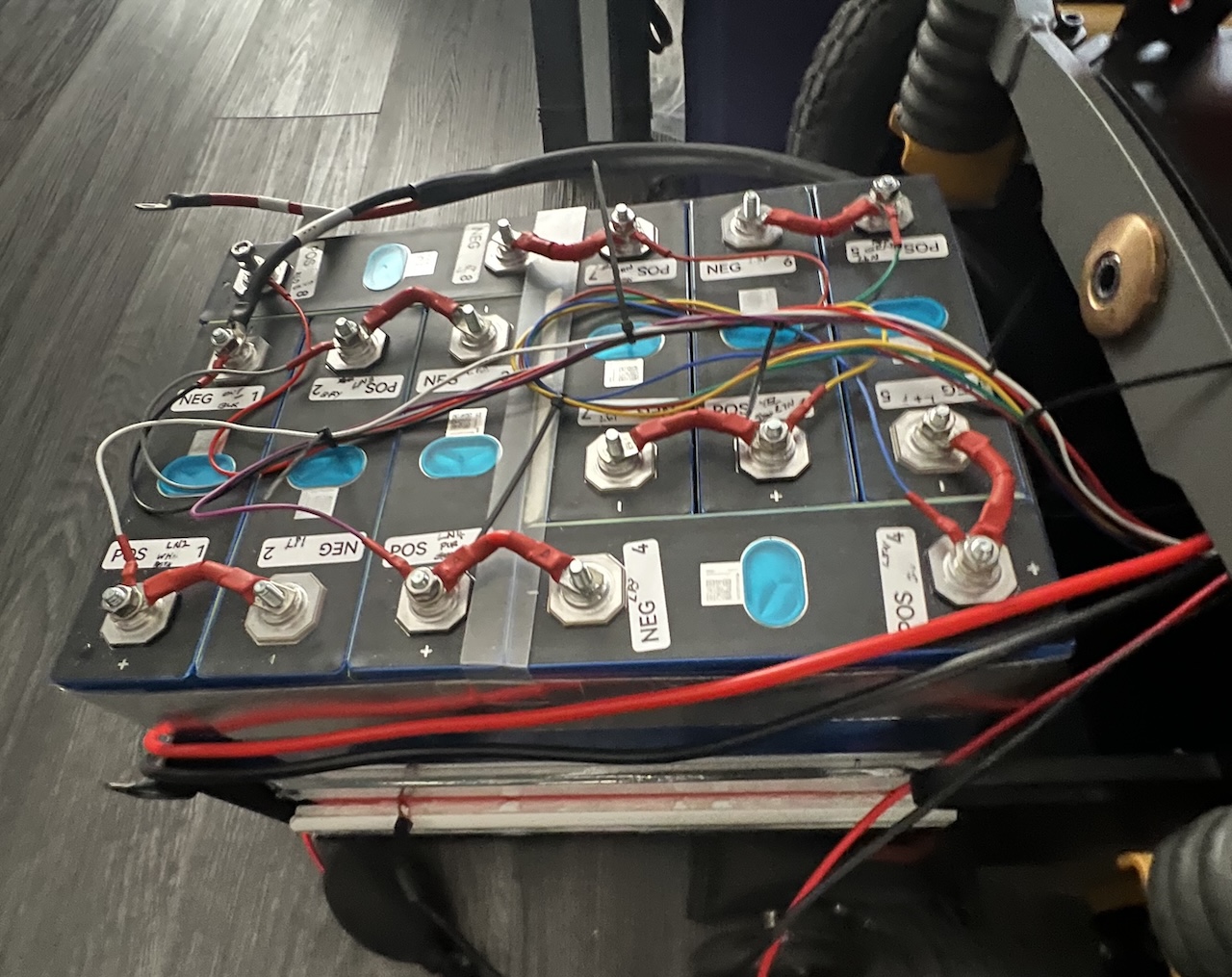

We are progressing with the 230Ah battery build and I have a couple of questions please.

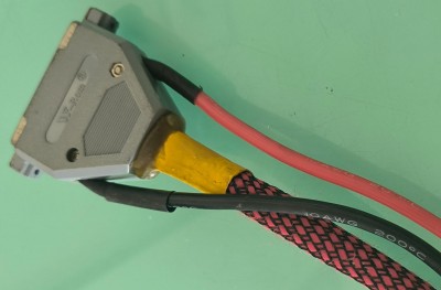

we have cable tied the balance cables, is this a problem heat wise, we need to be very careful we do not catch any wires when we slide the pack into the powerchair their is not a lot of room, The other question the charging connector we're having the problem that the covers/shell covers are small can some one give me a part number that accommodates all the balance and charging cables on the DB25 Connector please.
a couple of photos, Any advice appreciated.
Mark

Simply enlarge the opening with tools in hand.
Balance wires won't get hot at all.

Thanks for the replies we used 10 gauge, thats are problem.

Yes. So you are a bit screwed. Change wires or dont bother with a backshell or modify the shell. Only choices. Use 12 gauge for the charger end cable.
Tappe a bit of plastic sheet above all the terminals for when you fit the battery to prevent sparks...

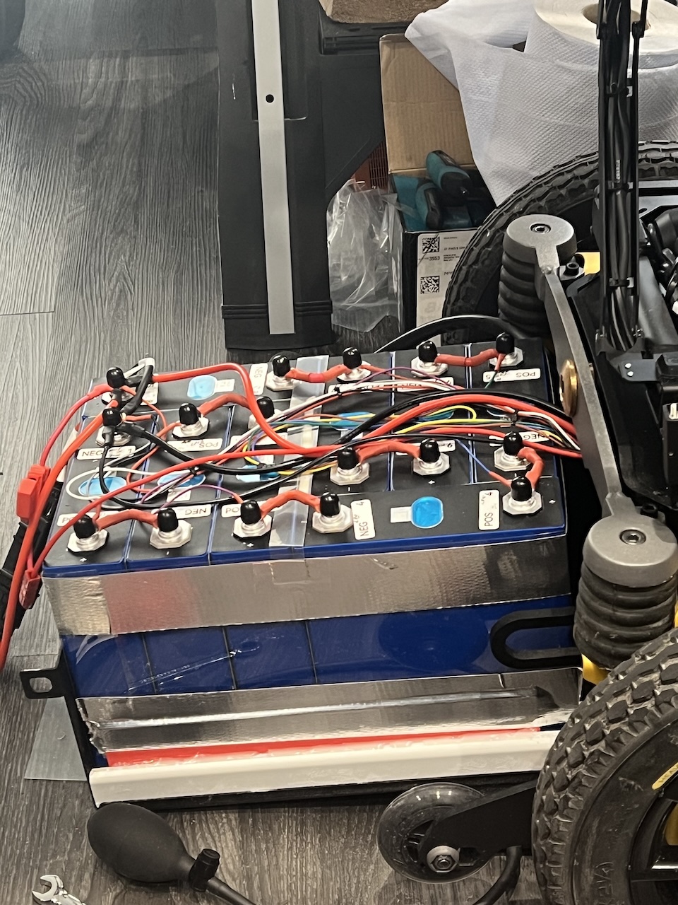

Yep, we have some nut caps to go on, we tried to follow the instructions on the forums, but there is a lot of information to read, I've tried to take everything onboard, like crimping and soldering and the order of attaching the wires to the battery terminals, etc. If the gauge of the wire is the only mistake i've made I will be very a happy man! other mistakes could be very costly, not doing any install today, hopefully we will complete the install tomorrow.

Plastic shell is as good, and is easier to enlarge or even add cutouts.

Postby sparkerted » 21 Feb 2026, 17:58
Yes shirley, we did get a plastic shell that works.
Well slid the battery tray in and all good, have been using the Powerchair last night and this morning.
I'm grateful for everybody's contributions to these forums that have made this LifePo4 install possible thank you.

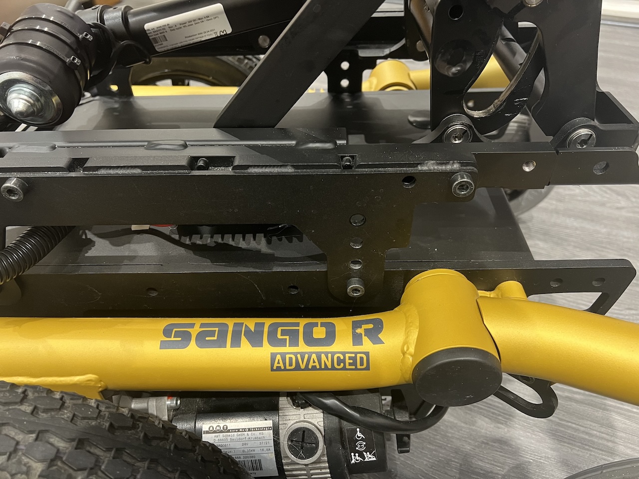

Next thing to do is try and move the seat back, I have found this am I heading in the right direction? thanks.

Actually I think I have found it, this is what is applicable to my chair

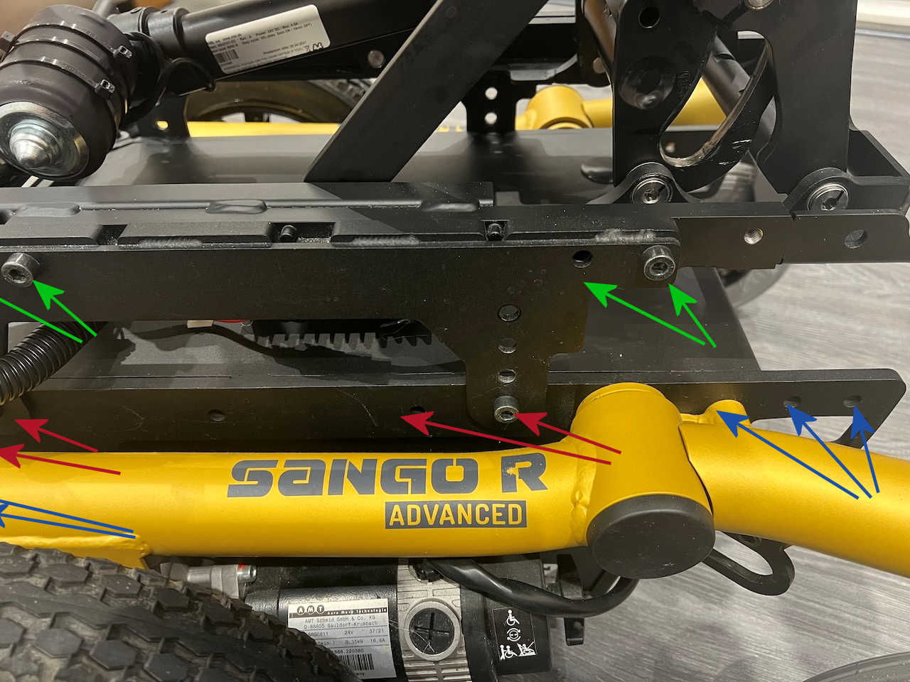

Re: Batrey build 230Ah
Postby Burgerman » 23 Feb 2026, 02:09

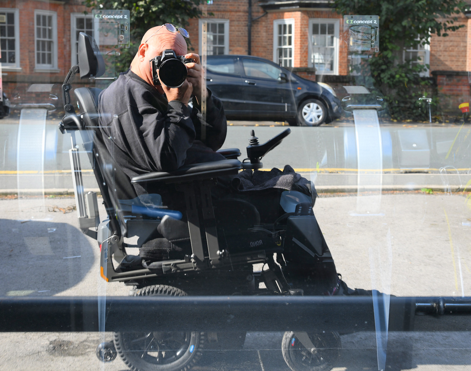

On that diagram there are C and D bolts. I had to move both. The top ones were moved to new holes. The bottom ones allow about 2.5 inches rearwards at once.
The result is that you can move the seat back a lot!
Heres my reflection in the only mirror I coud see. A shop...
And while at it I added 4 spacers under the seat. Because I like to sit with around 5 degrees or so of "dump" angle. Now you CAN just tilt the seat back. But thats wobbly and feels like you are mounted of rubber. It not solid enough and will damage the actuator long term. I even saw a crcked seat frame. Expresso in new york.
So I added from memory some 18mm diameter alloy spacer. 8mm hole, and around 20mm at the back. And around 50mm at the front. The seat is FULLY DOWN in this reflection in a shop window.
And the drive wheel is under my backside. If anything its a little too tippy.
I used 2 "lift off" single post arm uprights per side in order to stop the arms being wobbly... The lift up ones are weak. The signgle post ones are better but can be improved. Programming was dismal. Also fixed.

Postby sparkerted » 24 Feb 2026, 23:52
BM Shirley thank you.
Not sure I can move it any further back

Postby Burgerman » 25 Feb 2026, 02:08

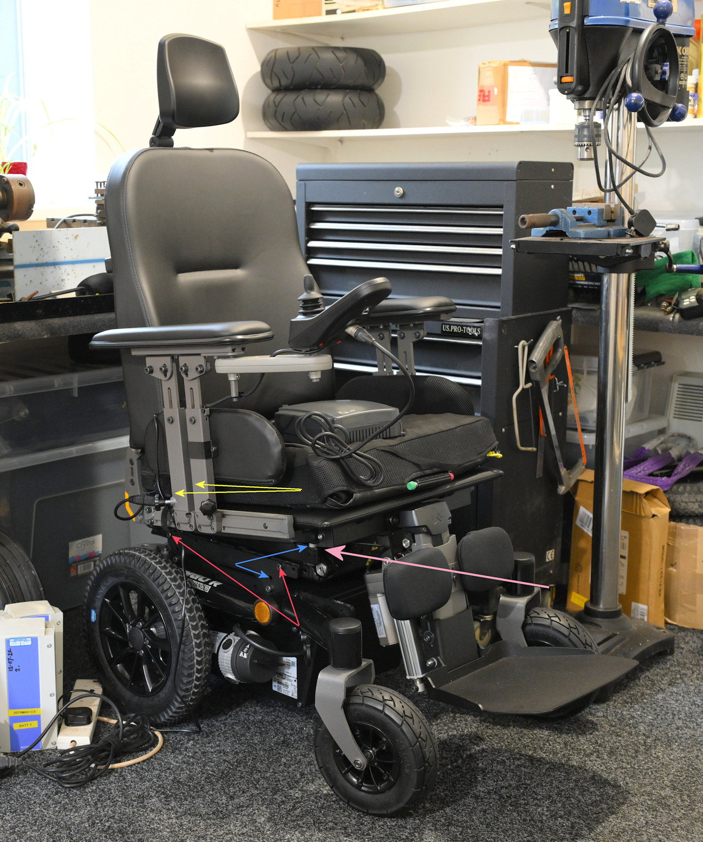

Your picture cuts off the rear. But I see 3 ways on the base, and then theres the mounting bolts under the seat too.
Here are the bolts you need to remove and to move the seat...
If you look closely you can see I moved the seat back a lot. And you can JUST see the end of a seat dump spacer UNDER the seat to add "dump" when tilt fully lowered.
On my chair, RED and BLUE bolts allow seat to go back. PINK arrow points at a 45 or 50mm spacer.
And the yellow arrow points at doubled up arms for strength.

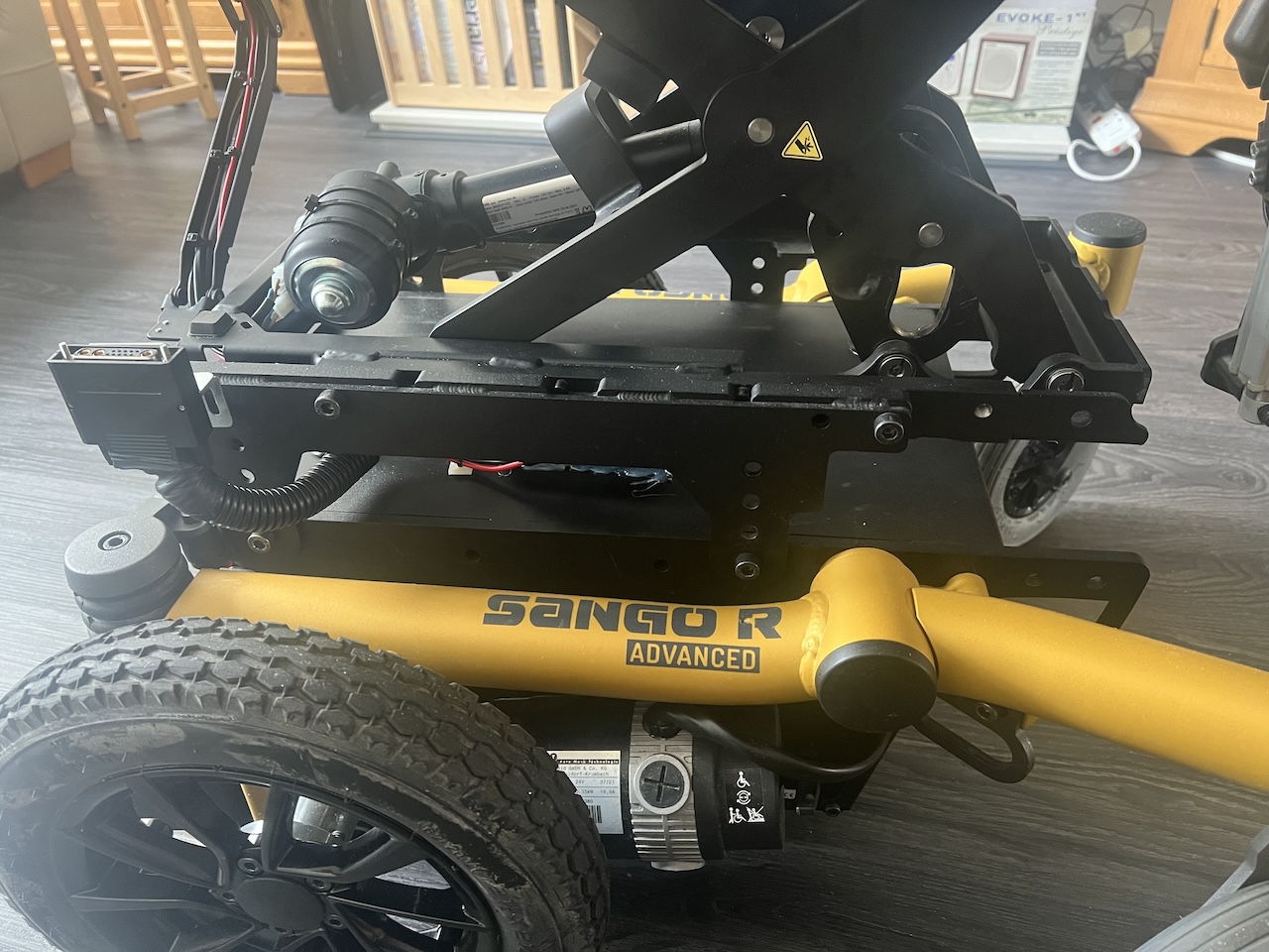

Postby sparkerted » 01 Mar 2026, 12:49
Hi BM
Were going to revisit the seat on Tuesday afternoon to see what the challenges are, I assume you need some type of lifting gear to support/help move the seat to the rear?
updated photo,
Thanks Mark

Postby Burgerman » 01 Mar 2026, 19:17
My lifting gear was called "martin"...
Martin is a carer/personal assistant type.
But yes it was actually quite easy. But the seat dump spacers was very fiddly and frustrating to get right 3rd go! :fencing
This gives better idea of seat position. I may have gone a bit too far as its very tippy now. I dont mind - some might. I reverse up anything steep now. Or... :thumbdown:

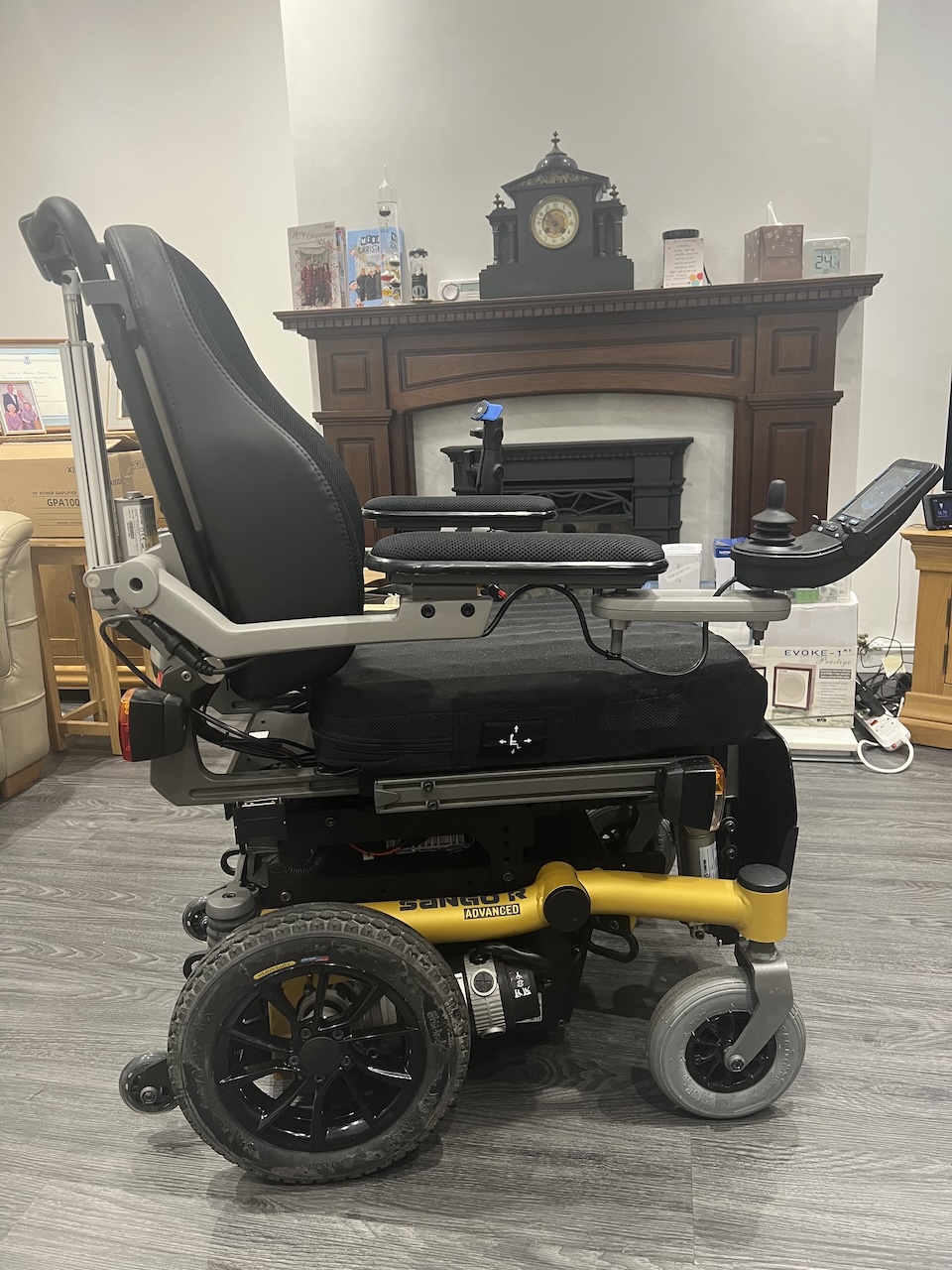

My problem at the moment is very nose heavy, I put a set of Pneumatic tyres on it, as soon as I go out in it I'm loosing tyre pressure due to potholes on roads and pavements turning becomes more difficult due to loss of air pressure, pneumatic tyres make for a much more comfortable rides, I have put the solid caster wheels back on. Thanks for the comments above, i did add anti-tip wheels to the rear as it didn't have any

Postby shirley_hkg » 02 Mar 2026, 13:22
Post a side shot of WHOLE chair, so we could guess the CG.

Postby sparkerted » 02 Mar 2026, 23:16
I believe it was purchased originally for a short lady, so chair was set up for her, It had legrests and I changed it to a centre mount electric footrest, really heavy, so have raised seat, moved back rest as far back as possible, hence seat is next to be moved. BM I have your R-Net settings on my chair. (I have a dongle). i'm probably sat just above the front edge of the rear wheel looking at photo tyres will look into that, they are caster wheels/tyres from Sango dietz. I think there is significant weight on the front of the chair.

Postby sparkerted » 03 Mar 2026, 22:44
So moving the chair seat to the rear was easier than we thought, we tried the dump and its not for me, put the pneumatic caster wheels/tyres back on and all seems good, moving the CG back seems to have solved my problems. BM/Shirley thank you.
