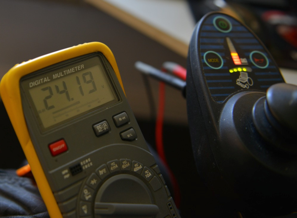

when discharging at exactly 25A. Unfortunately for us a chair stops and gives a red flashing at some point around 22.5 to 23V. So we dont get to use it all!
So in reality you dont get that full 135 minutes. Maybe 90 to 100 mins at 25A. It doesent matter a lot it still allows DIRECT battery to battery comparison under load.
So other batteries with worse internal resistance fall to this point faster. You dont go for as long... It isnt about Ah like a fuel tank with lead, but about how many Ah are ACCESSIBLE at any given load. That 25A figure equates to a heavy rehab 6.2 or 8 mph chair rolling at full speed quite well. We get around 14 to 15 miles before the battery dies, in general which is 2 hours (120 mins) at full speed on most heavy chairs.

The chair stops before that battery reaches the reserve capacity figures 10.5V (21V) point.
You get about 2 more blocks when you see this!

So I MEASURED 244Ah from the EVE Lithium 230Ah cells down to 24V. (2.7 X 8 cells). Thats 21.6V.
Lets still call it 135 mins for lead, and punish the lithium. It wont care. Because lithium suffers zero peukert capacity at a "tiny" 25A load, and gives the full 244Ah regardless. So how long will that run at 25A? Well thats easy, 244 div by 25A! Its exactly 9.76 hours. Thats 9 and three quarter hours. Or 585 minutes. Or 4.334x longer.
Except its not quite right because instead of the chair stopping at some point near 22V the lithium keeps going a bit longer as its voltage is a bit higher even here - it can get more discharged before the chair dies on you... So will add extra range. But we will ignore that here.
