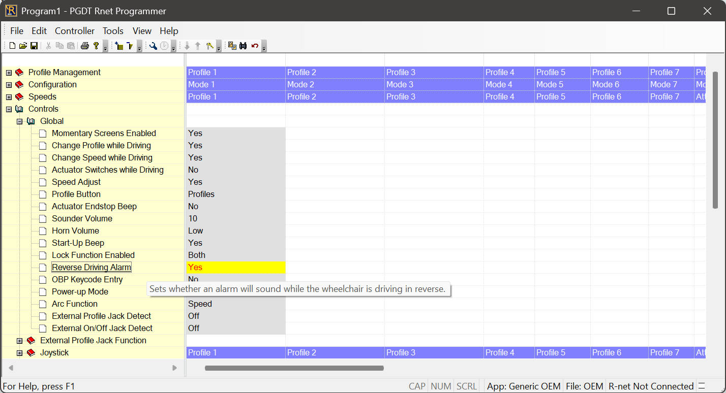

I am interested in the lidar, but more for reversing, while i can use my head and shoulders i can't always see what is behind me, and I don't know how many times I have started to reverse and some zombie walks straight behind me, I do afterall live in zombieland, otherwise known as the armpit of the universe or scarborough to everyone else, yes I know people just walk infromnt and behind you, but they seem to do it twice as much here, I was wondering if it was a viable alternative to ultrasonic detectors

I think a reversing cam is what you need.
In programming you can also add a reversing beep.
