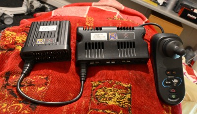

This is better than what you need.
Note what I paid.
This is a:
SEATING and LIGHTING module.
A 120A POWER MODULE (so 50% extra power for curbs etc)
2 BUS CABLES included.
Thats a full chairs system for 100.
You need to be patient and fish eBay carefully. Takes time. ALL as new or actually new (dont buy used joysticks).
The only thing thats not plug and play here is that you *will* need a programmer that can do OEM level charges. Or know someone that has one or a dealer that will lend you one. Or make a cable and PM me for the software.

Or...
I offered 80 and accepted. Not 100. New. Also works with above...
