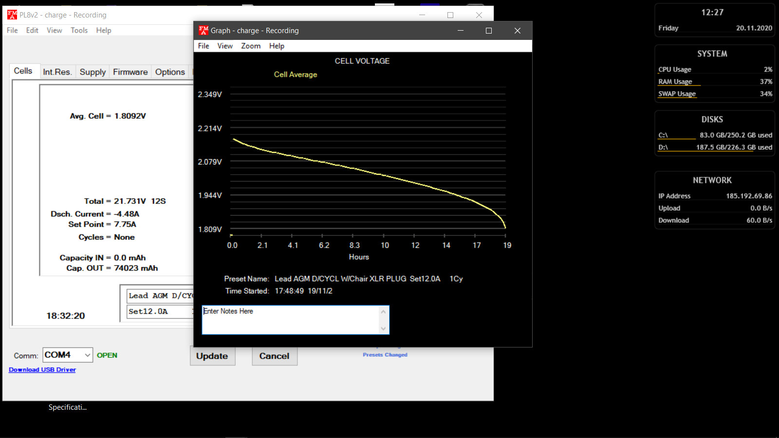

How do you KNOW if they are any good once charged? You MEASURE them.
Personally I use the hobby charger, PL8 to MEASURE the Ah out. That takes 20 hours, and has to be carefully measured. Temperature, discharge rate, and a way to automatically stop the discharge at the correct voltage point. The hobby charger does all that for me.
Here is what that LOOKS like.
FIRST correct CHARGE.
SECOND you MEASURE capacity over the 20 hours during a slow discharge and then see how many Ah you got back in Mah on the graph/in text on the left.
Here I got 74Ah back, when testing a set of healthy MKs...

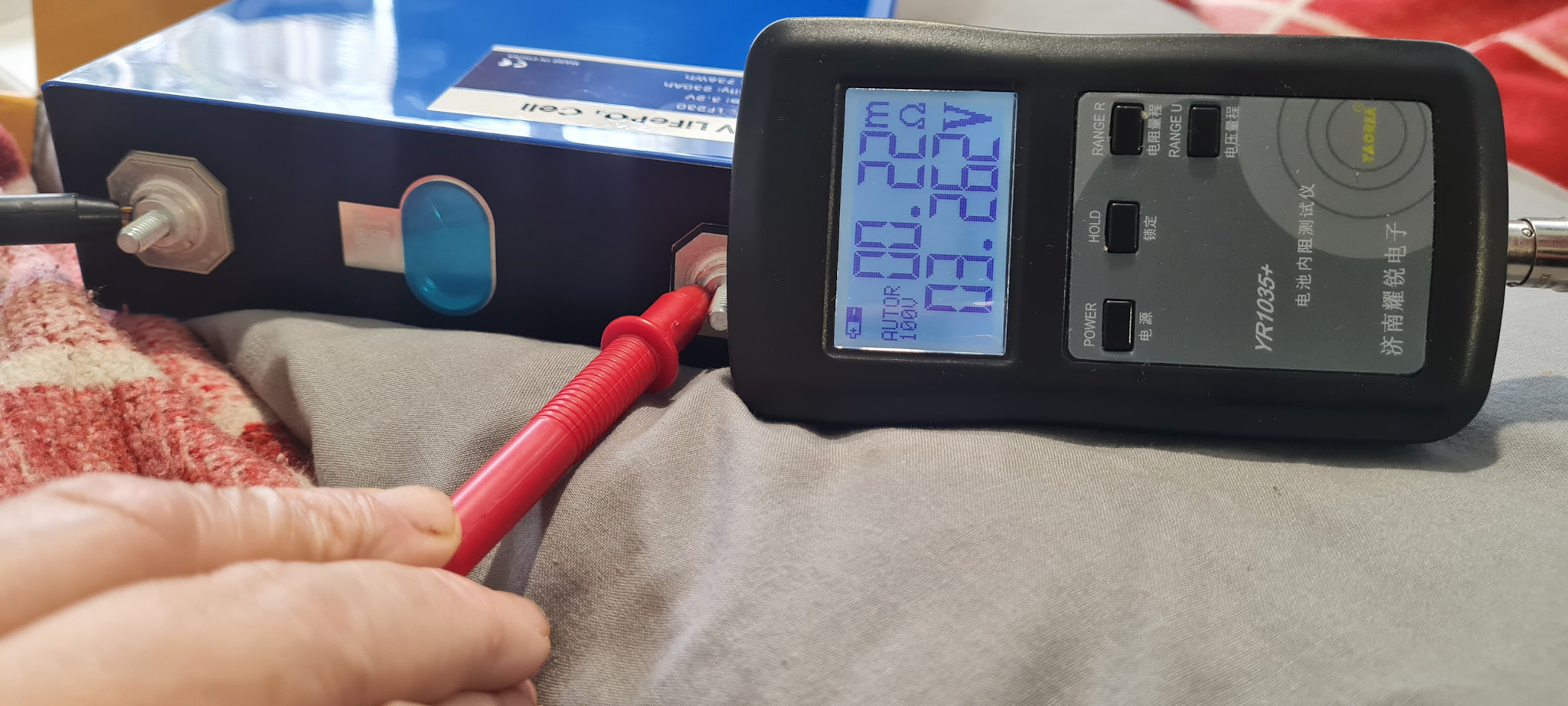

Then I would MEASURE the battery resistance as an AC impedance.
Unless you do ALL THREE of these things you are guessing. And cannot ever know.

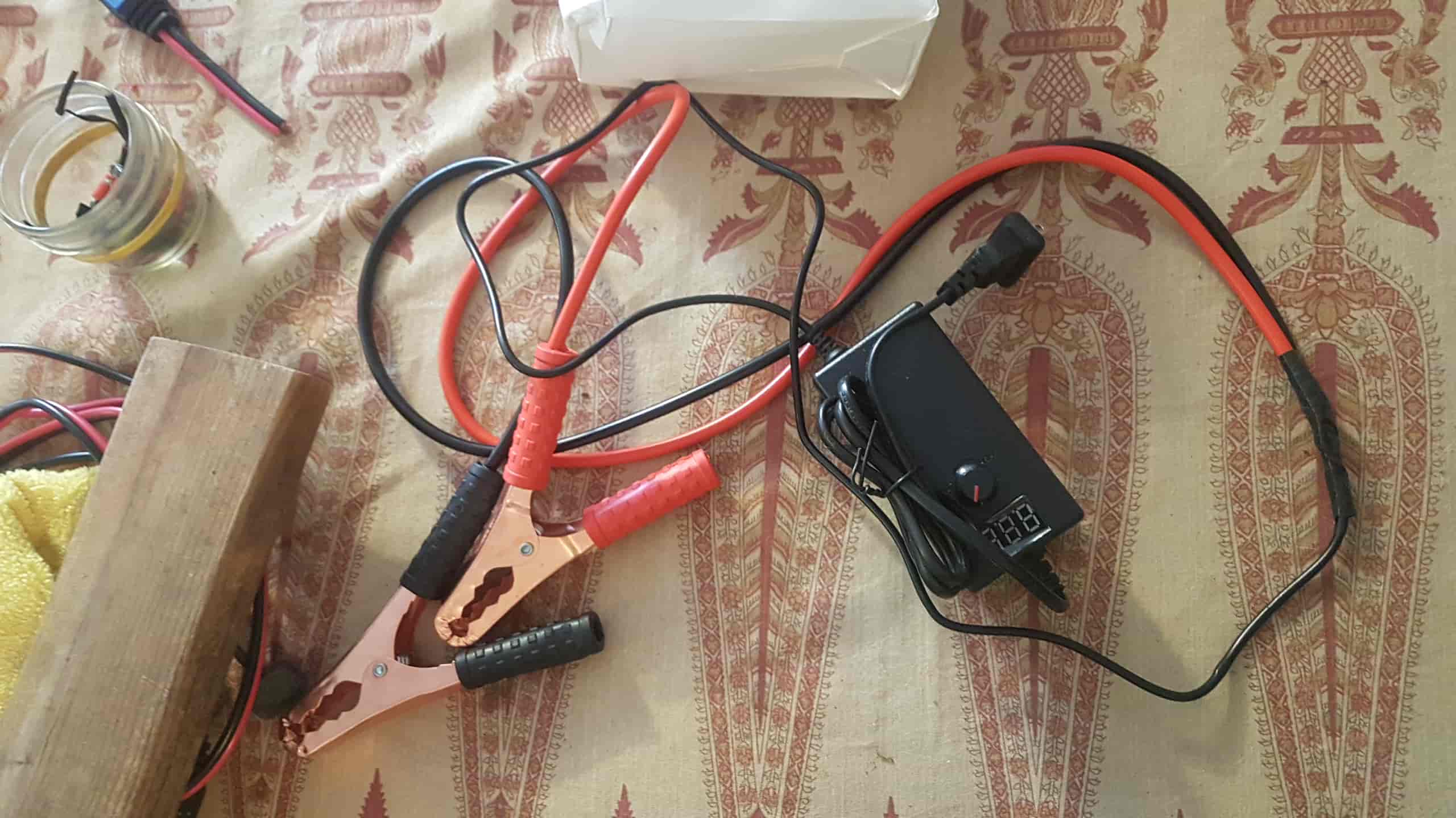

Postby yeshelp » 24 Mar 2026, 21:02
HI
I received the tools and soldered them. They( I build 2) are ready. 1 amp.
