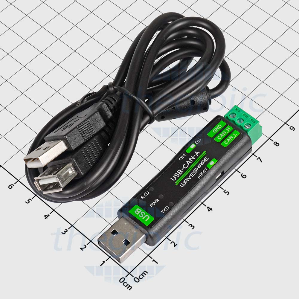

@stephenc1: Is it possible to use an usb-can adapter to connect a PC/laptop to a rnet power module for programming?

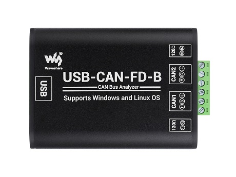

Or this industrial usb-can adapter?

snaker wrote:Or this industrial usb-can adapter?
https://mlab.com.vn/industrial-grade-ca ... rface-card
Certain ones might have to properly terminated with a resistor, the docs should mention this somewhere.
