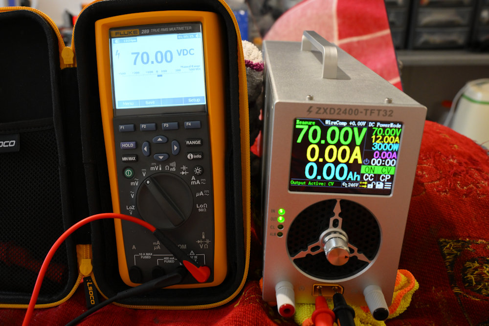

Resistance of wires becomes less and less important as current falls away. At the point where the current is lowest when charged, a the end of CV stage then, it plays almost no importance at all.
It wont make any difference at CC as voltage is not yet reached.
It may mean a slightly LOWER voltage at the start of CV stage where the current is still high. But thats a good thing. But its barely measurable.
And the final voltage, at end of CV where current is low then voltage is the same as power supply (because low current) and thick wires. Ohms law!
You see that 0.01V extra at anything below 10V in my photos on the previous page? Thats MORE than the correction needed... Already!
So 4 wires really isnt needed. Even with relatively thin charge wires it still isnt. But if using say 12 swg silicone to cope with 50A then its really irrelivant! Unless 5 or 10 meters long.

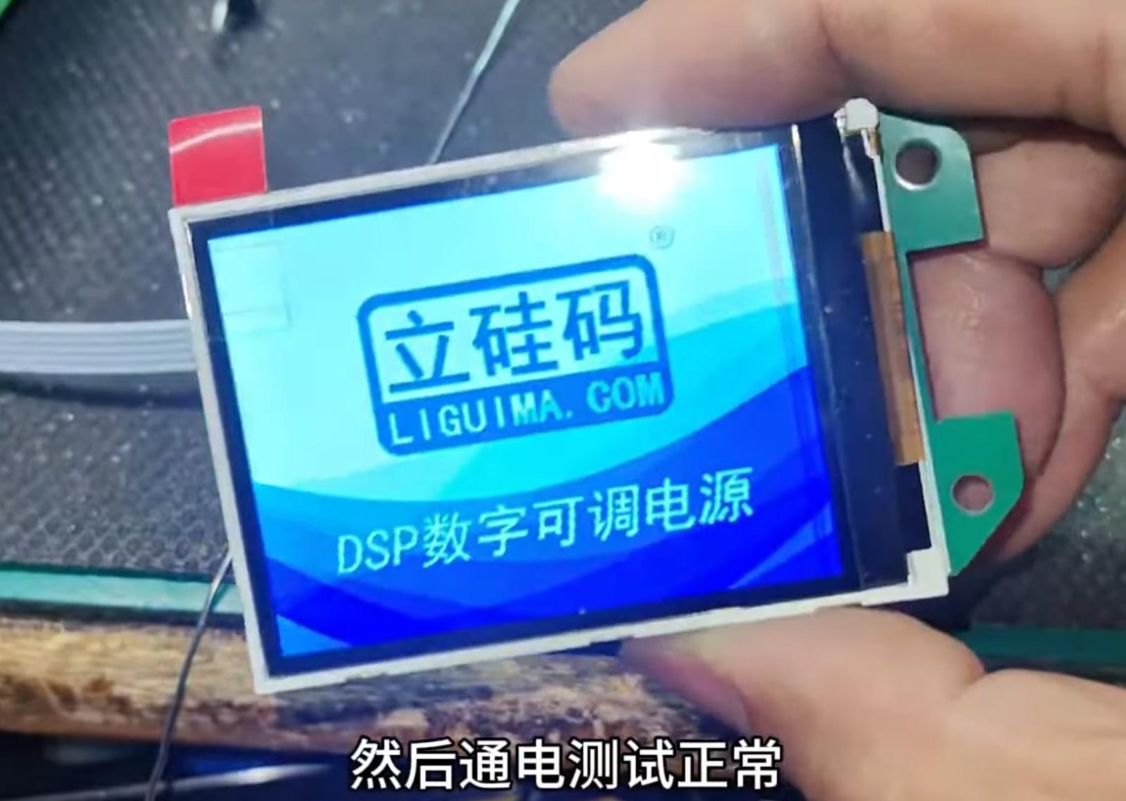

Look for this logo. He is the original designer of this modification kits.
It is still undergoing debug and additional features. You will have update from him, as psu is BT connected.

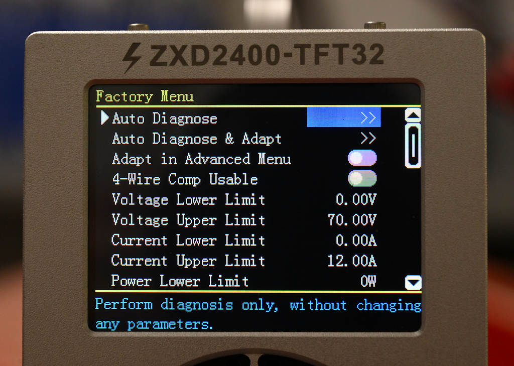

According to my fluke that samples and graphs data at 100k per second it does ramp up slowly. It all depends on your perspective! It depends on your definition of "suddenly jumps up". It ramps up REALLY slowly if you are an electron going at light speed! Electricity is fast. Its all a matter of perspective.
60 seconds? No. A fraction of a second it already does this.
What is it for? I mean what do you want that 60 seconds for?
You dont need to watch it ramp up. You can SET a maximum current limit in the menu of say 12A as I have below if you want to be safe charging via an XLR cable for e.g. It then cannot ever exceed this.
Likewise you could set a max or min Voltage to say 28.2 or whatever as well. So carers or yourself cannot set it incorrectly and damage anything. And it can be pass-worded.
See screenshot. Set to 12A limit for safe XLR charging here.
