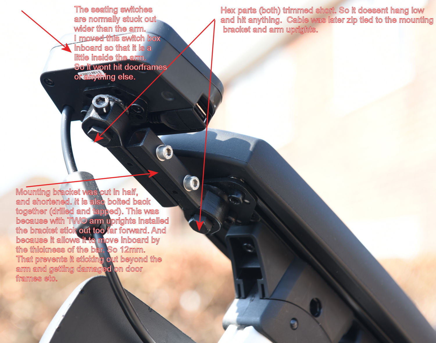

Switch it, CTRL5 control box mounting.
Shows gap, to allow correct cradling of the pod by your hand
Shows GAP on Joystick and that the Switch It CTRL5 box is sitting inside of the arm so it hits nothing.
Shows that its moved inboard by a bit to miss door frames etc.
CABLE is now nealy cable tied to the shortened and modded mounting arm.
