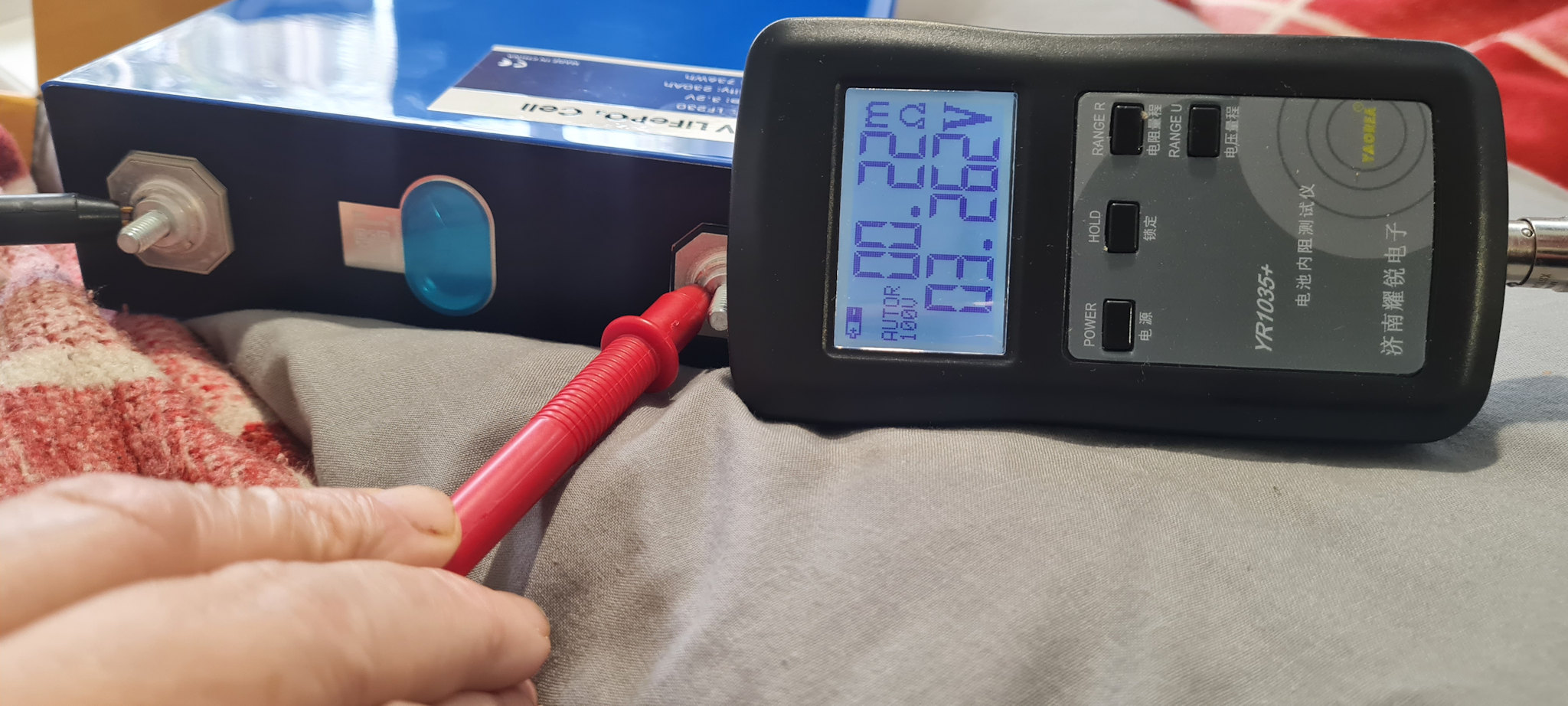

You need a 4 wire tool to measure impedance as an AC frequency. These probes each have two wires and "points".Zoom into the black one and you can just about see this. It Injects AC and measure impedance at 1000hz directly at the terminal so it isnt measuring the test leads! Cheap from china. You cant do it any other way unfortunately. You can measure the other things as I said above though.
This shows the 0.22 of a mOhm on my LiFePO4 call.
So 8 of these, (for 24V) is 0.22mOhm x 8, only 1.7mOhm total!
https://www.aliexpress.com/item/32999842460.html

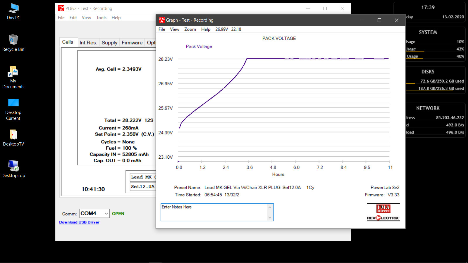

Ys, set the PL8 to discharge it to 10.8V (1.8v per cell).

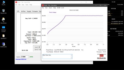

When the charge line is horizontal that is the time you must wait as the current drops away. While its at 14.1V per battery. That horizontal part needs to be 8 hours long if deeply discharged.
Set the PL8 to stop charge at 1000thC (2 IN PARALLEL is 66Ah) so set termination current to say 70mA or 8 hours whatever occurs first.

Postby Burgerman » 04 Dec 2024, 22:12

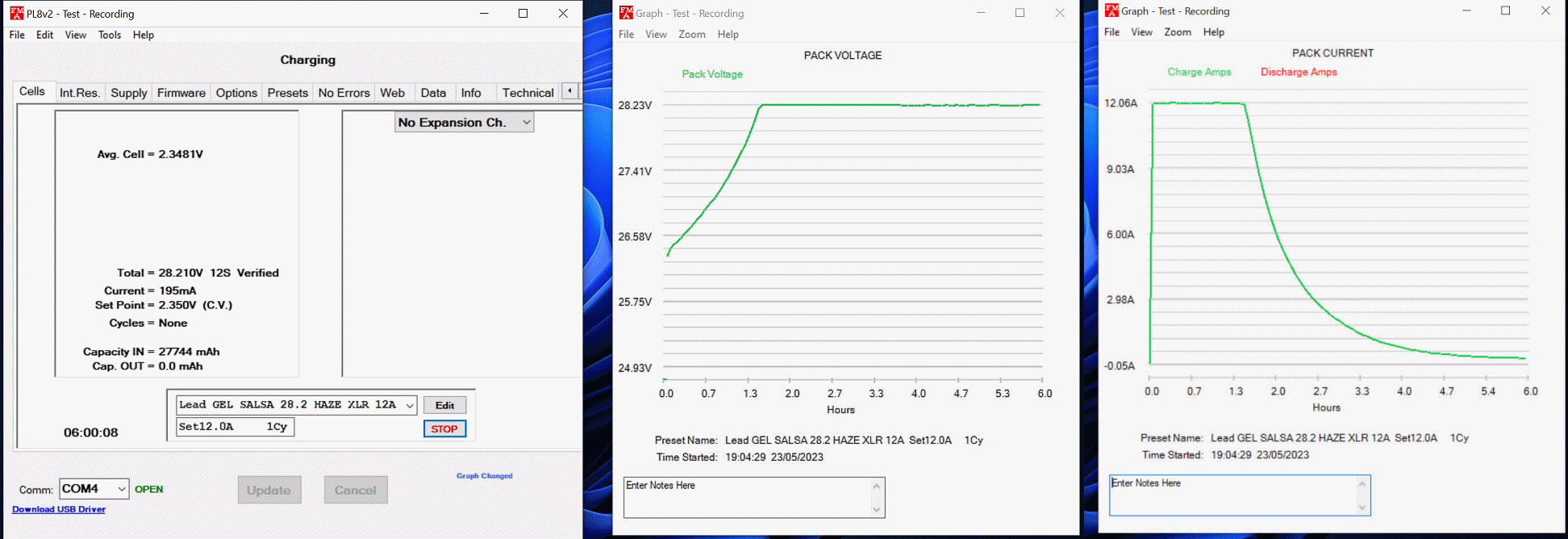

Voltage climbs first stage, at whatever max current you set.
Voltage then held steady at 14.1V or whatever you set while current falls away.
Re: 33Ah gel batteries questions
Postby Burgerman » 04 Dec 2024, 22:16
Heres one thats not finished yet...

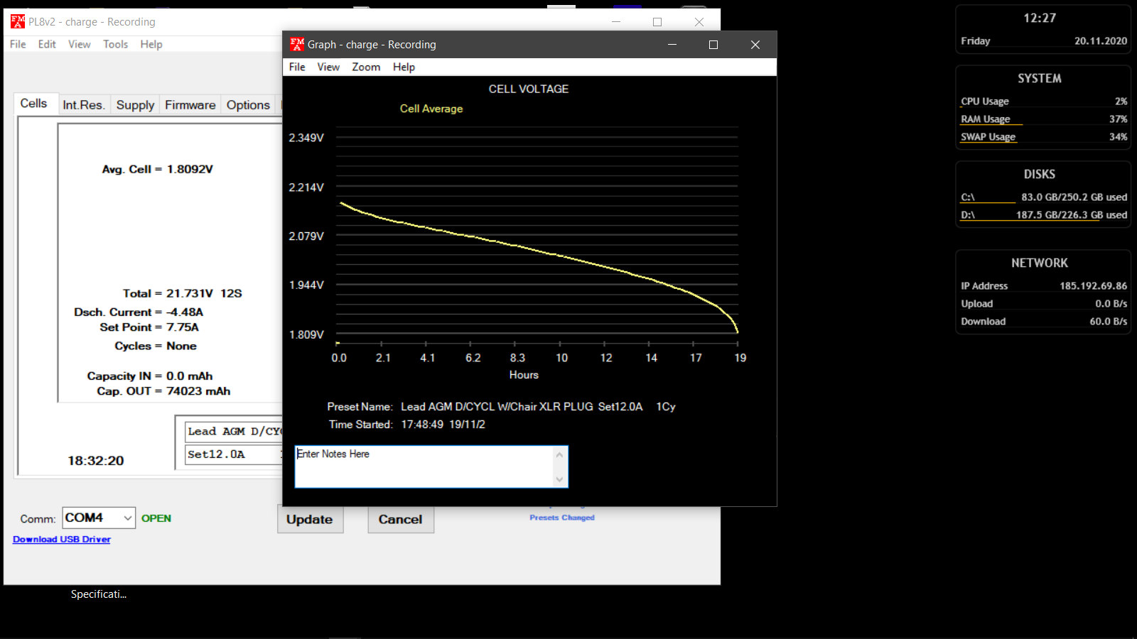

If you want to do an ACCURATE capacity test then you need to do the following:
Discharge the battery, each one individually, over 20 hours Or rather the 20h rate. Why? Because your battery is rated at a 20 hour discharge capacity. Do it slower and get more than your 33Ah. do it faster and you will get less. This is due to the surface charge effect.
So you would set these settings:
CHARGE FULLY FIRST, at 14.1V for 8 hours at CV.
Divide the 33Ah (33,000mAh) by that 20hours. So thats 1650mA. Or 1.6A discharge.
After APPROX 20 hours if its healthy it will reach the 10.2V point you will need to set. That will give a FULL 100% discharge and you will be able to read off the actual capacity in mAh.
Like this, test on a 24V setup and an 76Ah AGM battery.
It is ALMOST finished here. And reading about 75,000mAh (75Ah).
But you must be exact, at 20 to 25 centigrade, charge properly first, etc.

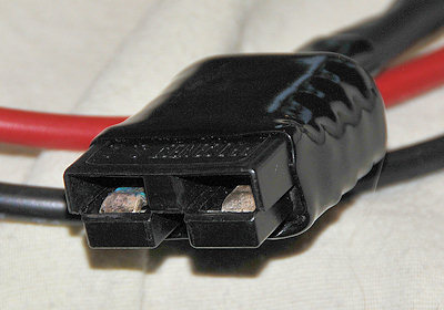

That chair has Andersons, 12V and 24V. I struggle to plug them in and out. And they each have a kind of plastic cover. Those covers are no help with plugging. And I have my doubts about the connections under all that plastic. At any rate, the machine has a bad 24V connection now and wrought havoc with my errands today.
What can I do if I haven't the strength to manage those plugs? For a start, do they really need those plastic covers? I would cheerfully cut them off and bin them. Then I could try whether they need less insertion force. Then I would take a look at the pins .
Then I would realise that they are still stiff and now they let in the rain as well??
Maybe some vaseline?

Postby LROBBINS » 06 Dec 2024, 07:42
Anderson says that you can put a light coat of oil or grease on the contacts. That does make plugging them in and out easier. You could also lubricate the plastic shells themselves with a dry teflon spray lubricant.

I think she means that the normal plastic shells have an additional cover or case on top?
If so bin it...
For what its worth, I use cheap aftermarket andersons, non official for all the solar connections with cables all over the roof, garden, etc in full open weather washed situations a decade ago. No protection, oul or anything else and all working perfectly ever since. Must be around 30 of them in total.
And I used to use the same anderson 50 with off board truck starter spinning the crank in high current direct drive as an external starter on drag race bikes. Thise things pulled 250 upwards amps or more. So I wouldnt worry about a little rain in a power chair!
But if the manufacturer has crimped them, I would worry about that being your high resistance problem. Crimps are problematic.
OR they assembled it badly and a contact/pin isnt located in the shell correctly. So making bad contact.

Postby LROBBINS » 06 Dec 2024, 09:03
Once in a while I've had a contact slip back in the shell while plugging in resulting in a weak or absent contact. I too use el cheapo fake Andersons, and some of the contact don't have a sharp angle where the spring presses into them so are more likely to slip out of place. A couple strokes with a needle file takes care of that.

I shall peel the plastic cover off those Andersons, the better to see what I can do.

Postby Burgerman » 07 Dec 2024, 10:56
Heres an example of an anderson with a daft cover, and with a contact that is not inserted properly. This one caused trouble!
Postby biscuit » 07 Dec 2024, 11:37
Yes, mine are like that.
On Monday I am going to peel the covers off, then I will easify the plugs, then I think I can jemmy the pins out using a screwdriver (iirc from watching YouTube) and see if the connections are sturdy.

Postby Burgerman » 07 Dec 2024, 11:45
Scissors.
All those are good for is kkeping the damp in...
Look at the CONTACT in the image. The one on the right is not located correctly. It makes bad connection...
