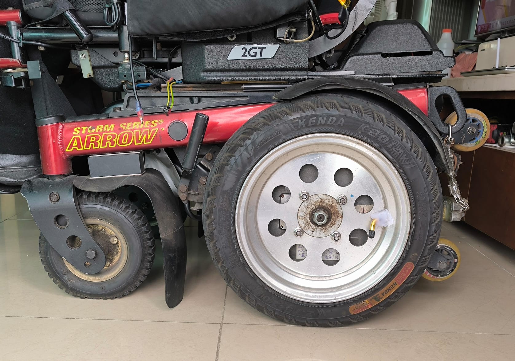

The whole setup fits perfectly and the chair looks very compact. Plus, with the 3.00-10 gear ratio you gain a bit of top speed, which I've never seen before. Did a manual brake on an electric wheelchair come like that as standard?

Raro wrote:Did a manual brake on an electric wheelchair come like that as standard?
YES.
2.75-10 tyre looks more balanced on my other chair.
Re: Punctures!!! Grrrrrrrr
Postby Raro » 08 Feb 2026, 12:33
Also on an Arrow? 2.75-10 which is wider, right?

Postby Raro » 08 Feb 2026, 13:00
Sorry, I meant narrower but with a slightly smaller overall diameter.

Postby Burgerman » 08 Feb 2026, 16:56
Smaller diameter than what? Its on a 10 inch rim. So 2 inches larger diameter to begin with.
Normal industry chaitrs use 3.00 x 8 tyres.
So 3 inches top. 8 inch rim. 3 inches at bottom. So 3+8+3 =14 inch total.
A 10 inch rim with 2.75 tyre is: 2.75 + 10 + 2.75 = 15.5 inches diameter and 1/4 inch narrower.
My 120/70 - 8 TYRES, are 120mm wide tyres use a lower sidewall at 70% of the width. So those are 120mm x 0.75 of that 120 tall. Thats about 14.5 inches overall but nice and wide.

Postby Raro » 08 Feb 2026, 17:37
I wasn't comparing a 300-10 3+10+3=16 like the one in the photo with a 2.75-10 2.75+10+2.75 =15.5 which is the one Shirley mentions; therefore, it has a smaller diameter.

Postby Burgerman » 08 Feb 2026, 19:17
Yes, its smaller, but not much. Its a lot bigger than a normal chair wheel. You really need a way to lower the rear as it tips the chair forwards like you are going downhill all the time! Maybe it wont need batteries! :D

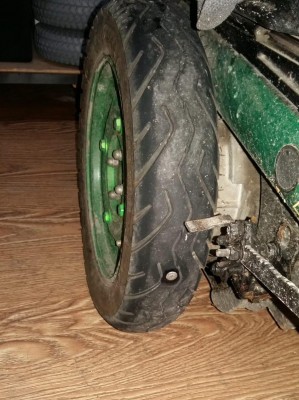

What made me swapping to tubeless ?
He went home with a bolt unnoticed, as you can see the tyre wasn't losing air at all.
Only the faint sound of that bolt hitting the road caught his attention later on.

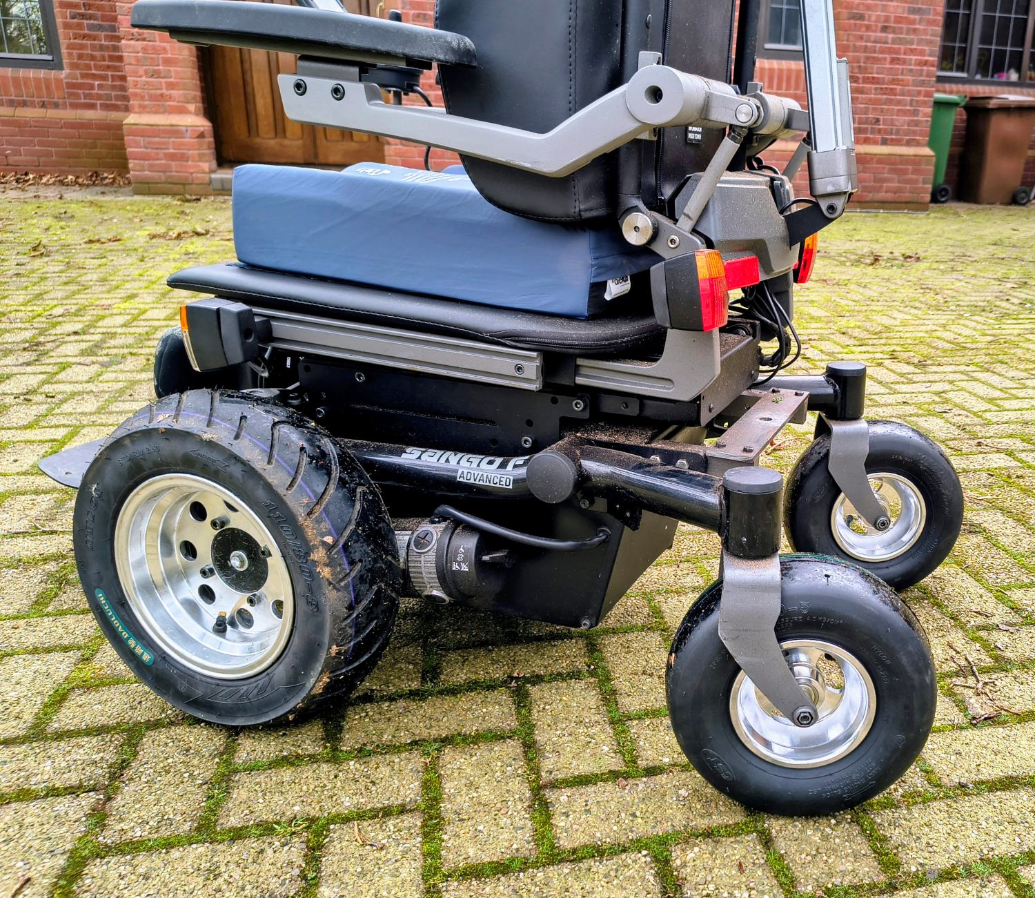

Burgerman wrote:What size castors or tyres does your chair have?
The casters are 210x65 and I think the width can easily increased. The height not a lot. Maybe 1cm more diameter.
So sadly the nice alu wheels will probably not fit.
But these should definitely fit:
Altough I really don't like the plastic wheels.

Postby Kande_ian » 08 Mar 2026, 20:03
https://www.wheelchairdriver.com/board/viewtopic.php?f=2&t=11328&hilit=punctures&start=90#p215080
For anyone thinking about trying these, here is a photo of the 10" version of the tubeless castor fitted to my wife's Dietz Sango FWD.
I was planning on replacing the bearings with stainless as BM suggests but have NOT yet done so because the axle bolt on the Dietz is only M8 and I'm not aware of any readily available 32mm OD 8mm ID bearings.
I didn't want to modify the forks to take a larger diameter axle, so instead I made up two pairs of stepped stainless spacers with 8mm ID bores to trial with the supplied 6002 bearing.
The outer part of the spacers is 25mm long x 20mmOD and the inner part is 15mm long x14.98mm OD to be a snug fit in the bearing bore.
Assembled, the castors are a close fit in the width of the fork (one of tyres rubbed on the side of its fork when it was inflated to 40psi to make it seat properly but it is not obviously rubbing at 9psi).
Inflation is easier than the previous tubed tyres I'd fitted to the standard Dietz rim - with those it was very difficult to apply a pump or airline and it was easy to lose all the air just trying to measure the pressure with a low pressure tyre gauge.
Next thing is to see how they work out in use - hopefully encouraged by improving spring weather.
It took so high pressure to hear it pop, overcoming the bead ? :fencing

Postby Burgerman » 09 Mar 2026, 07:59
You should use tyre lube stuff. I have a tub of black stuff here instead of the usual white. So it doesent look a mess... But thats actually a good thing. Its less likely to come off the bead when you land a wheelie or whatever...

Postby Kande_ian » 09 Mar 2026, 11:02
Probably didn't need to go that high but I wanted to make sure they seated against the rims and their volume is so small that applying the airline to them gets the pressure up very quickly once they do start to seal.

Postby Kande_ian » 09 Mar 2026, 11:17
Burgerman wrote:Might get a few of those.
The rims look pretty well made, I'm less convinced about the tyres, I guess we'll find out how well they stay on at low pressure and how well they'll last.
They are also about four times the price Shirley quoted by the time you get them to the UK, so not a no-brainer.
Might do better on Alibaba rather than Aliexpress for multiple pairs.
