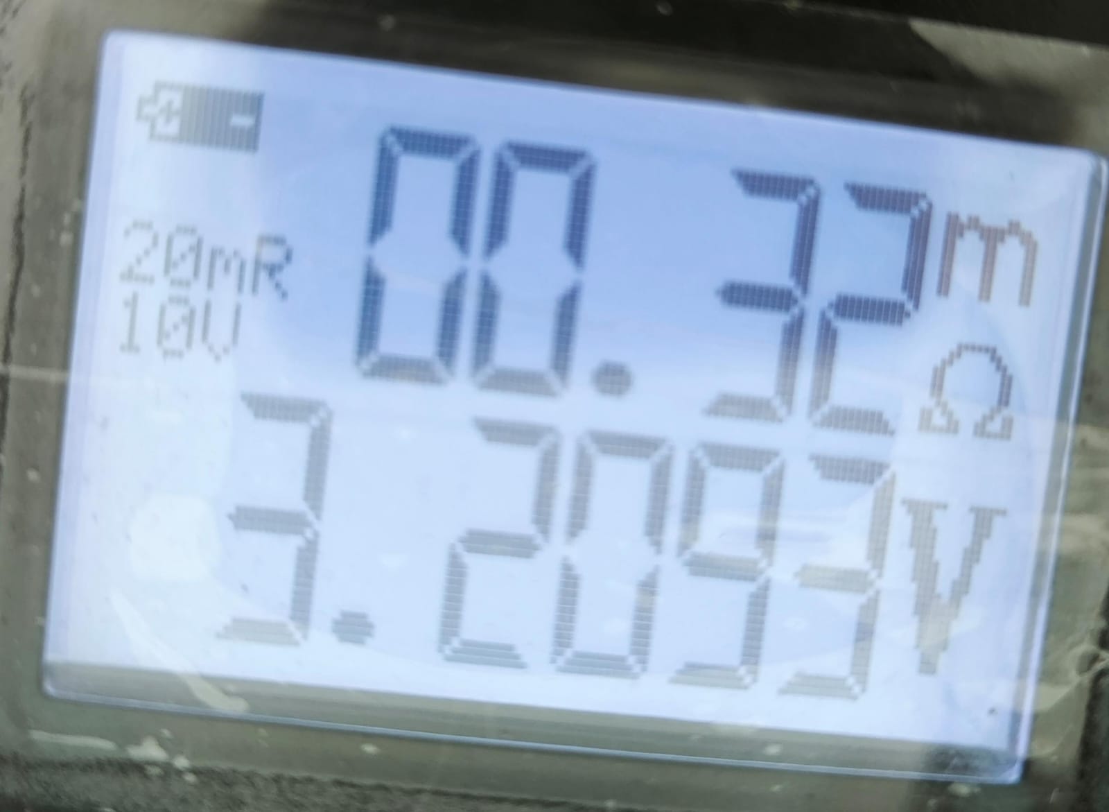

So… you say i am wrong? Look to page 2 on this thread on your photos with measure and your have 00.22mΩ and mine have 0.285mΩ so
0.2xxx AND 0.2xx are almost the same thing. Practically the same as a lump of cable. Thhe difference there os tiny! 0.065 of a mohm!
mine is with + 1-2 not 00 like yours
Dont understand what that means.
You are reading a microscopic 0.065mOhm difference. Which is so tiny is practically unmeasurable, same as a pit of wire/cable.
Where is this + 1-2 (whatever that means?)
Posts: 71119
Postby Burgerman » 25 Aug 2025, 20:01
Your IMAGE shows 2.85mOhms. TOO HIGH.
Your text says 0.285mOhms... Repeatedly. Which is OK.
Which is it? Because thats a 10X diference!!!
Its also hard to believe that its 10x higher impedance. It wouldnt seem credible. If its TRUE then send it back. Set meter to 10 or 100V.
Show me the probes on your meter. On the battery.
Posts: 71119
Postby elryko1992 » 25 Aug 2025, 20:09
Burgerman wrote:Your IMAGE shows 2.85mOhms.
Its also hard to believe that its 10x higher impedance. It wouldnt seem credible. If its TRUE then send it back. Set meter to 100V.
So you tell me i can sleep without problem? :-)) i know from PL8 if a cell is high than 1mΩ is weak no? And this have 1+mΩ

Postby Burgerman » 25 Aug 2025, 20:11
No.
READ nmy last post.
You gave 2 figures.
On your PHOTO it says 2.85mOhm
In your text it says 0.285mOhm many times.
WHICH IS CORRECT? Thats TEN TIMES difference.
Please read my last post.
Posts: 71119
Postby elryko1992 » 25 Aug 2025, 20:15
Burgerman wrote:Your IMAGE shows 2.85mOhms. TOO HIGH.
I write wrong, the IMAGE says better what i want to say.

Postby Burgerman » 25 Aug 2025, 20:19
OK then that is either a bad cell, or you measured it badly.
Let me SEE the ends of the measuring probes on the cells.
You cannot measure with bolts, terminal connections, etc MUST be the actual bare terminals. Or it will be reading your connection not the battery.
Posts: 71119
Postby elryko1992 » 25 Aug 2025, 20:25
Burgerman wrote:OK then that is either a bad cell, or you measured it badly.
I just dispatched the box and measure, is not first time when i measure a cell. I wait answer from Amy and will see what i do. The problem is not my money is for a friend. And is strange because all the cell have the same problem.

Postby elryko1992 » 25 Aug 2025, 20:28
Look is measure another cell now

Postby Burgerman » 25 Aug 2025, 20:32

Postby shirley_hkg » 26 Aug 2025, 03:11
1, select the most precise range
2, aim at the terminal face. I always take support at the weld joint, so I have a firm press against it to make good contact.
3, multiple tries and take the LOWEST value, not the highest or average one.
Relax and be patient. It's usual to measure it a few times, before you get the true IR.

Postby elryko1992 » 26 Aug 2025, 07:57
I reset factory the tester and works good now, LOL:-)). Everything is good :thumbup: :D
The cells are good NEW

Postby Burgerman » 26 Aug 2025, 11:32
That one shown is fine! If they all measure between 0.2 and 0.3 thats great.
And as Shirly
ey says set to the closest range to that which you are measuring. A full pack inc all connectors, set to 100V. Single cell set to 10V. For impedance set to the next one above what you are expecting. Or Auto.
But do not measure the bolt as now you are measuring the resistance of the thread/terminal post interface or join which can be anything from nothing to much more than the cell itself. As shirley shows, and I show, measure terminal post or welded joint. Take lowest value you can measure so that you are only measuring the cell and not the mechanical "joint" between meter and vell.
But 0.28 is no problem! Less than 0.4mOhm still OK. Thats within the error bars when reading super low impedances.
Posts: 71119

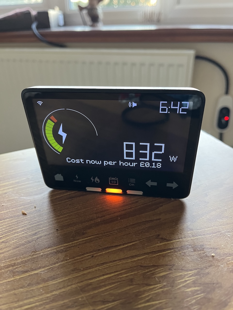

I charge my powered mobility devices in garage and use the smart meter display unit to give me a rough idea when charge current starts dropping. It's obviously not as good as the android bluetooth app that some of you guys have. But with just me and the cat living here it gives me some indication.
