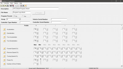

Wow. Even more basic than I remember!
Arrows show the MINIMUMS. And reverse speeds etc. That your expert claims dont exist.
Do not try to use a shop or "tech" to program a chair as they nrmally dont have a clue.
Go back and CAREFULLY read my posts and links in this thread. If there is anything you are unsure about, a setting you dont understand, ask!

In both cases it only works at super slow speeds. At small stick movements. Once faster than say 0.1mph it does nothing.
It either INCREASES motor compensation only at very small stick movements. Or it adds a "step" so that the joysick starts at 5% instead of 1% as you move it. The result is the same either way.
This is likely what he is talking about.
Posts: 71120
Re: Urgent advice needed: 4 pole or 2 pole motors?
Postby faico_26 » 12 Apr 2025, 16:05
Burgerman wrote:In PG chairs, pilott plus, r-net etc the parameter he is talking about is called torque.
What motor compensation does it amplify (increase) the power sent to the motors when it senses a current. So if you move the joystick just a 1/4 of an inch the chair moves very slowly. The motor might be recieving 1V at this point.
Add some extra "resistance" to say the left wheel, say a rock or a bit of grass. A small sope. And now what happens is the this left wheel tries to pull slightly more AMPS because the more you load up (restrict) a motor the greater the current it draws. So in a sense it tries to apply apply its own "compensation". But it isnt adequate. So that wheel doesent move. Or goes slower. So even though you push the stick forwards (straight) the chair turns left.
When the power module sees additional current on this slower or stalled left motor, it adds more! Its a positive feedback loop. So now the left motor gets more power than the right one. So now it can climb the rock/slope/grass. So that the chair now drives straight as you expected and wanted. As if there was no restriction or rock, or whatever in its way.
But... Motor compensation at very low speeds doesent work as well. I mean really low speeds!
So we also have a setting called torque. It does one of two things. I cant decide which.
Thanks, clear explanation. My chair has VR2, that is PG right?
faico_26
Posts: 352
Joined: 14 Sep 2018, 12:21
Postby Burgerman » 12 Apr 2025, 17:29
Yep.
