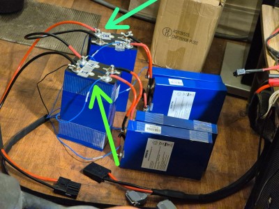

Hi… I am Very excited to have finished building a 100aH back for the lifestand lsc wheelchair (Started this Monday) and followed pretty much the same process outlined in the 230 ah amy docan cells build
The pack is all built up with interconnect , balance and power cable.
I have verified that the voltage of all 8 cells are coming out of the JSt PA connector that goes into the PL8 balance port.

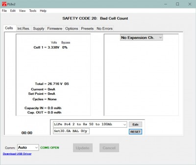

However, though the PL8 is able to see all eight cells, it is only able to see voltage from seven cells and sometimes six cells.
I am using a PL8 v2 on firmware 3.36 with bm preset for 2s to 8s 50 to 100ah .
Whatever I do I can't get the PL8 to see the voltage of cell 8. Wiring continuity has been crosschecked and all errors removed, which is verified from the voltage out of the jst pa connector end.
I haven't tried charging the pack, but when I try to monitor the pack, it detects all eight cells but only shows voltages for seven cells and then immediately diminishes to 5 cells, three cells , one cell and then shows a BAD CELL COUNT and stops monitoring.
I'm attaching some screenshots to help explain.
Is it some setting or firmware that I need to update?

3 questions that may help diagnose.
1. Did you properly SOLDER every connection or are you relying on crimped connectors?
2. What happens if you connect a load that draws around 1A across any/all of the balance wires, maybe a small bulb or resistor? Test each in turn. Because a bad connection at some place will show voltage and will not take a load. As it may be very high resistance. And the same with maybe 10 or 20A load across all 8 cells on the main cables.
3. What does it do on a different profile that does 8S?
4. What does it do when charging any other 8S pack?
Upload that preset, rename .zip so I can check I have not set something bad...

1. all the ring terminals for interconnect, power and balance cables are only crimped and no soldering. The only thing that is soldered is the D sub connections. I'm attaching a picture of the crimp
Thats what I thought.
Even without this problem thats a really bad idea. When you connect and crimp you are joining disimilar metals and that forms a chemical "cell" by pushing different metals together. That joint makes a voltage. That alone can give anything from 0 to .5 (500mV) of a volt across a single joint. That will vary depending on crimp quality, humidity level and age and oxidation level over time. And we are trying to balance to a 1mV accuracy... Solder everything! It also could just be a crappy bad crimp connection causing your main bigger problem we have here.

Are you sure you have all the balance wires in correct order???
Do you only have 1 PL8?
Also no preset??
I suspect that somewhere in one of your connectors or one of your crimps theres a bad connection. Maybe where it connects to the PL8 or someplace. Ir it wouldnt detect correctly at all. Try deoxit, wiggle connectors.

All the balance wires are blue in color.
The ground for the balance cable is black in color
jehan
We did try some contact cleaner and a toothbrush on the pl8 balance connector on Friday. Could do it again.
UPDATE: downgraded the firmware from 3.36 to 3.22 and there was no difference. Today tried firmware 3.30 and now we are getting cell 7 showing up A lot more consistently, but not perfect.
Only cell 8 is still showing as 0.000
Please send me the latest version of CCS or should I just try reinstalling what I have ?
It's just cell 7 that That shows voltage most of the time and cell 8 that always shows 0.000 .

Use 3.35 or 3.36 as anything earlier has various issues.
It should show all cells on EVERY firmware version. The fact that its intermittently showing 7 says bad connection someplace.
Power supply noise or bad connection is my guess. Or defective charger. Solder!
Power PL8 from a lead battery or your car. What does it do?

In the meantime I've been using the 100 AH pack for the last three days.
I have charged the cells individually to terminate at 100 MAH CV and installed in the chair.
After three days of use, the voltage is 26.6 V.
I am trying to charge the pack unbalanced.
I tried to use the existing preset and removed the balancing option.... But it still looks for 8 cells and gives a bad cell count.
I would like to charge the pack as a whole without balancing.
Please let me know how to do it?
Do the balance cables need to be plugged in?… I tried both with balance cables and without… And I still get a bad cell count

Since my existing PL8 balancer , is not reading a couple of cells Is it possible to set up the pl8 to emulate a dumb charger and plug it into a JK BMS to handle the balancing side of things?

Postby Burgerman » 14 Apr 2026, 12:53
Not really. If you have a power supply already and a BMS then the PL8 isnt needed.
There IS a BMS version profile but it has very restrictive charge options for safety reasons.
LiFe A123 1S 8S w BMS No Bal.PS8
(3.19 KiB) Downloaded 9 times
