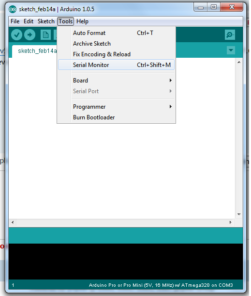

Postby woodygb » 14 Feb 2014, 18:10
If you download the Arduino software... http://arduino.cc/en/main/software#.Uv5M7svivWg ... and install , you could then monitor the data on the P.C. via the supplied USB serial interface and see the inputs and the voltage that is being output... in real time whilst everything is connected up.

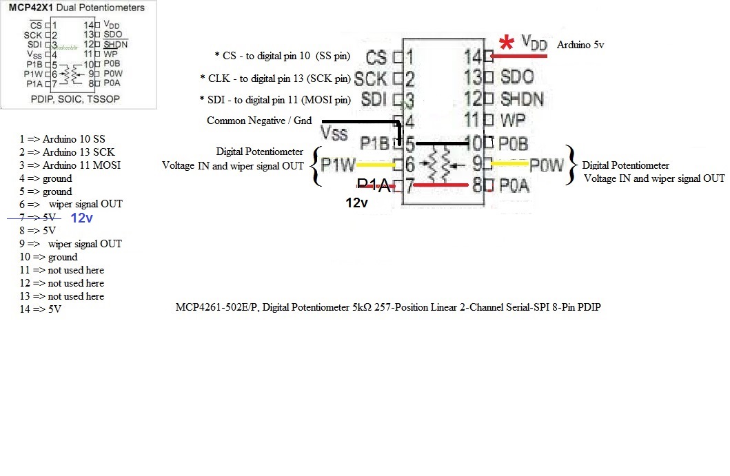

6v neutral ... that certainly is nowhere near 2.5v!
I did see that the voltage reference was 12v/2 ...but again assumed that neutral would be the "normal" 2.5v .
If that is the case... I'll need to rethink the digipot as the number of steps it has is 257 .... lets call it 256 as it makes division easier.
I could feed it 12v ...this would then give 6v at the center. ... with 6v over 128 steps either side ...so 0.047v per step and I could only use 25 steps .
Hmmm...Is a resolution of 0.047v per step sufficient for decent control ?

OK ...
No big problem to replace the current 5v feed going to the digipot by splitting off a feed from the 12v that is currently supplying the 5v regulator.... and replacing the 5v with it.
Then it's just some software fiddling to reduce the number of steps that the digipot will use in response to the R/C pulse.
