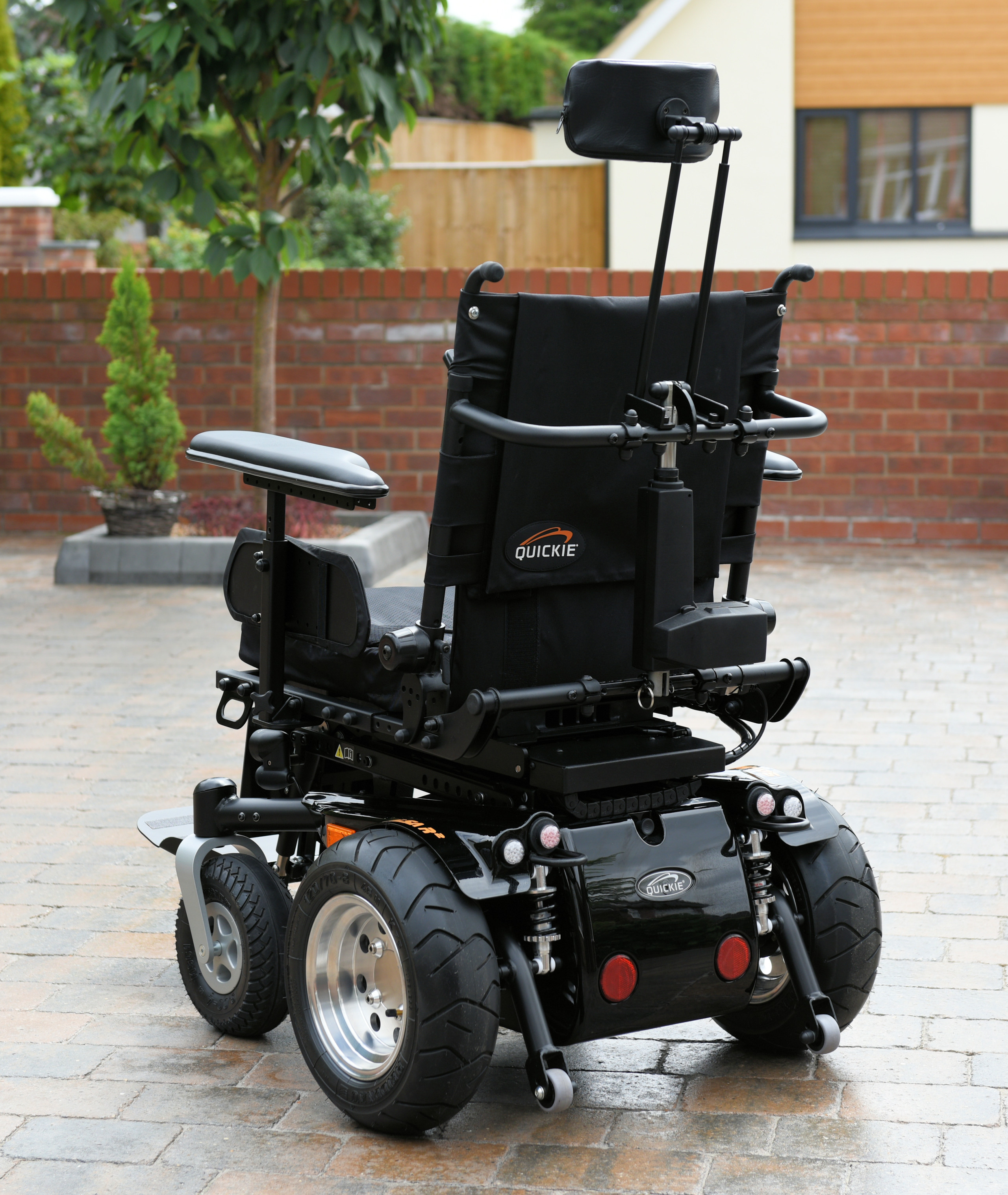

I know you dont do metric. But a 120 wide tyre is the same diameter. But is low profile (70% aspect ratio) and 4.5 inches wide. Its whats on my Salsa. It needs a rim thats 3.5 to 4 inches wide.
90/90 - 8 is the metric equivelent to the 3.50 x 8. in width, but is slightly less diameter so the same as a 3.00 x 8 in diameter.
110/80 - 9 is same as a 410 x 8 in width and the same diameter as a 3.50 x 8...
These ar 120/70:
