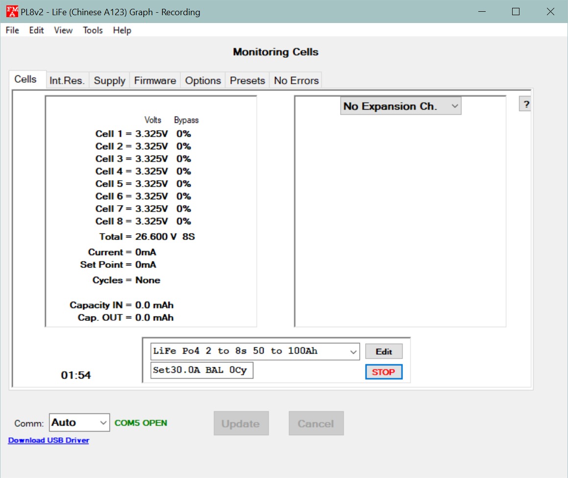

Shirley's PL8 arrived this morning… Took only about a week by post… That's amazing… And it's running firmware 3.34
Uploaded BMs preset and all eight cells came up immediately.
I haven't charged it yet… will Try charging it tonight.
Thank you so much to everyone… This is such a great solution
THE 100ah preset is set to
Charge voltage – 3.6 V
balance start voltage - 3.5 V
Termination – 175 MAH
CV timeout – 8 hours
Shall I try this?

Postby Burgerman » 15 Apr 2026, 14:17
After a few charge and usage days/cycles, you can fine tune the settings.
CV Volts 3.550.
It should end after balance completes plus around 20 to 40 mins. Not critical really but... By adjusting the termination current you can get it as close to perfect as possible. Increase it to shorten time taken. Decrease mA instead to make it stay at CV longer. Theres no way to guess this. It varies by packs.
