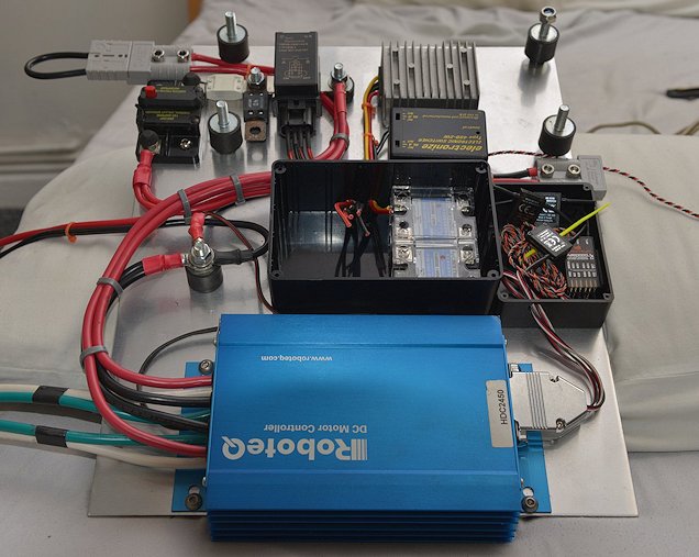

okay, I want to create a list to order everything needed to create this;
1. 1X roboteq controller HDC2450 (confusion already http://www.roboteq.com/index.php/robote ... 400-family which one as they don't exactly correspond to what is written on the picture.)
funkykeyboard
Posts: 1015
Joined: 22 May 2010, 15:45
Location: Southport, PR8
Re: Where to find everything powerchair related
Postby funkykeyboard » 10 Jul 2014, 19:05
http://www.roboteq.com/index.php/robote ... 450-detail
It has to be that one yes?
Is there any chance of a list of the parts and links to suppliers? :oops:
funkykeyboard
Posts: 1015
Postby Burgerman » 10 Jul 2014, 19:49
HDC 2450 from Roboteq obv.
2 plastic boxes... Ebay, they contain:
1. Box 1 = RC receiver, in this case a Spektrum DSMX AR10,000 with 3 satellite receivers, located in the rear lights, and under the seat at the front.
2. Box 2 = 2x eBay SSRs that do 2 things. a) one works 12v motor brakes, and have a couple of TVS protection Diodes across them. b) the other allows the roboteq to switch the Power Relay OFF in the event of a internal mosfet failure.
Relay... Automotive 100A latched, 12v that switches 45v main power in the event that anything bad happens via a red button on the JS/pod, or via the roboteq. It also powers the permanently live 10A 48v to 12v inverter, (15mA current) which in turn powers brake and lights and the relay on/off. There's also a 120A breaker (thermal bimetallic type) and a pull loop emergency release. And a 175A fuse in the main battery loop, a 40A 100v diode and a 1k 2 watt resistor across the contactor, fuse, breaker, pull loop - to stop sparks inside the contactor on turn on, and to allow regen current to reach the battery on emergency shut off so as to not fry the roboteq in an emergency.
All this stuff was RS components, or ebay.
And also a copper varoboard connecting strip with JS pod and roboteq wires connected to it. There's a lot of wires in there!
Posts: 71117

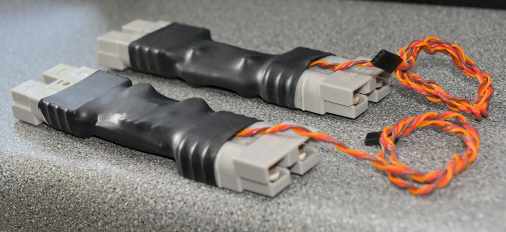

Postby Burgerman » 10 Jul 2014, 20:18
Soldered and crimped...
Posts: 71117
Postby Burgerman » 10 Jul 2014, 20:21
With heatshrink. 2 layers...
All together...
