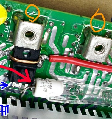

I've been waiting for some ring terminals and other odds and ends to arrive before fitting the fancy case. The supply has been out of the old case since last week. I wish I had taken pictures as I took the old case apart. Because now I'm trying to figure out which of the DC power output on the board is + and which is - before connecting the ring terminals. :fencing
Postby Burgerman » 05 Jun 2018, 19:54
I did the same. I powered it up, the terminal nearest the red wire that goes to the glass bulb is pos...
Posts: 71102
Postby Gnomatic » 05 Jun 2018, 21:03
ok, so pos is the one next to where the red wire is soldered to the board ...
Postby Burgerman » 05 Jun 2018, 21:18
From memory, yes. If I am wrong, then oops. I dont think I am.
As long as the wires are not added to the anderson yet, or connected to the front panel, its not that much of a problem. Since you can swap over.
The other thing is this. IN CASE I was wrong, I had swapped the two screws for hex head ones. So a small spanner could be used after assembly to swap over. By removing just the end. But I was correct since I decided to check on my meter before I got it wrong! :cussing
Posts: 71102
Postby Gnomatic » 06 Jun 2018, 00:08
Thank you. Next up, figuring out the polarity of the AC inputs on the opposite side of the psu ..... :fencing
Postby shirley_hkg » 06 Jun 2018, 01:34
Gnomatic wrote: now I'm trying to figure out which of the DC power output on the board is + and which is - before connecting the ring terminals. :fencing
You hinted your age . drunk2
Marks are on PCB.
