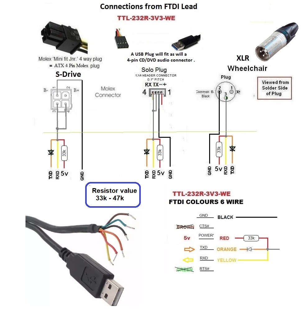

Hi can anyone help me with windows pc programmer software suitable for PG Drives as in Pride Gogo.
I understand the USB diagram and can make the lead shown on here alone question is if this requires a USB driver or is this part of the software.
I have a Gogo here that is doing around 7 mph, it is just so dangerous so want to reduce the top speed.
Any advice on the exact pin to pin for leads would be great.
I have the diode and 33k that is the value suggested now

Postby woodygb » 22 Jun 2020, 14:06
I use 47k on all my builds.
The USB Driver will ...or should ..be loaded automatically by Windows.
The software requires YOU to select the Comms port number and the programming software only recognises ports 1-8 inclusive.

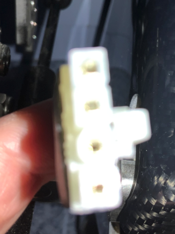

I have acquired another Spinergy ZX1 which is a power assist driven by a VR2 but my PC programmer software shows the connection comms active and then very quickly to comms inactive repetitively. My previous VR2 joystick is fine and constantly shows comms active when plugged into the new Spinergy ZX1 VR2 controller.
The cable from the new joystick has a white disconnection plug or join and I'm just wondering whether this could be part of the problem in connecting. The only other alternative in my mind would be the XLR plug may be not being completely seated in the new VR2 joystick. I don't know about that theory.
I have two baofeng uv 5 cables that work perfectly well other than in this new joystick.
Thanks for any assistance.

Postby woodygb » 26 Jul 2020, 02:05
You could try making a lead using the 3v3 FTDI cable.... I use a 33k resistor on all MY builds... but it was reported that a 47k was required by a member.
Postby takenaback » 26 Jul 2020, 05:50
Thanks Woody. Here a couple of pictures of the connection so it's a solo plug I assume.
I will source the parts and see if a sparky friend of mine could do it as a favour or I'll be in touch.

Postby woodygb » 26 Jul 2020, 09:49
I have no idea what the white plug is ...continue using the 3 pin XLR .
A Solo is a mobility scooter controller.Image
Postby willyam » 26 Jul 2020, 20:59
Newbie here, interested in changing programming for an older VSI (D5112.03) on a Hoveraround MPV5.
What all is required to go between a laptop/pc and the XLR charge port?
USB adapter, (RS232 or RS485?) + pull up resistor and diode?

Postby woodygb » 26 Jul 2020, 23:48
The pic a couple of posts up is the one you need to copy / make / buy.
You also require the P.C. Software .
Postby woodygb » 27 Jul 2020, 14:43
woodygb wrote:You could try making a lead using the 3v3 FTDI cable.... I use a 33k resistor on all MY builds... but it was reported that a 47k was required by a member.
BRAIN FART.... I use a 47k resistor on all MY builds

Postby willyam » 27 Jul 2020, 17:40
Thank you so much! One question before I order the TTL-232R-3V3-WE cable..
Would a USB to serial cable work (have one in my box of cables)?
https://www.staples.com/Belkin-Type-A-U ... _IM1J67605
http://www.usconverters.com/images/rs232-pinout.jpg
willyam
Posts: 7
Joined: 24 Jul 2020, 23:55
Postby woodygb » 27 Jul 2020, 17:51
Nope ... Different signal protocols.
TTL is required.
https://www.sparkfun.com/tutorials/215

Postby willyam » 31 Jul 2020, 20:56
UPDATE
Found a Baofeng programming cable, it uses the CH340G chip, 3 wire.
In this thread, found a mention of diode only, so soldered in the 1N4148, downloaded the serial/usb driver from sparkfun for CH340 (win laptop)
Changed serial port in software.. realized I had to turn ON the joystick to communicate ;)
Success!
Downloaded the controller profile, saved a copy to my desktop just in case.
Accel 30, decel 50, turn accel 25, turn decel 65, Forward 85/30, Reverse 55/35, Turning 17/17
Power 100,
Min accel/decel/turn accel/decel = all 100%
To change the program, do I simply enter new values then click the UP arrow?
Not sure how profiles work, but only one profile has values in the table.
Goal is to take out delays (avoid over compensation) and slow down reverse for our elderly Aunt.
Thank you for helping!
