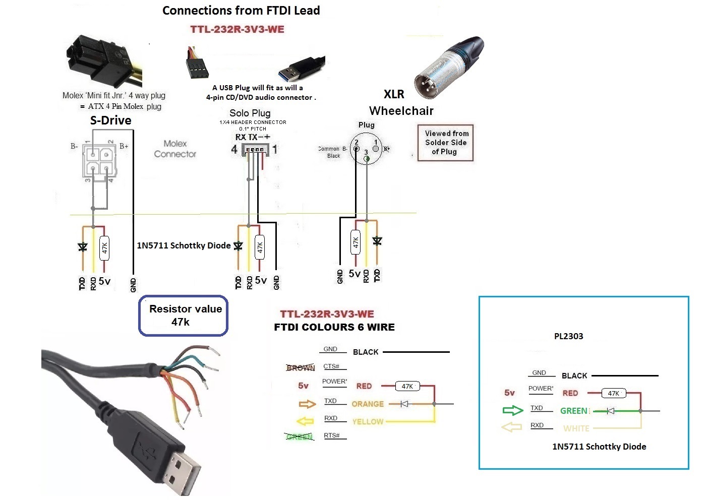

Postby Frogeye » 27 Mar 2021, 08:54
I have a genuine PGDT serial to XLR cable ( and a steam driven laptop with a genuine serial port to boot :lol: )
I need to program a D50447.04 S-drive. I 'thought' I could connect to the charging port and program from there, but either I'm mistaken, or I have a fault.
I was thinking of making a molex to XLR adaptor ( I have the bits here) but I am unsure of correct pinouts, or if it would work. Would anyone be able to guide me please?
Frogeye
Posts: 4
Joined: 27 Mar 2021, 07:03
Postby woodygb » 27 Mar 2021, 09:10
Use the pic posted above in this thread as a guide.
Take pins 3 and 4 of the Molex and connect them both to pin 3 of the XLR Socket....pin 1 of the Molex goes to pin 3 of the XLR Socket.
I seem to remember that the GENUINE PGDT cable requires the 24V positive ...So pin 2 of the Molex to would go pin 1 of the XLR.
EDIT ...Is your 3 pin charging port actually connected to the S-Drives Molex?
Postby woodygb » 27 Mar 2021, 09:35
woodygb wrote:Use the pic posted above in this thread as a guide.
Take pins 3 and 4 of the Molex and connect them both to pin 3 of the XLR Socket....[u]pin 1 of the Molex goes to pin 3[/u] of the XLR Socket.
TSK WRONG!!! ...My mistake ...Pin 1 of Molex to Pin 2 of XLR

Postby Frogeye » 27 Mar 2021, 10:03
looking at the picture above, and assuming +24v is required... wouldn't you be right with pin 1 molex to pin 2 xlr (GND) AND pin 2 molex to Pin 1 XLR (+24v)??
