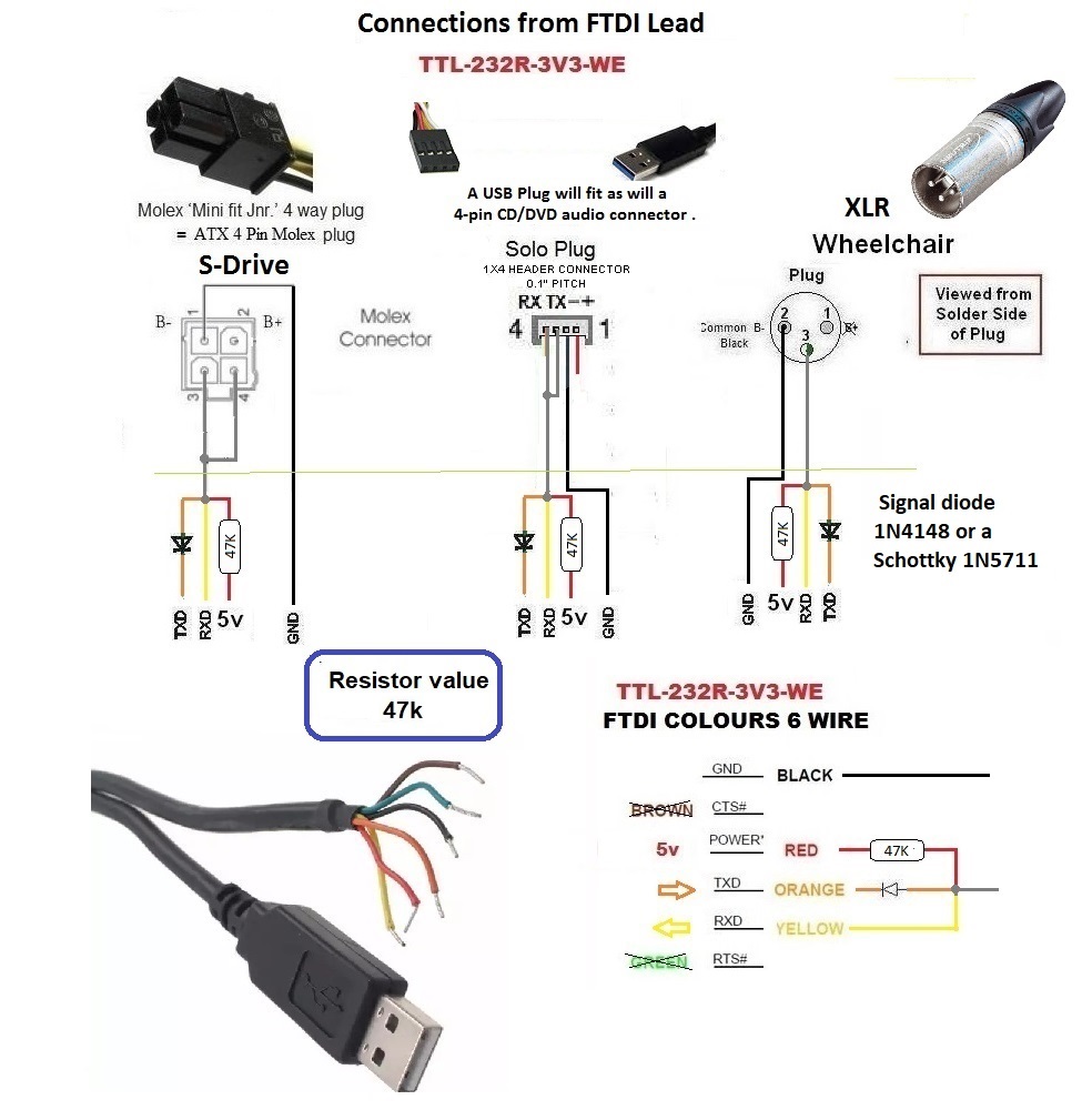

MOLEX PIN 1 GND --- XLR PIN 2
MOLEX PIN 2 24V+ --- XLR PIN 1
MOLEX PINS (3 & 4) ---- XLR PIN 3

Damm I try to make mi programming cable but you have minimum 4 different diagram with different valu for résistance and diode which one is the right one for s200a contrôler
Francoisc
Posts: 3
Joined: 11 May 2021, 23:13
Postby woodygb » 12 May 2021, 07:04
Try this one.

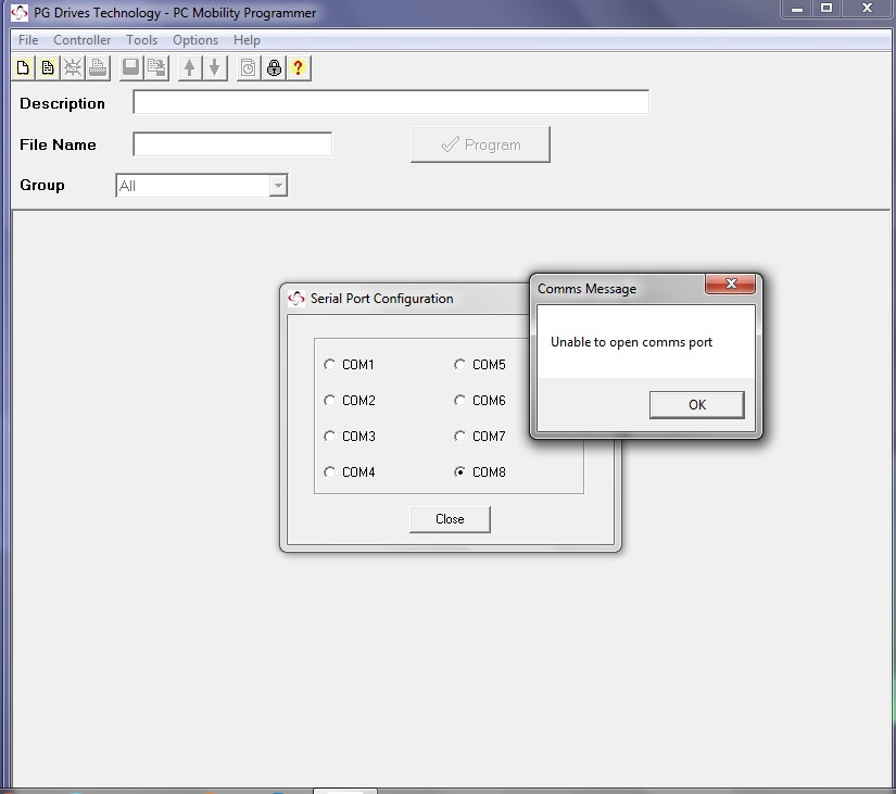

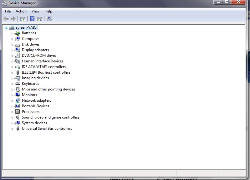

I have an ASUS laptop that doesn't have any com ports (serial ports), just USB ports.
When I start Mobility Programmer_OEM_Std_14_6_0, I get the error "Unable to Open Serial Port".
I have tried everything I can think of. Added legacy (Communication Port) hardware in Device Manager. Tried all I/O and IRQ combinations.
Tried all Ports. I am at a loss. Please help.

Postby woodygb » 16 May 2021, 11:03
Ah!.... The Software will not FIND the correct Com Port YOU need to tell the software the port number that the USB lead has been assigned.
Open Windows Device Manager and see what Com Port number has been Assigned to your lead.
To complicate matters the com port number assigned to your lead by WINDOWS must be between 1 & 8 inclusive ...if it isn't YOU must re-assign an appropriate number to it.
NOTE:- You do NOT need to muck around with ANY settings , other than perhaps the actual Com Port number assigned by Windows to your lead.
Follow the pic guide below ...
Postby Darrell_LeRoy » 16 May 2021, 18:15
When I go to Device Manager there is no way to set the com port. (See Device Manager.png)
When I go to the program I get the com port error on all eight choices. (See Programm.png)
I can add Ports (Com & LPT) to Device Manager by clicking the Action menu, but I can't enable them.

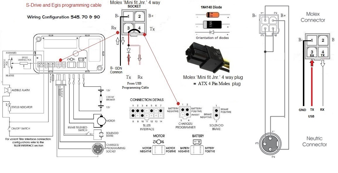

Postby woodygb » 18 May 2021, 08:51
Perhaps this will help .... it shows a member making a S-drive programming cable .
viewtopic.php?f=2&t=5523
Pic of completed cable.

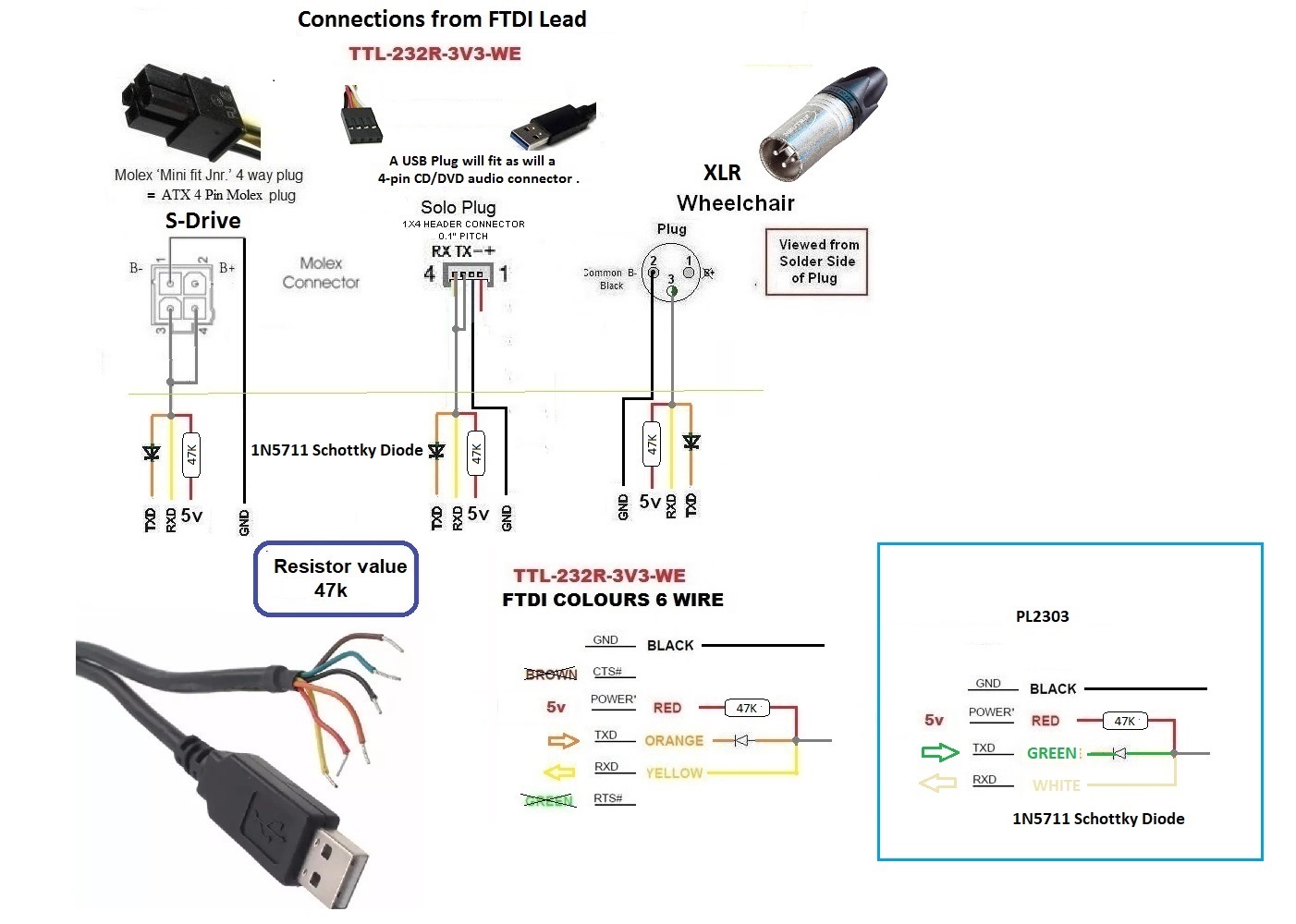

Postby woodygb » 18 May 2021, 13:46
Darrell_LeRoy wrote:This is the first I have heard about an adapter. Looking at the adapter, there is no way to plug the USB to three-pin plug with the white wire with the diode and green wire connected to pin 3 and the black wire from the USB plug connected to Pin 2 of the 3 pin plug.
It looks like you need to have the adapter plugged into the USB port and a cable that goes from the 3 pin charging plug on the chair to the adapter. Is there a diagram that shows that cable?
...I think that you have just stripped back a USB extension lead.
This is the pic without the PL2303 reference...
TTL-232R-3V3 is written on the pic
FTDI Chip TTL-232R-3V3 USB to UART Cable
https://www.mouser.co.uk/ProductDetail/ ... FcejHp0Q==
This is a pic of the FTDI cable end with the colors ... Image
The ORANGE wire from the FTDI cable has the DIODE.
The RED wire from the FTDI cable has the 47k Resistor.
YELLOW wire from the FTDI cable has nothing added and is joined to the other end of the Diode and Resistor and these 3 go to the XLR PIN3
BLACK goes too the XLR PIN 2.

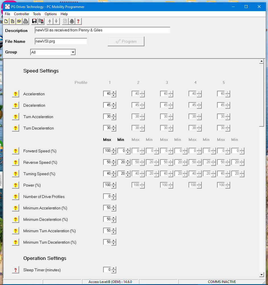

Postby Darrell_LeRoy » 21 May 2021, 23:01
The attachment OEM-Program.png is no longer available
Darrell_LeRoy
Posts: 13
Joined: 08 May 2021, 22:54
Location: Roseburg Oregon

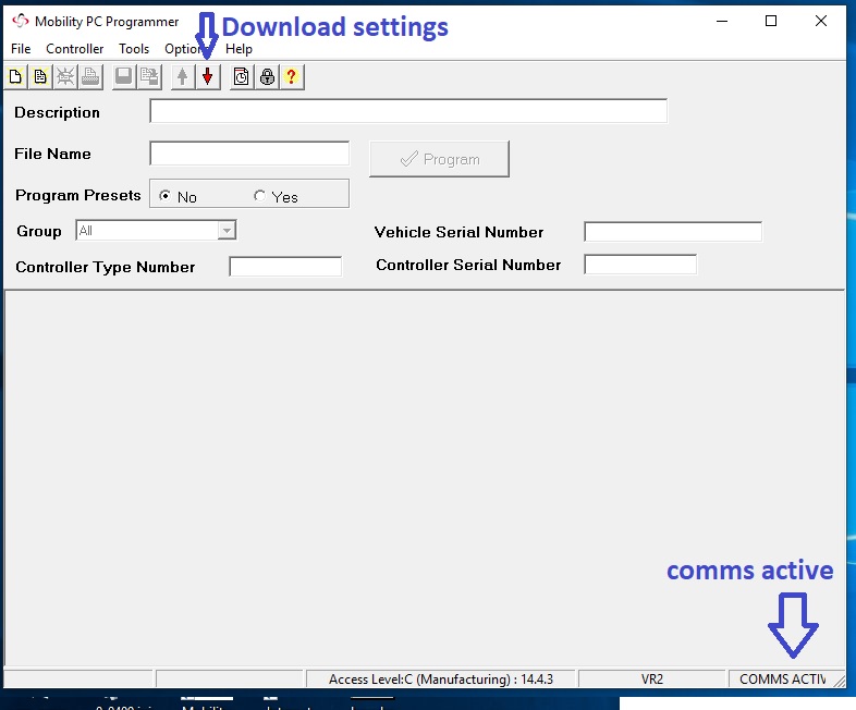

Postby woodygb » 21 May 2021, 23:05
That pic shows the software's built in settings template for a NEW Vsi .
COMMS INACTIVE bottom right hand corner.
Postby Darrell_LeRoy » 21 May 2021, 23:23
How do you make the comms active?
Darrell_LeRoy
Posts: 13
Postby woodygb » 21 May 2021, 23:26

Postby woodygb » 21 May 2021, 23:33
IF you have a NEW cable made AND you know the COMM PORT number assigned by Windows to your cable AND it is a number between 1-8 inclusive THEN
plug the XLR into your chairs pod ... and TURN YOUR POD ON .
Start the the PC Software ...select the correct comms port number and you should see COMMS ACTIVE.

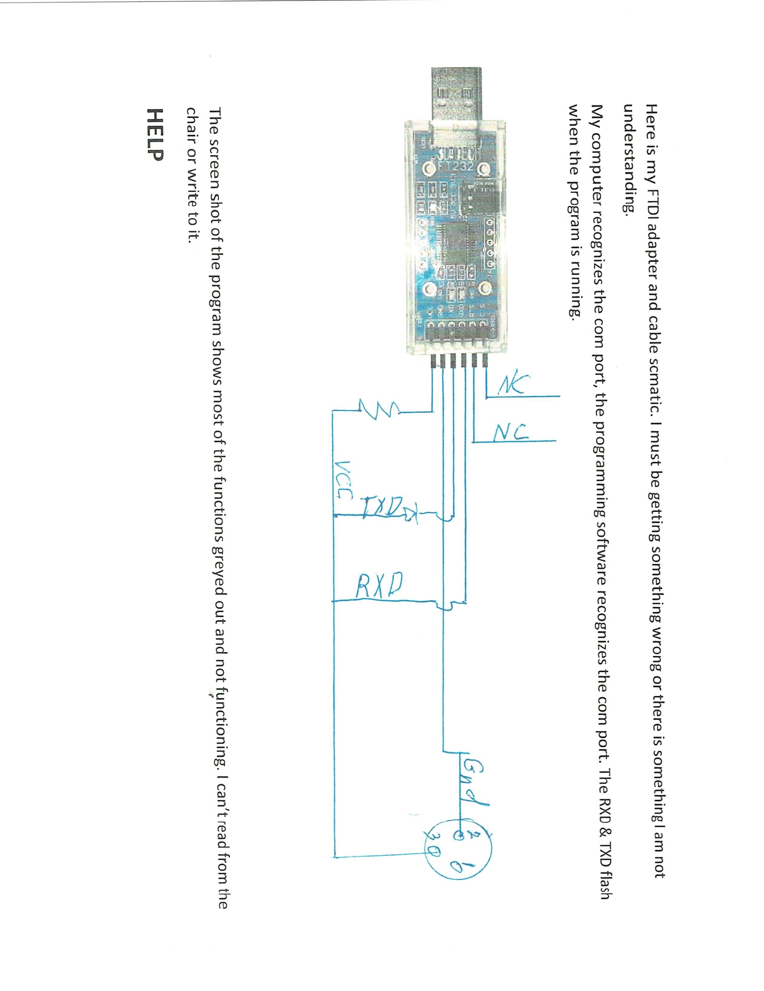

Postby woodygb » 21 May 2021, 23:50
BTW ..Your wiring looks correct and the FT232 board that you have chosen could work.
Did you use a schottky diode and a 47k resistor?
Postby Darrell_LeRoy » 22 May 2021, 00:32
I did use a Schottky diode but I didn't put a 47K resistor in and have not connected the VCC line as it was not connected in several of the diagrams.
I have ordered the resistor and will add it to the circuit.
