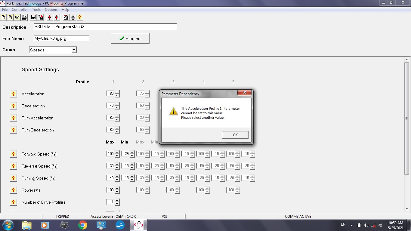

Well, partial success. I added the 47K resistor to my cable, plugged it into my chair, turned on the chair, loaded the program (Mobility Std 14.06.0 OEM), and the comms went active finally.
Now the problem is that I can't change the turn acceleration above 80. I can't make the recommended changes to the chair settings.
Do I need higher-level programming software?

Postby Darrell_LeRoy » 25 May 2021, 19:15
Why do I get this message and how can I bypass it and set acceleration higher?

Postby rover220 » 25 May 2021, 19:22
Further down the page should be oem factory settings iirc, check what they are set at.
Postby Darrell_LeRoy » 25 May 2021, 19:30
I don't find any OEM Factory Settings.
How do I find them?
My chair is a Jazzy 1121 and I am using Mobility Programmer OEM Std 14.06.0

Postby Darrell_LeRoy » 25 May 2021, 20:46
I was using the wrong program. I was using Mobility OEM Std 14.6.0. I should have been using Mobility Programmer Man Std 14.4.3.
Now I have all of the settings.

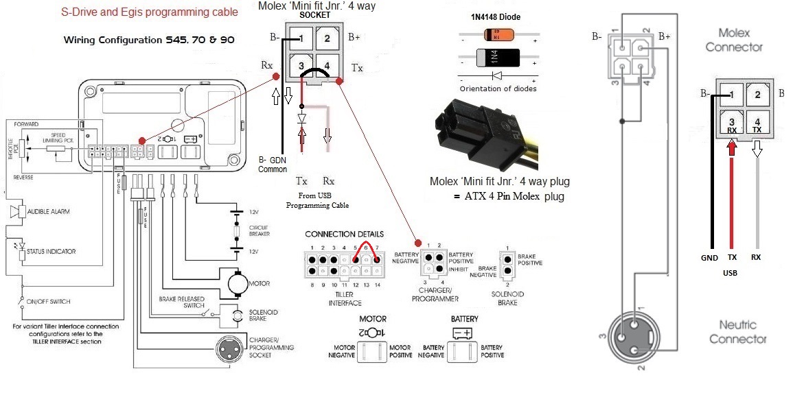

Talking to a S-Drive
Used a cheap USB/TTL converter from ebay
"FTDI USB to TTL Serial Converter Adapter FT232RL Module 5V and 3.3V Arduino ARM"
Cost me a whole 3.10 GBP
Already had a 47k resistor and 1N5711 Diode
Wired as per previous images, set to a 5V signal (via jumper on the converter)
The only Issue I had is that being a scooter it didn't have the molex connector fully wired (and I was connecting via the XLR as I had a spare plug for it). I bridged pins 3&4 on the molex and all worked fine.

I doubt that you will find one.... BUT the wiring is fairly universal.
What exactly is your problem ?
Note that an ON/OFF link is shown in this first pic .
sdrive con.png (17.84 KiB) Viewed 7675 times

Thanks for the drawings WoodyGB I was looking at the possibility of using the charging port as a programming port. On my Apex Rapid there is a green wire connected to pin 3 of the molex and I wondered where it is connected to. It joins the loom and connector to the tiller but without taking everything apart I can't identify that part of the circuit. I don't want to dismantle everything and so the request for a detailed circuit diagram. If one is not available then I will just continue using the molex plug direct. Thanks again.
EricSJ
Posts: 5
Joined: 28 Jul 2021, 16:49
Postby woodygb » 01 Aug 2021, 15:02
It is normal to have the programming pin connected to the pin 3 of the Charging Socket.... and YES , you can use it for programming.
You can see this on the right hand side of the pic.
Did you obtain the software?
Postby woodygb » 01 Aug 2021, 15:18
Use a multimeter and perform a continuity test between the Molex Pin 3&4 and Pin 3 of the charging socket..
