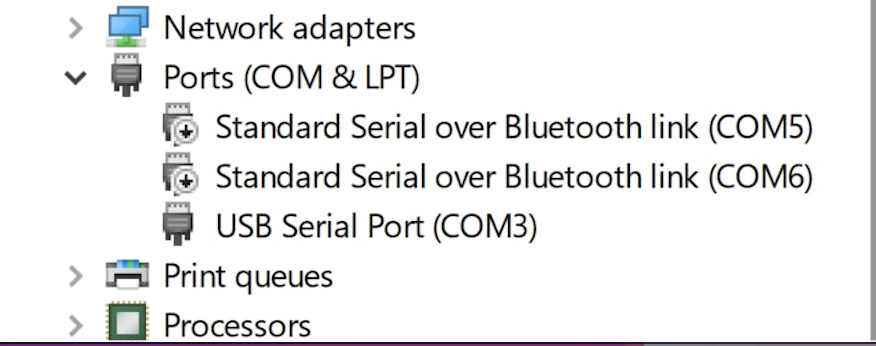

Postby Scooterman » 13 Apr 2022, 12:24
The CCS ports box gave the option of AUTO, COM 5, COM 6.
But the PL8 dongle connects to COM 3. (I remember now that it always used to show COM 3 in the CCS box)
So I disabled COM 5 and COM 6 and thought that would fix the problem.
It does partially in that CCS now only gives option of AUTO or COM 3.
But I'm still get CRC fault and no data from PL8.

Postby Burgerman » 13 Apr 2022, 14:48
Go to the top of device manager.
In the drop down boxes you will see SHOW HIDDEN DEVICES.
Now go down the tree and expand every item.
DELETE every single item that is greyed out... Will take a while
Now plug in the USB dongle FUIM3 and see what port it is using.
Now set the PL8s CCS to THAT port.
Now RESTART the PL8 and the COMPUTER. And finally open the CCS.
If you chose the correct port now load all the presets and say ready to start!
If not, throw away the USB cable and test again.
If still no connection turn the FUIM3 connecter 180 degrees and replug into the PL8 and reopen the PL8 CCS software...

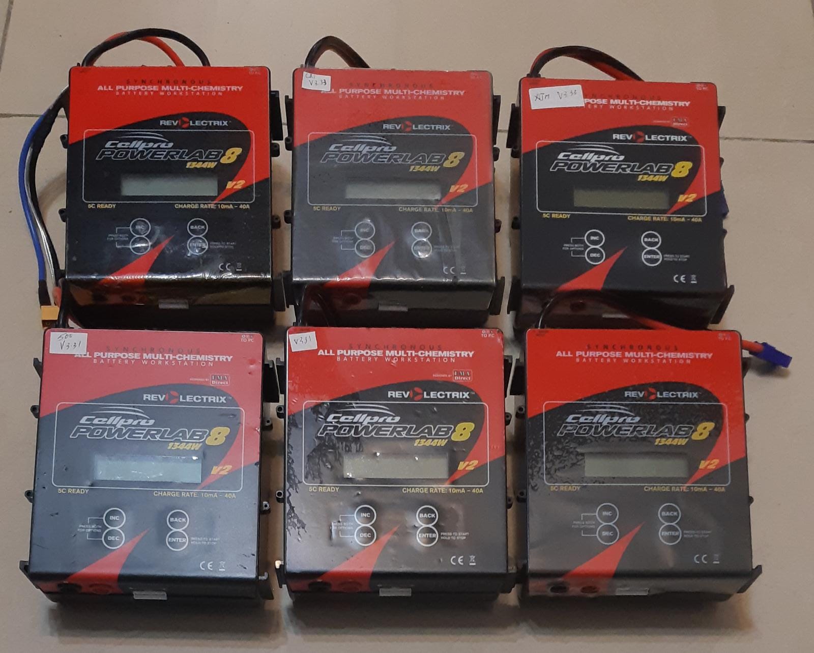

It's been a long wait for an update in seek of used PL8, due to COVID outbreak in Hong Kong and China. cheers
Postby shirley_hkg » 19 Apr 2022, 12:27
I have 6 used PL8 ( and 2 more on the way) , 2 FUMI3 to offer to this forum . They are either version 3.33, or 3.31. All seem to be slightly used (not a scratch of the buttons), and protective film are not peeled off. Cosmetics 7.5/10 or above.
I did check and test all units by loading a BM's preset, and charged @25A for 15 mins , EXCEPT updating firmware versions.
This Taobao extension for used stuffs has little protection for buyer. Due to soaring Chinese ¥(even stronger than USD $) and risk justified, price will be up a bit than expected.
① Version 3.33 @USD $130.
② Version 3.31 @USD $100.
③ FUMI3 @USD $15
④ Version 3.25 @USD $90.(only one)
Shipping of 1500g by registered surface mail @USD $16.(slow boat)
⑤ A few extension boards are available too. A piece of good tools one should grap.. Add USD $14 for the extra shipping weight, if you want an extension board.
Please let me know if you're interested.

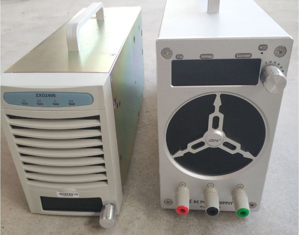

Postby shirley_hkg » 23 Apr 2022, 02:41
fishinjunky wrote:I didn't realize the ZXD was that compact. I can see the size compared to the PL8. .
No. You still haven't. It's 40% slimmer (without the aluminum outfit) in its stock case.
