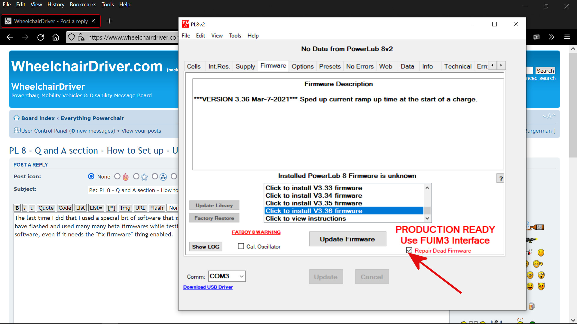

Ah yes, that would explain why it failed. Have you tried recovering it with the standard 1m USB cable that comes with the FUIM3? I'm sure it can be recovered.
Postby Burgerman » 18 Jun 2022, 16:37
You may need to ty a dozen times, but i should always be possible.
Postby shirley_hkg » 22 Jun 2022, 01:13
Any particular sequence would you recommend ? beer
Postby Burgerman » 22 Jun 2022, 02:10
The last time I did that I used a special bit of software that is meant for flashing firmware on all kinds of things. And I cannot remember what it was called. I have flashed and used many many beta firmwares while testing with the beta testing teams. Long ago. But you should be able to do it with the normal PL8 software, even if it needs the "fix firmware" thing enabled.
Although I never had to use that. I just did it as per normal. It was power cycled, seen correctly in the device manager as port 2 and 3 in my case. You need to disable one of thee two ports if it doesent work. One at a time, and restart everything before trying again. It MUST write to the correct port.
Then it should work normally again. If a firmware update fails, the boot loader is not affected. So it should be recoverable.

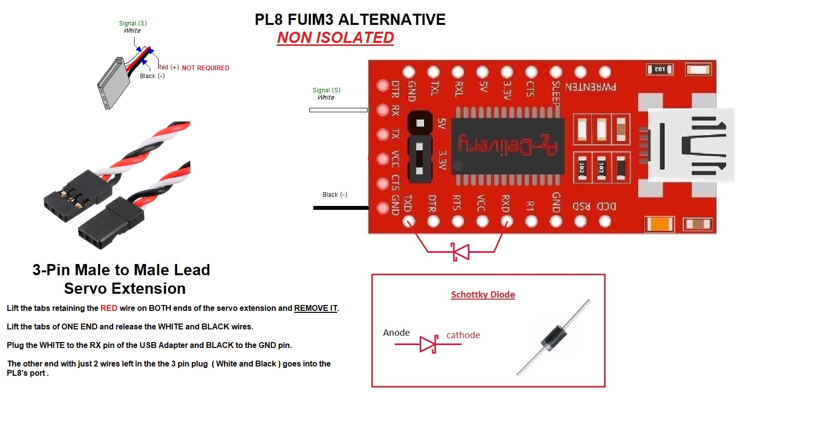

Looking forward to your FUIM3 clone.
I have ordered an Optically Isolated USB-UART Adapter from ZeptoBit and will test when it arrives.
https://zeptobit.com/index.php?product=7
In the meantime I tried a standard non optically isolated USB-UART Adapter with the addition of a Schottky diode.
https://www.amazon.co.uk/AZDelivery-FT2 ... 0753H4SQS/
This appears to work just fine.

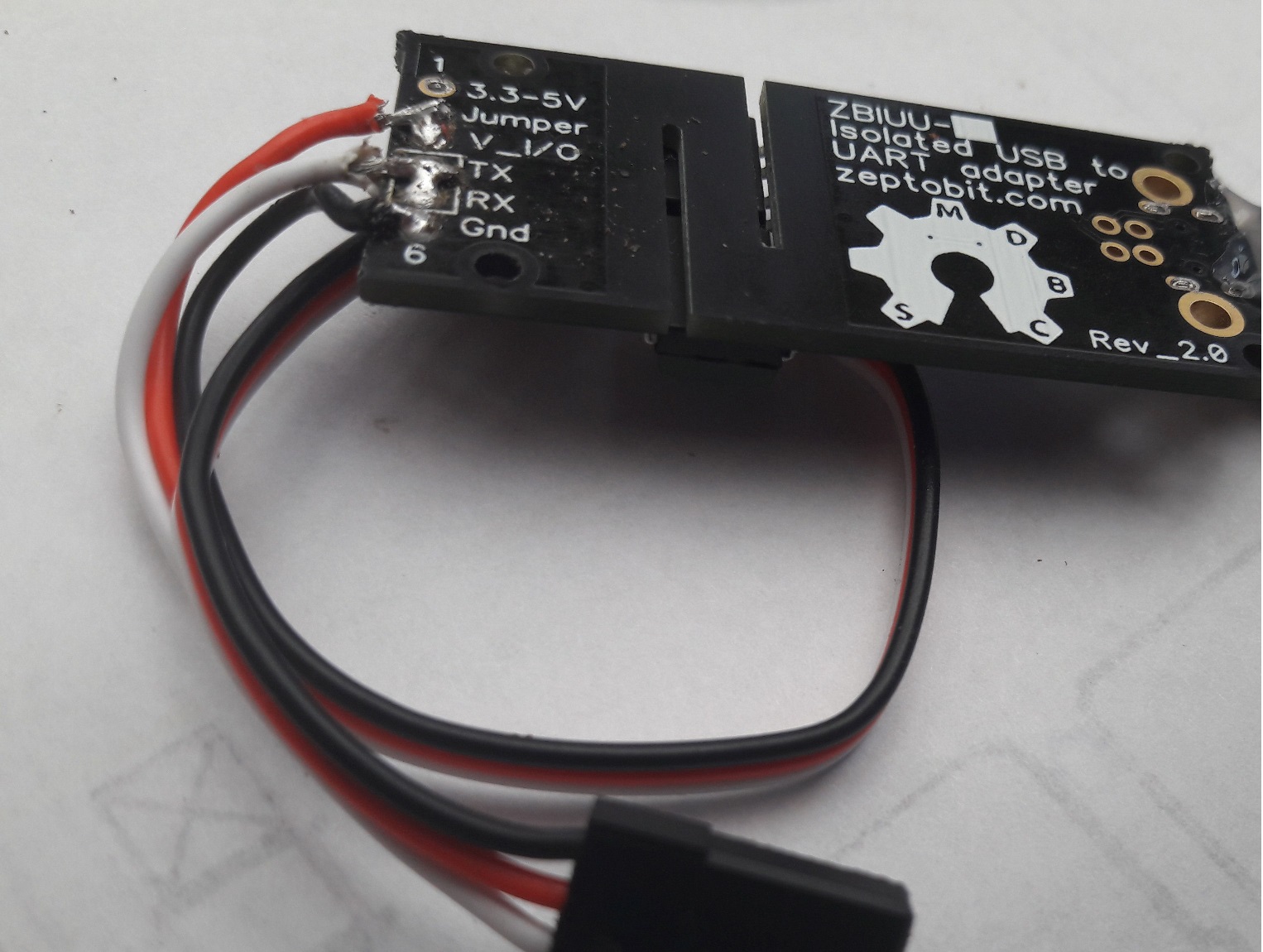

The Zeptobit Optically Isolated USB-UART Adapter arrived and has been tested.
It works fine without any additional components, it just needs the soldering on of the servo extension lead.... I believe that this is the closest that one could get to the original FUIM3.
The version that arrived has 6 contact pads not 8 as shown on the web page .
Pad 1 [ 3.3 - 5v ] is not used .
Pad 2 [ Jumper ] and Pad 3 [ V_I/O ] are both connected to the RED positive wire.
Pad 4 [ TX ] and Pad 5 [ RX ] are also both connected and go to the WHITE signal wire.
Pad 6 [ GND ] is connected to the BLACK wire.
