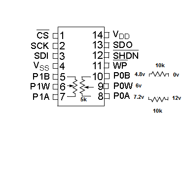

Still seeing if I can use the existing digipot to output the 6v centre and 1.2v-1.3v swing... the spec sheet suggests that I may not be able to use it.

Re: Plug & Play PGDT R/C
Postby woodygb » 26 Feb 2014, 09:01
I had hoped that adding a pair of resistors to my digipot thus would do the job.
Seems that the digipot doesn't like the voltage differences that are now present between various pins.
Absolute Maximum Ratings †
Voltage on VDD with respect to VSS ............... -0.6V to +7.0V
Voltage on CS, SCK, SDI, SDI/SDO, WP, and
SHDN with respect to VSS ...................................... -0.6V to 12.5V
Voltage on all other pins (PxA, PxW, PxB, and
SDO) with respect to VSS ............................ -0.3V to VDD + 0.3V
