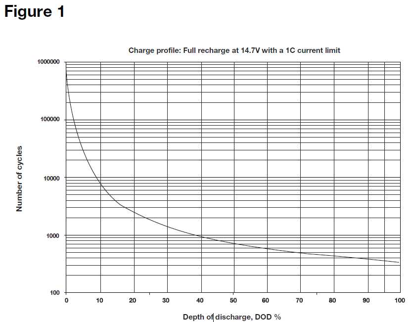

Postby LROBBINS » 15 Jan 2019, 16:40
To put some authoritative emphasis on what Burgerman has said about discharging lead batteries as little as possible, here's a graph taken from the Odyssey technical manual. It shows cycle life after repeatedly discharging to a given depth of discharge and recharging with proper charge profile for the Odyssey (a higher voltage than for gel. The more you discharge the battery before recharging, the sooner it will die - by a LOT.

Re: PINNED - Powerchairs Worthy of Consideration List!
Postby Mechniki » 15 Jan 2019, 17:16
thanks guys
So in reality, mine I don't sit in the same place too long, I move about, do other things, go outside for a cancer stick. Is it a good idea to keep the AGM batteries on charge when not moving and pull the charger out before it has fully recharged. See generally I only charge my Roma at night, as it charges next to my bed. I use a manual wheelchair if I need the bathroom overnight, Voyager Hoist

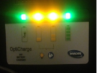

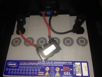

Postby Mechniki » 16 Jan 2019, 00:01
Apologies BM my given information was wrong about the Spectra, I just finished putting the batteries back in, to check what type of battery and found something I didn't know AS THEIR ~'#@# Engineers (AJ M Healthcare) put the wrong Ah battery in
The Opticharge is the charger for it
it is supposed to maintain a constant charge
opti back.jpg (40.75 KiB) Viewed 81079 times
Mechniki
Posts: 272
Joined: 22 Oct 2013, 21:59
Location: Dorking, Surrey

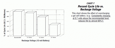

Postby Burgerman » 16 Jan 2019, 00:45
That charger claims to be able to charge both GEL which you have (had since they are now toast). And AGM. Which tells me that its junk.
It is trying to be all things.
It cannot know what battery is attached.
A gel battery wants between 13.8V and 14.1V maximum, as it charges.
An AGM battery wants between 14.4V and 14.8V as it charges.
Most of those types of chargers that claim to charge gel and AGM are fixed at 14.4 to 14.6V. What that charger does is TWO bad things.
1. It undercharges. You need to keep charging overnight, and longer. Esp so as its just 3A! You charge till current falls to a very low level (lower than that charger allows) and then it drops the volts to 13.6V per battery. And thats when the green comes on. 6 to 10 hours later its REALLY charged.
2. Its TOO HIGH VOLTS! Charging at just 0.7V too high removes 60% of your batteries service life.

Postby Mechniki » 16 Jan 2019, 10:16
I do think the Spectra' batteries are toast. Been monitoring them without the charger being plugged in since 7am, and they lost nearly a volt . so discharge without load

Postby Burgerman » 16 Jan 2019, 11:01
They charge at 14.1 volt. or 14.4V. Likely the wrong one...
They then float on the charger at 13.6v. Indefinitely.
When removed, they will drop over time to 12.85 eventually IF FULLY CHARGED. But lower if not. Were they on charge for at least 24 hours? Its a THREE AMP charger, and the float after the green light continues the charge. So leave them on for a full day.
But if you have not been doing this, for say 12 to 16 hours, then they are likely ruined by now anyway.
Also your photos are too small... Cant see any details.
