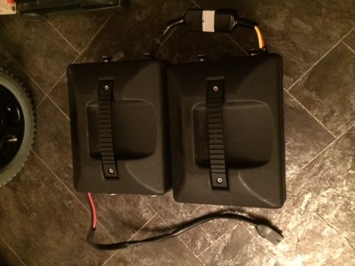

Postby gordo » 20 Feb 2016, 16:46
Recently purchased a quickie rumba (with a CTE 4C24080A 24v charger) for my wife. We chose it because we can fold it up and put it in our car. I want to purchase (or construct) an off-board charging loom to connect the batteries directly to the charger so we can leave the chair in the car and bring just the batteries into the house to charge overnight. I need to know how to wire the cable and a source for the connectors. Contacted Sunrise but they claim they can't help. Can anyone point me in the right direction?
gordo
Posts: 2
Joined: 09 Feb 2016, 20:16
Re: Where to find everything powerchair related
Postby Burgerman » 20 Feb 2016, 16:51
Do you bring these in one at a time?
And seperate connections that you can see?
Best bet is to charge them with a 12V charger in series as its healthier for the batteries. Something like a Ctek 7A one would do it if you are not in a hurry. But your 24V charger will be fine as well as long as you know whet to connect to where?
Posts: 71111

Postby gordo » 20 Feb 2016, 19:00
They come in together. Two 12V batteries connected in series. Connector is black.
gordo
Posts: 2
Postby Burgerman » 20 Feb 2016, 22:10
That doesent make it simple. But you will likely need to take off the lids, fit a charge connector on each battery. Then leave it somewhere that you can get at its connector more easily. Its quite simple to get 2 blade terminals that fit that connector. But its also easy to connect it in reverse if you are not careful.
Do you understand what it meands to charge in series or parallel?
Can you make up a couple of cables? With ring terminals that fit the battery and a connector to plug into a charger cable?
Posts: 71111

BM, aren't the batteries join in series via the grey anderson? If so, then why don't gordo buy a dual bank 12v charger, fit 2 andersons to that and when he wants to charge them, just pull the andersons apart on the battery and plug in the charger with the 2 andersons.
Postby Burgerman » 20 Feb 2016, 23:40
That will connect only one battery. He wants to use the charger he has. And any cheap 12V charger would charge in parallel if that anderson link was undone...
Posts: 71111
