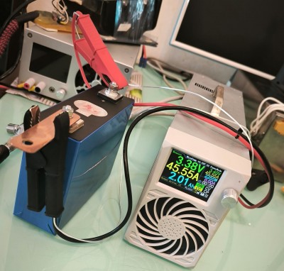

Postby shirley_hkg » 18 Oct 2025, 04:24
Make yourself a 4-wires alligator charge leads, and enable the 4-wires output mode.
Now you can charge / balance your cells at 50A max. Super useful with initial cell balancing when you put them together.
Re: PINNED ZXD2400 Old + New 0-60V 0-50A Power Supply & Char
Postby Burgerman » 18 Oct 2025, 10:14
Yes charge single cells with ZXD directly. Because 50A! And its voltage is accurate. You dont even need those 4 wire connections! Its good anyway.
Worst it ever gets is 1 hundredth of a volt out! Tested two ZXDs. As I have 2.
Posts: 71119
