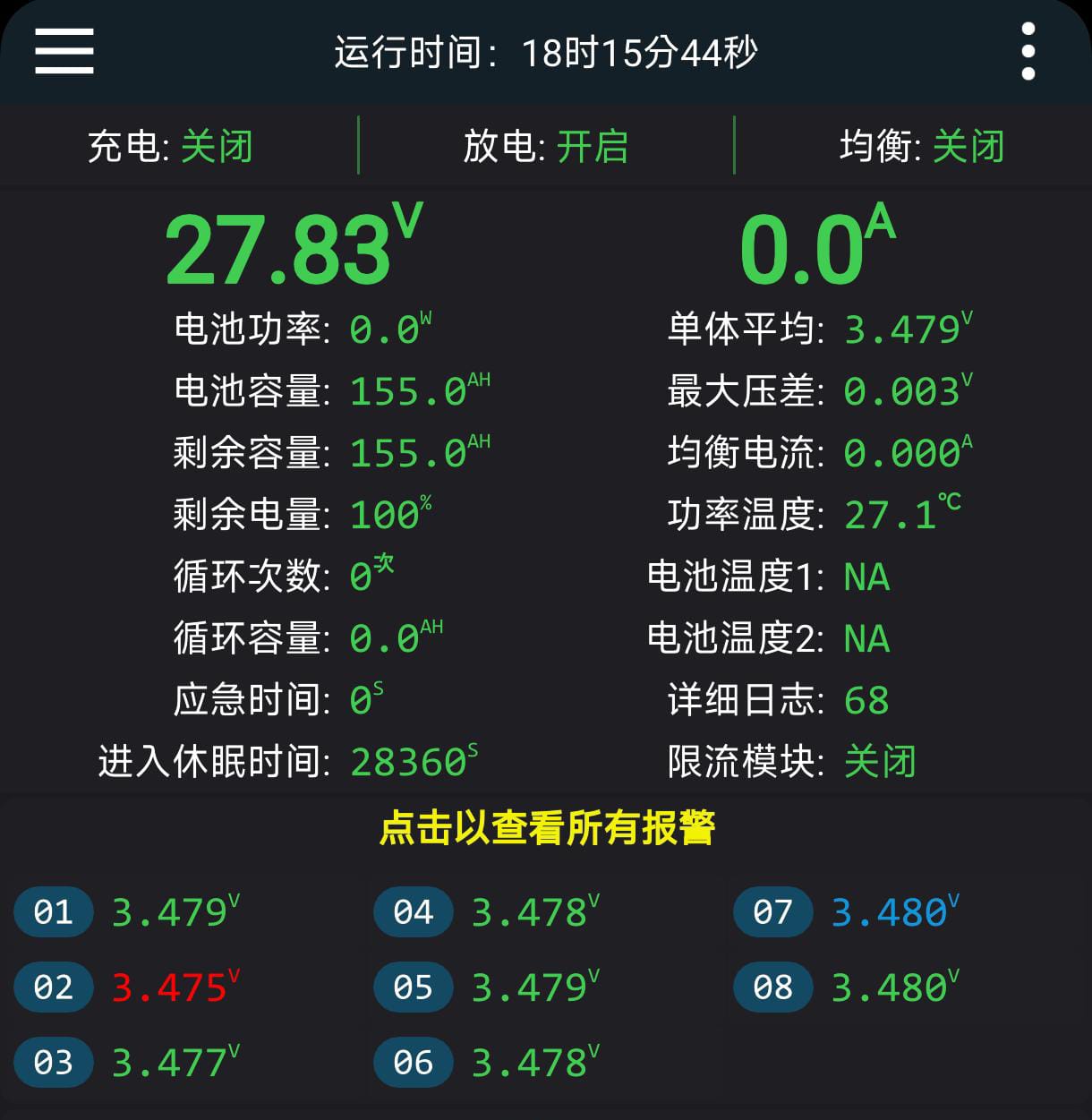

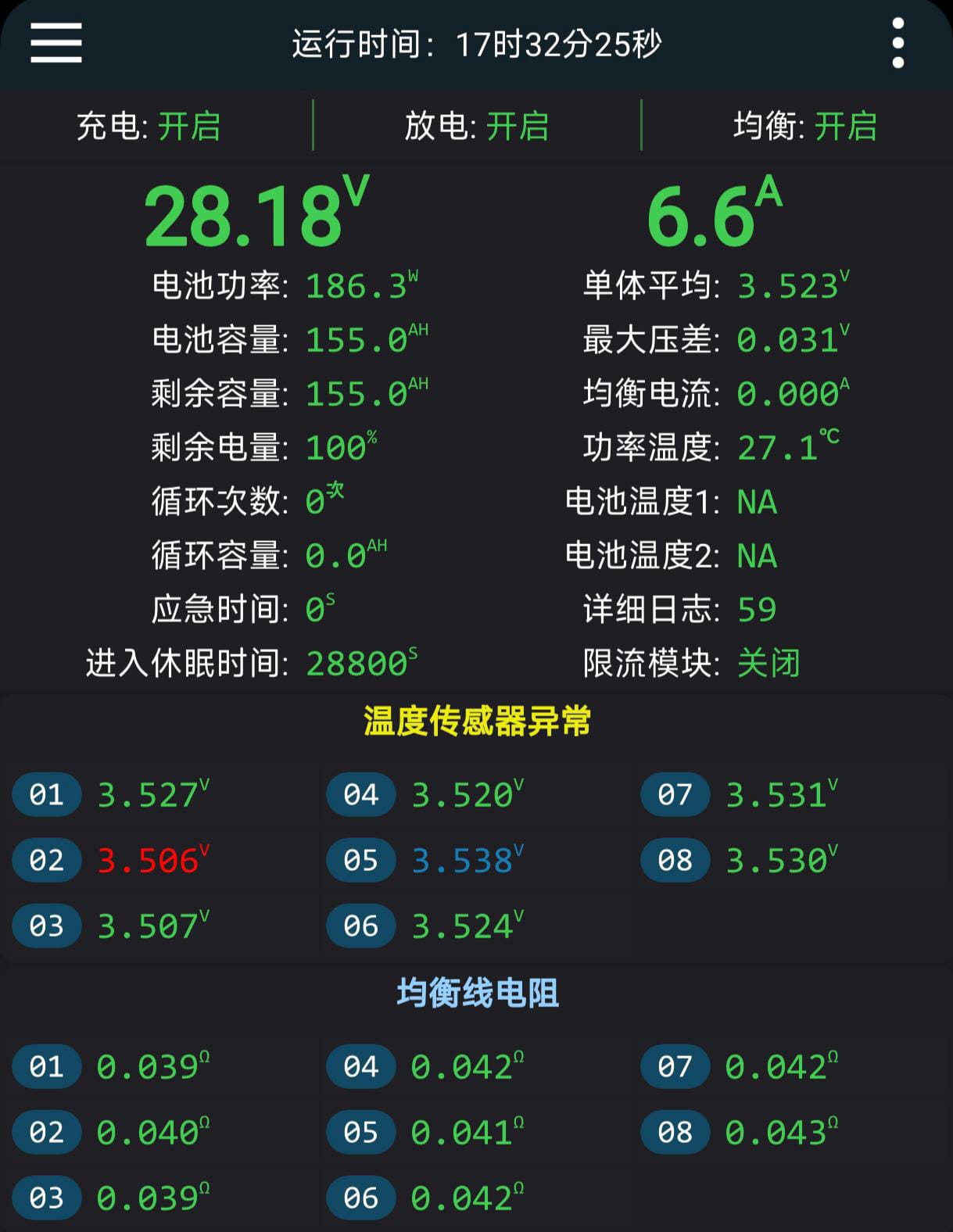

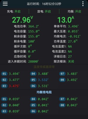

Pops up during charge???? I don't know what you mean, please explain!

Postby Burgerman » 03 Jan 2026, 10:48
That looks about right. I would leave those settings for termination as they are. Can you also set a CV time limit on that charger of say 2 to 4 hours. Just in case it doesent drop to 1A at some point?

Postby Burgerman » 03 Jan 2026, 11:37
He means that if theres a bad connection somepace or a bad high resistance cell, that the voltage of that cell appears higher. Like it does when the voltage "pops up higher" at the end of charge past 3.45V upwards on a full cell. That cell will appear full sooner and then take a long time to end charge.

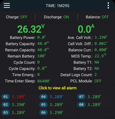

Postby shirley_hkg » 12 Jan 2026, 08:09
Doing a 150@Ah pack for 22NF battery space.
Finished measurements are 275x202x222h.
A grade cells, zero gap in between, with 0.4mΩ IR cost £250 including a BMS.
All came in with identical voltage 3.289v, and I put in 112.32Ah for the initial charge.
Posts: 4657
Postby shirley_hkg » 12 Jan 2026, 08:21
They are literally balanced during the first charge. Than 1a balance BMS took just 40 mins to bring voltage difference down to 31mV. 3mV in an hour later.

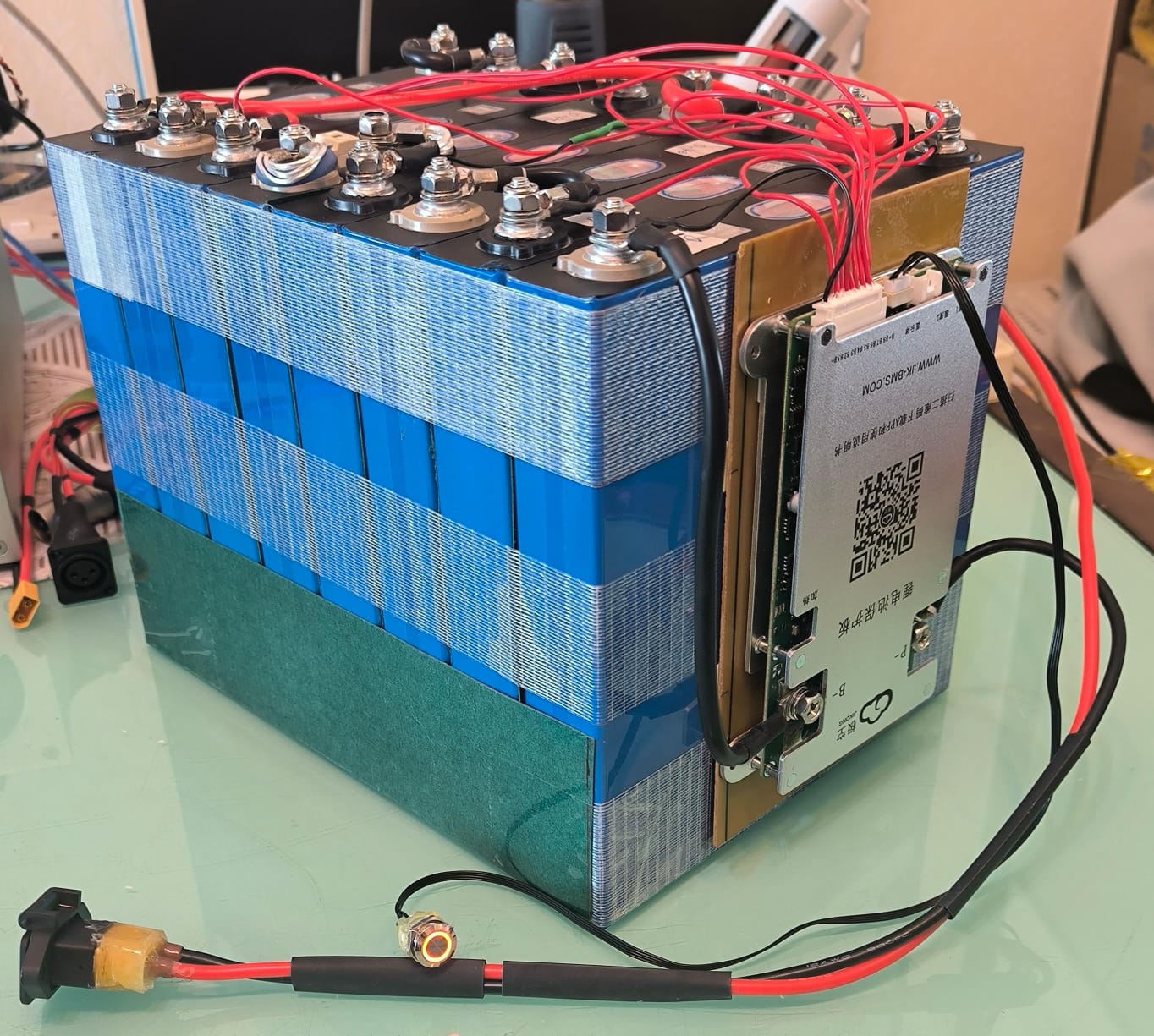

Postby Raro » 14 Jan 2026, 18:35
Hi Shirley, I wanted to ask you a few things. Besides the charging connector that looks like an XT, what is the other switch with the illuminated circle for? What is the blue wire with three small white wires screwed into the same terminal in the cell where the fuse is for? I've always understood that it's better to use the BMS only for charging, but here it's integrated into the package. Could that cause problems? I'm asking from a place of complete ignorance; I just want to understand.

Postby Burgerman » 14 Jan 2026, 23:12
I might help...
Its an ON/OFF switch for the BMS.
Charge only? You you can. Then the BMS safety protection stuff will never trip.
If you choose a BIG enough BMS that can do 200A or more pulse and its decent quality that really CAN reach that, and it a good enough one that allows a LOT of configuration, you can just set all its parameters in a way that they will never kick in and stop the chair. Which means that they no longer serve any purpose... So why have them? The JKBMS is probably the best bet.
Your choice!
The white thing with white wires is an 80A mid pack fuse. I would use 125 but thats because I am a hooligan and I know can pop 80A fuses at will. I have no clue what that oddball extra blue/white loop is for. Doesent appear to do anything.

Postby shirley_hkg » 15 Jan 2026, 04:33
Burgerman wrote:Your choice!
That's redundant and irrelevant. Ignore it .

Postby Raro » 15 Jan 2026, 17:09
Then you can turn off the BMS with the button and it no longer interferes with the chair's operation; to charge, just use a charger or power supply like the ZXD, which seems great to me.

Postby Burgerman » 15 Jan 2026, 19:11
If your chair is wired from the BMS as intended and you turn it off you dont go at all.
Posts: 71101
Postby Raro » 15 Jan 2026, 19:29
Could the chair be connected directly to the package and the BMS disconnected somehow when the chair is in use? I mean, installed on the chair with some kind of switch...

Postby Burgerman » 15 Jan 2026, 19:38
You have 2 options
1. Fit BMS or (use it externally) to charge only. The battery in both cases would use a 125A fuse and connect to the chairs controller directly.
2. Fit as intended, then set 101 setings to never interfere or do anything.
Posts: 71101
Postby shirley_hkg » 16 Jan 2026, 04:09
Raro wrote:Could the chair be connected directly to the package and the BMS disconnected somehow when the chair is in use? I mean, installed on the chair with some kind of switch...
You don't even need an extra switch to do it.
Simply connect your chair to battery terminals directly. Now the BMS is not in use for driving.
Remember to recharge the battery via the XT90 port ONLY.
Posts: 4657

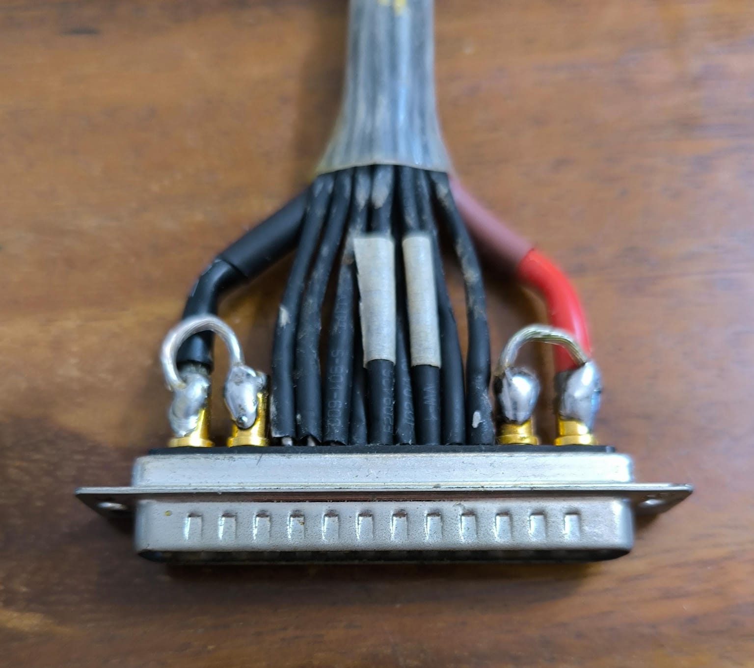

Postby White Lightnin' » 14 Feb 2026, 05:42
Somewhere on this website I've found a sequence of locations where the battery monitoring wires for the Pl8 have been soldered to the Sub connector. Can anyone tell me where it is?

Postby shirley_hkg » 14 Feb 2026, 09:45
Hope these help, but it could be very personal.
Belows are MALE Dsub.
Posts: 4657
Postby White Lightnin' » 15 Feb 2026, 01:17
Thank you two, both of you. As long as I know the order of the wires in the 9 wire plug going into the Pl8 I will be able to line them up going across the male and female Dsubs. Reliably finding that on the plug is my only problem now.

Postby shirley_hkg » 15 Feb 2026, 03:28
You can find pin assignment of current dsub with a multimetre or tester.
What are you attempting ?

Postby Burgerman » 15 Feb 2026, 12:46
Just set a multimeter to Ohms.
Measure pins at the PL8 end of the cable, and the opposite end. The one that reads a very low figure well below an ohm is the one you are matching. The rest will be open circuit. Do one at a time 1 to 9 and mark with a bit of tape and a pen.
