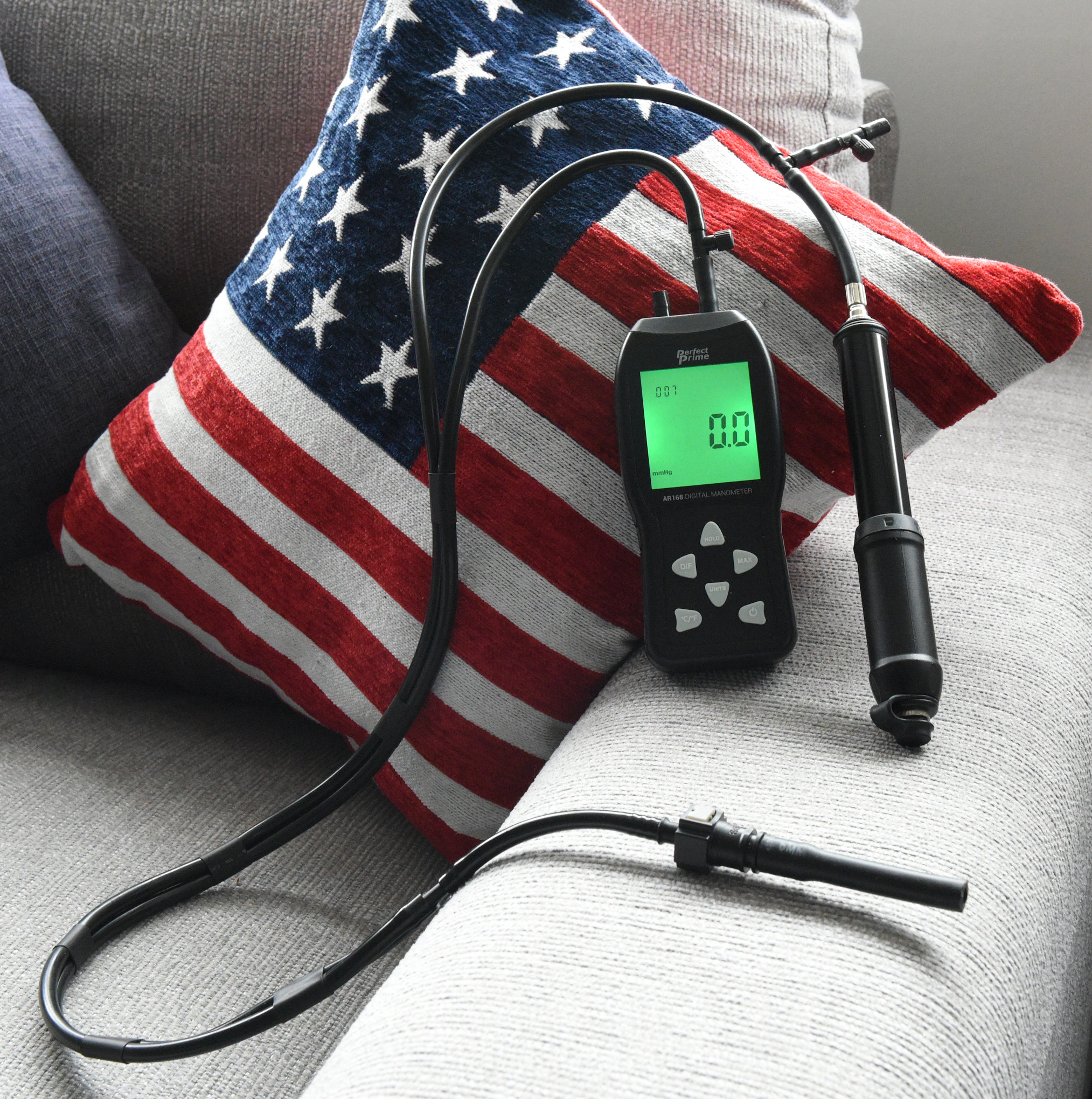

Postby Burgerman » 04 May 2021, 01:15
This is what I use to determine pressure as I sit in the chair. I madeit from ebay parts. It allows me to increase or decrease the pressure and watch it change as I release air ir pump more in.
Because of extensive "plastic bag with hand in it" testing on multiple days with 3 different carers, and averaging the results I can say that when I have 10 to 12mm between me and the chairs base, at my ischeal tuberosity bones, the pressure is 36mmHg when my arms are on the armrests. (42 with then lifted.).
So that now I can check myself, get it exactly right, as often as I want. On my own. With no plastic bag/hand testing.
With a smaller gap, say 5mm I can't test. Fingers are thicker! But you wouldnt want to. With a bigger gap, say 20 to 25mm, the presure is a lot higher. Approx 44 to 46mmHg. So aiming for a 10 to 15mm gap makes a lot if difference. Remember these are MY figures for my backside on my cushion. You will need to determine your own from the hand tests.
You cannot do this without a quality pump. The one supplies isnt good enough. And you need a couple of adjustable valves, a T, and a quick release "fuel" connector so that it works as an airtight swivel to allow easy use of the cushions on/off valve. Test with the ISO valve on the cusion open. Lock it when finished and yourself in the correct position.

Postby Burgerman » 04 May 2021, 12:39
It could be if you aready have one. But 4 things. The smartcheck doesent tell you the range of pressures that it deems OK. And it must be very large as even lifting an arm make a pretty big difference. It also doesent tell you the actual pressure. And so you dont know if its well above or a safer below 25 to 35mmHg. And its way more expensive too. And I dont think many would want to cut their cushion...
This way you dont have to.

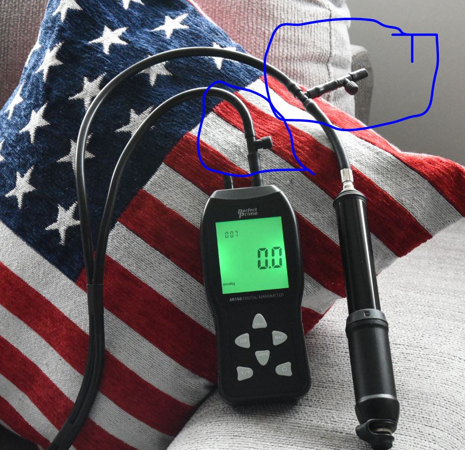

BM, I refer to the picture where I marked in blue. Are these adjustable valves? Can you please explain how they work? Where can you buy it? Thank you.

Postby Burgerman » 10 May 2021, 14:37
EBay 4mm valves used for aquarium stuff. Cheap. The tube is also 4mm aquarium. The part that goes onto the cushion is silicone 8mm.
The connector near the cushion is a fuel disconnect for motorcycles, from eBay. One half 8mm the other 4mm. So that it spins freely when attaching to the cushion on/off valve.
Be sure you get a GOOD pump or the air will escape slowly as you try to read the pressure after hand test. Mine's the 3rd different one I tried. I also added silicone grease to the pump.
The small valve near the pump ringed in blue, allows the pressure in the cushion to be lowered.
The one near the gauge is only cracked open a fraction. So as to smooth out the pressure changes as you move on, or pump up the cushion.
You may note that there are two long tubes joined by a T. The pump joins at the cushion end so that the pulses of pressure dont go directly into the gauge. As that may damage it - so it must go all the way up the other tube... The Small valve at the gauge also helps prevent this happening.

I wish this was commercially available to purchase. Im not sure if I could get it assembled correctly but I would really like to buy one. I have a couple ROHO smart check devices but they are really useless. If you ever decide to take a commission to build one I would pay in advance.

Postby Burgerman » 14 May 2021, 14:29
Its plug and play. I can give you all the links...

UPDATED!!! and refined after use.
Gauge no batteries... https://www.amazon.co.uk/gp/product/B01 ... UTF8&psc=1
Pump. https://www.amazon.co.uk/gp/product/B08 ... UTF8&psc=1
SW0789ID6 https://www.ebay.co.uk/itm/164492914906
M789ID4 https://www.ebay.co.uk/itm/164492914906
Tube plus fittings https://www.ebay.co.uk/itm/114426037677
BIG photo download/file.php?id=15573&mode=view
Valves https://www.ebay.co.uk/itm/264957842401 These need a little silicone grease on threads to stop them slowly leaking.
You need short bit of soft tube to fit onto roho. Its 6 or 6.5mm ID and I forget which so use existing bit, or order 6mm and 7mm just in case here. You may need to shop around. https://www.ebay.co.uk/itm/402693510356 for e.g.
This stuff varies. The correct size is already on your roho pump. You can use that.
You also need some small cable ties, heatshrink, or velcro strap to make it neat... Or insulation tape but that comes unstuck over time. I used heatshrink with care! With my picture above it will all become self explanitory. Not the cropped one!
Then waste a set of batteries and learn how the meter works. Learn everything it does. Learn how to turn on backlight. Learn how to set to DIFFERENCE rather than absolute, and learn how to zero it. So you can do it from memory easily. And then you are good to go.
Turn backlight on.
Set it to mmHg.
Set to Differential pressure (or zero it every time). Or the atmospheric pressure variation day to day will mess up the reults.
Make a lot of notes, on different days after setting with the hand test as low as you dare to go. Keep and date the figures you end up with. Helpers are very variable! Average the figures. Test with arms lifted seperately. And arms on arm tops seperately. It makes a huge difference. After a week you should have enough to get a good average - correct - pressure without the hand test.
EDIT:
My pump leaks air and pressure falls over time... So allows the pressure to fall slowly while you are doing a hand test. So:
https://www.ebay.co.uk/itm/283318275086
Cure, fit one of these directly after the pump. 3.8 to 4.8mm - I ordered 3 different ones to find out!
Or, These work too. https://www.ebay.co.uk/itm/183568499099
NOT - https://www.ebay.co.uk/itm/265108250161
