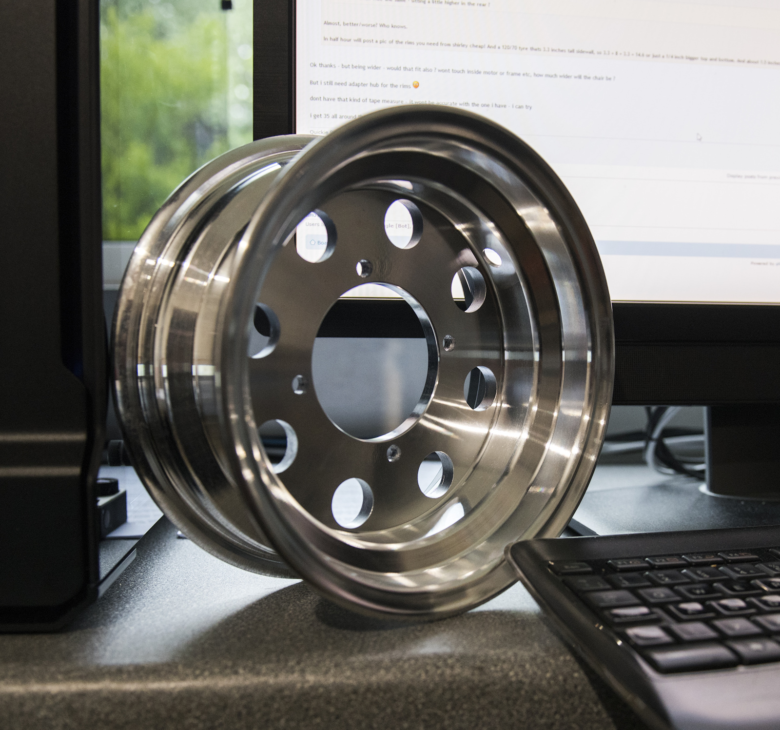

Yes. Only with a tube. At which point you defeated the purpose and any benefit.
Its the tubeless rim, and tyre as a unit that give the benefits. The bead holds tyre in place and means it is secure on rim.
youtu.be/FZQpdKq3HD8
Re: Punctures!!! Grrrrrrrr
Postby Burgerman » 20 Jun 2022, 01:35
Rim with step, or "bump".
wider TUBELESS rim like your cars wheel.

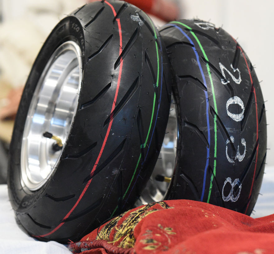

Stronger thicker high load and high speed scooter tyre of 120/70-8 fitted. These also have some liquid tyre sealer in just in case. That stuff does not work well in tubes. ALWAYS works without fail on tubeless tyres.
Postby Burgerman » 20 Jun 2022, 01:44
And they are a fraction larger in diameter by just half inch, and are lots wider.
From weakling with skinny tyres and tubes to bully. And stronger tubeless tyres with sealer.
Postby Burgerman » 20 Jun 2022, 01:49
Before and after (only rear tyres/rims. Front already swapped over...

120mm. In place of your stock "inch" width tyres. Whatever those are. So if they are 3.5 wide, you already have 3.5 x 25.34 = 88.9 or 90mm. So the wider tyres will be 30mm or about 1 inch wider each side after you reduce clearance a little between motor/tyre.
So is that too wide?
If so fit 110/80-8 tyres. And same another 20mm. Or almost an inch.
Or dont use buses...
Everything is a compromise.

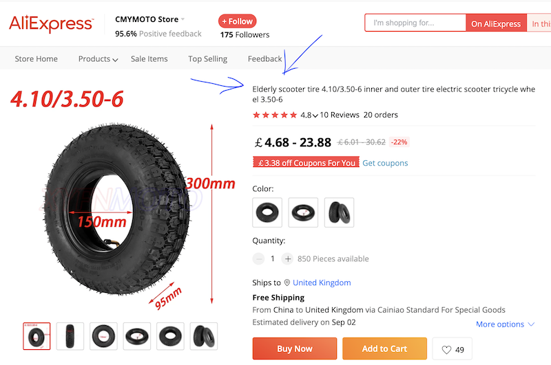

Postby Scooterman » 20 Jun 2022, 18:57
Bloody Cheek!!! :cussing
Postby Burgerman » 20 Jun 2022, 19:27
Beats me why they marked a 13 inch diameter tyre, meant for a 6 inch rim, that is 4.1 inches wide as 300mm x 150mm x 100mm because its not a mm tyre, and those measurements are wrong anyway.
