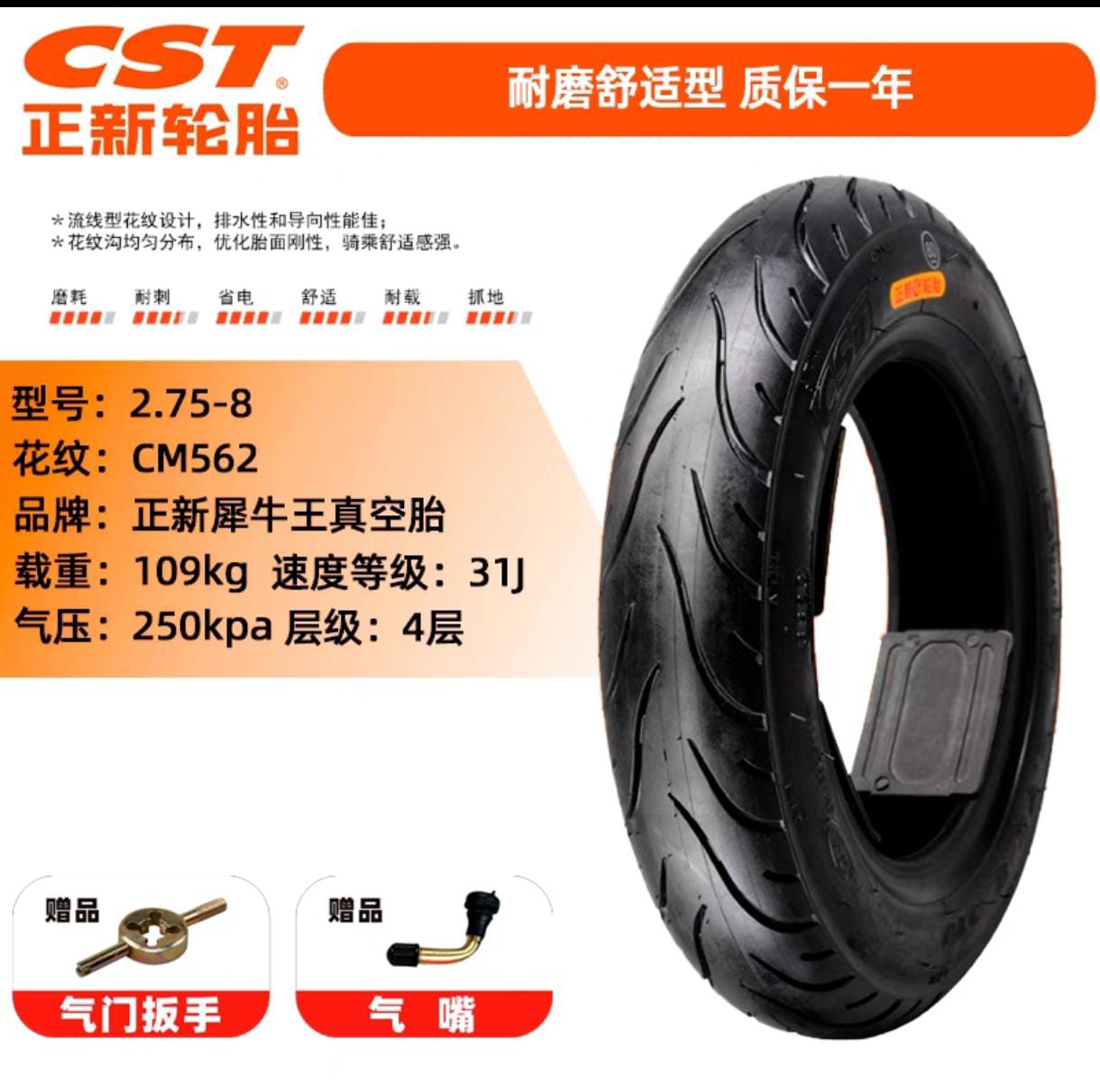

Postby shirley_hkg » 09 Dec 2024, 12:20
Low profile 2.75-8 too.

Postby Burgerman » 09 Dec 2024, 12:26
But even so, why?
Bigger width, lower profile like the 120/70 I use are much better. Ride, longevity, cross section, lower pessure, less likely to puncture as less ground pressure, and you need a tubeless rim/adapter anyway. So fit slightly wider while you are doing it.

Would these 2.75-8 rims work with these 3.00-8 tyres?
I'd like to duplicate the width and height I have now with Permobil's 3.00-8 14 inch tubed tyres but with tubeless.
If I were to proceed, I'd have to get an adapter for the 3 hole wheel hubs. Would there be a way to make sure the wheel didn't get any closer to the chair (to scrape against chair) or further out from the chair (to increase width of chair) ?
Or will the adapter always add some thickness and push the tyres out a bit?
jefferso
Posts: 350
Joined: 18 Jun 2016, 22:18
Re: Tubular Tyres
Postby Burgerman » 17 Dec 2024, 00:25
the RIM has 2.75 inches between its edges (the J part of 2.75J). Each rim edge is 1/4 inch. Now we have a total RIM width of 3.25 inches. With a tyre of less at 3.00 inches.
The perfect rim for that tyre size is 1.75 (as permobil use) 2 best to 2.5 inch absolute max. Will it FIT on a 2.75 rim? Yes. Depending on brand it will and will measure a little wider than its 3.00 inches. But the rim will look very wide compared to the tyre. It will stretch the tyre.
Best bet would be a 2 1/4 wide rim. Or 2.5.
