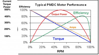

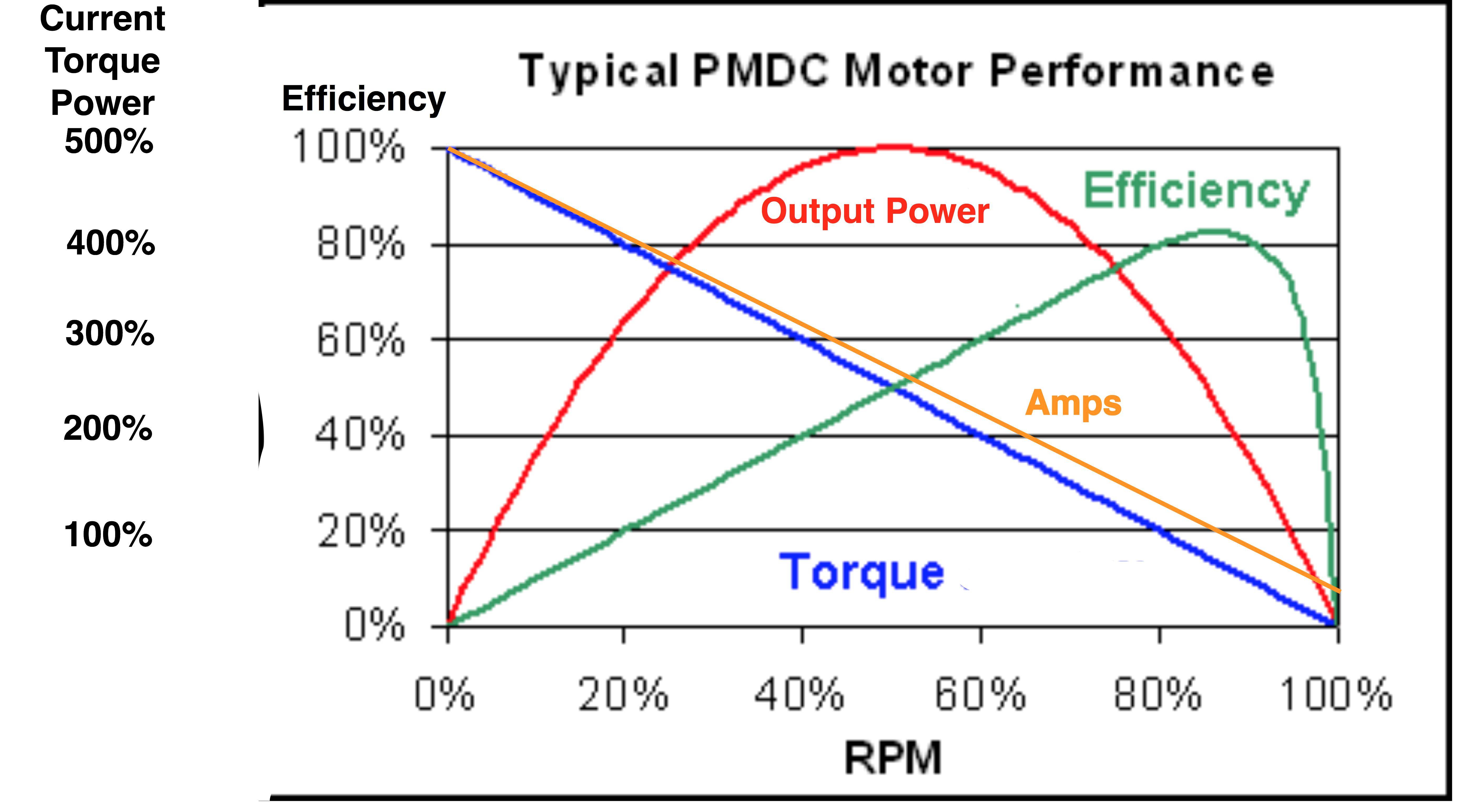

No. That is an unloaded RPM. In realty you get less. That tells us that they know a 2 pole motor has a higher impedance and less torque. So that it needs to have a free unloaded speed that is higher than the chairs target speed. Because the higher the impedance the greater the rpm drop under any given load all else being equal. In other words they will slow down more than a 4 pole motor would, pushing the same chair along. So your question now is: Will that still allow them to be faster with your specific chair, mass, surface gradient etc?
We cant answer that.
And remember that the larger the tyre the greater the load. Same thing as happens no matter how you change the gearing/speed relationship.
So a 4 pole motor will slow down less than a 2 pole one, as a percentage, with a larger tyre diameter used. Other things will also show a greater rpm loss on a 2 pole motor, such as a heavier user, chair or a slope, or with solid tyres etc.
So the real answer to your questions are only answerable by testing!
Look at the grapghs above. They aim to have the best efficiency peak, in use when pushing the chair at max speed. As they know that the load drops the RPM down to this point.
Re: Urgent advice needed: 4 pole or 2 pole motors?
Postby Burgerman » 15 Mar 2025, 01:36
So that best efficiency (best range) happens around 80 to 90% maximum speed.
They arrange this max efficiency point to coincide with the motors max speed in use (under load).

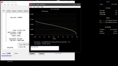

It says on the tin that they are 2.5mOhm, 3.5mOhm, 5mOhm etc. And so to measure this I cycle these new batteries (in accordance with the spec sheet by fully charging, 24h on float as well. Then at 25C in my room (as per spec sheet) I discharge at the 20H rate. (1/20th of its 68Ah rated capacity or 3.40 Amps). On the Oddysey for e.g. that is 62Ah when discharged to 10.80V or 68Ah discharged to 10.20V.
So I set the PL8 to discharge at 3.40A, expect it to take approx 20 hours, and it is programmed to keep discharging until it reaches 10.20V. At this point it stops, after drawing a discharge curve. If its as good as the manufacturer claims it will read 68,000mAh.
So its EASY to test a battery to very accurate levels.
Its also easy to compare this to the manufacturer claims.
I used to sell batteries, odyssey, optima, and the odd MK for years. So have tested hundreds.
You can even test them in series, in a powerchair via the XLR connector.
Heres one on a discharge test.
This was a 75Ah AGM battery. Its about 6? month old.
Its got about 10 mins to go, before it reaches the 10.8V per battery cut off point as determined by the manufactuere. That reached almost exactly the rated 75Ah at that time. So 100% as per spec.
So far its given back 74,023mAh or 74Ah.

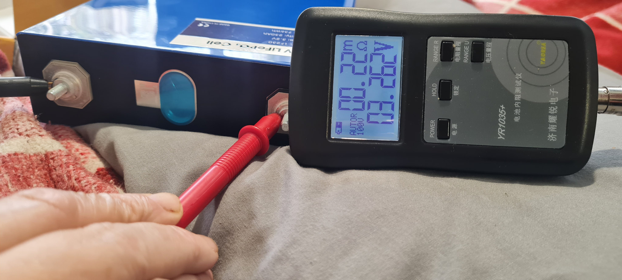

To measure and check the manufacturers claimed impedance figure you need a 4 wire 1000hz impedance tester!
This one is currently checking that my lithium cells were as advertised! And not used etc.
In this case these cells are supremely low impedance at a rediculously low 0.22 mOhm!

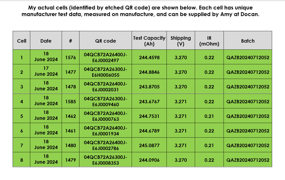

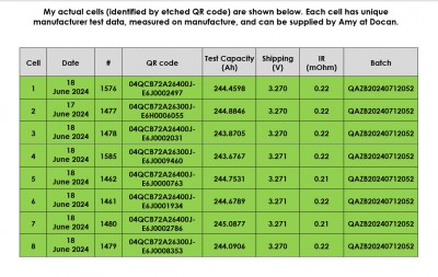

Here are the manufacturer specs for EACH INDIVIDUAL cell that I recieved.
When tested, every one was within 1 % of the cell spec in capacity, and within 0.005mOhm. of the factory spec. And thats basically within measurement error.
All were around 0.21 to 0.23 of a mOhm... czy
All measured 244Ah :o Which is pretty good for a set of 230Ah cells!

With the 64amp AGM of the new Q300R is there any specific recommendation of charging/discharging or it is the same as with the Gel batteries?
faico_26
Posts: 349
Joined: 14 Sep 2018, 12:21
Postby Burgerman » 15 Mar 2025, 15:57
Gel vary depending on design, But 29.0V CV, same 10 or 12A, 300mA termination point and 27.2V Float for 4 to 6 hours.

Postby faico_26 » 15 Mar 2025, 16:22
Thinking in NO damaging the AGM batteries of the new Q300R, making a full charge of 12 hours or so and then charging them every day would be enough?
Think that I’m just an average user, with only some knowledge of Rc cars and Rc planes but I have no clue about how to make a charge/discharge cycle in the wheelchair batteries.
