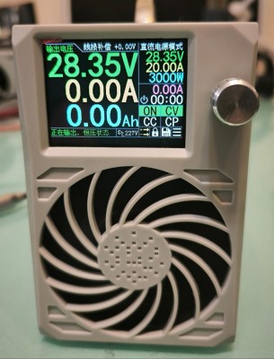

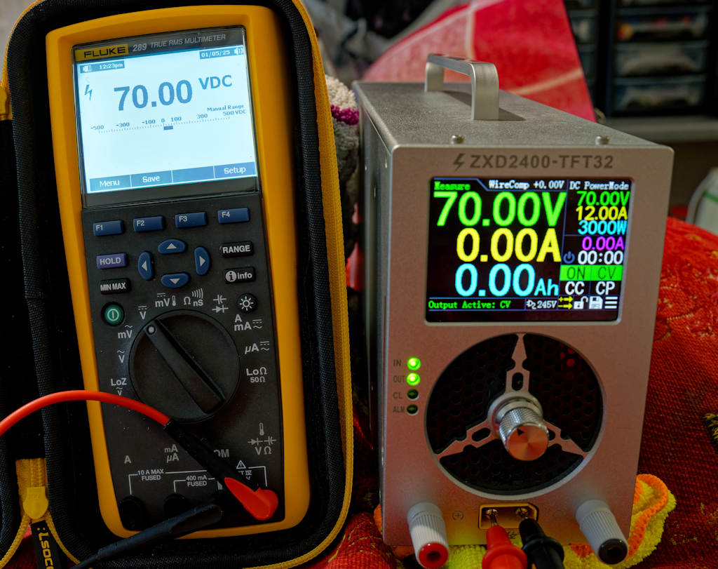

Use a ZXD set as lithium.
These are cheap. Built like tanks electrically for 24/7 telecom use, adapted to be a power supply by a group, ask shirley... I got 2.
Can be a simple user adjustable supply.
Lead Acid 3 stage charger that YOU can configure.
Lithium charger that YOU can configure correctly...
From 0 to 50A and from 0 to 60V officially... (70V max if you mess about with the bios settings)
Auto off, auto stand by, switch off or end charge after current that you set + x time etc. 3000 watts output capable all day long.

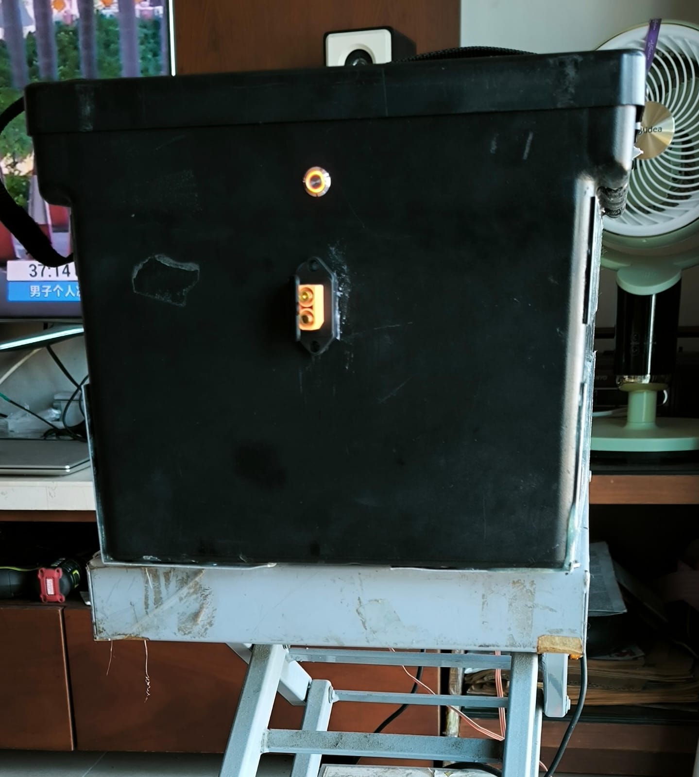

Only do big currents with the rear Anderson!
12 GAUGE Silicone charge wires? 40A max, or they get a bit warm. Safe at 50 but get quite hot. So many different things to consider!
The front connectors are good for about 20A on the banana 4mm ones and the yellow XT 90 can do 40A without getting very hot. But those dont like repeated use much and then they melt. I use those on hobby batteries. So use REAR Anderson!!! Those can do 100A plus. and hot swap 50A.

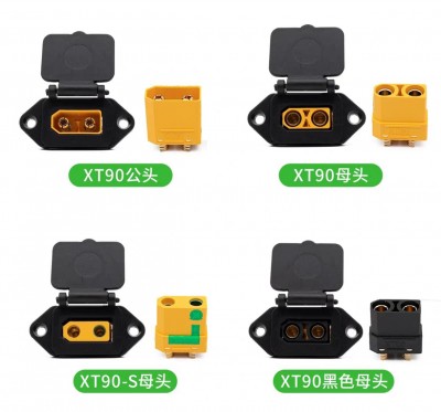

What if we have the cheap version with XT90 only?

Correct. And that flexibility on the ZXD matters!
You also want the power supply to be able to LIMIT current. The BMS cant. Any old power supply will try and charge at whatever power it is capable of. Ohms law says that it will go bang as it tries to pull a dead battery to the supply voltage. The BMS cant control that. Other than by chopping off the power...
All it will do is chop off the power if it exceeds some preset point. You do not want it doing that!
In fact you dont want it chopping off power from the charger OR the chair at any point. All that protection stuff is not wanted!!!
Such as when charging.
You want the CHARGER or supply to control the charge current, AND voltage. And you do not want it too high! The BMS can only CHOP OFF the charging completely on/off as it exceeds some pre deternmined Voltage point. If thats set to say 3.550v PER CELL, or 3.555, then you should be charging at 8x 3.550V. 28.40V. The actual voltages you need will depend on the calibration of the power supply and the BMS. You need to be charging at slightly less than the OVP point.
With balance to start at 3.45 to (prefered 3.500V) and above.
Now while practically anything and any settings will work, in a fashion they wont work properly and will torture the battery and the BMS mosfets.
You want the charger to be able to continue charging without chopping on off at reduced current smoothly so that the balancer can work fully and then as the CV current eventually tails of to a pre determined value To END the chage at the correct point as soon as possible.
