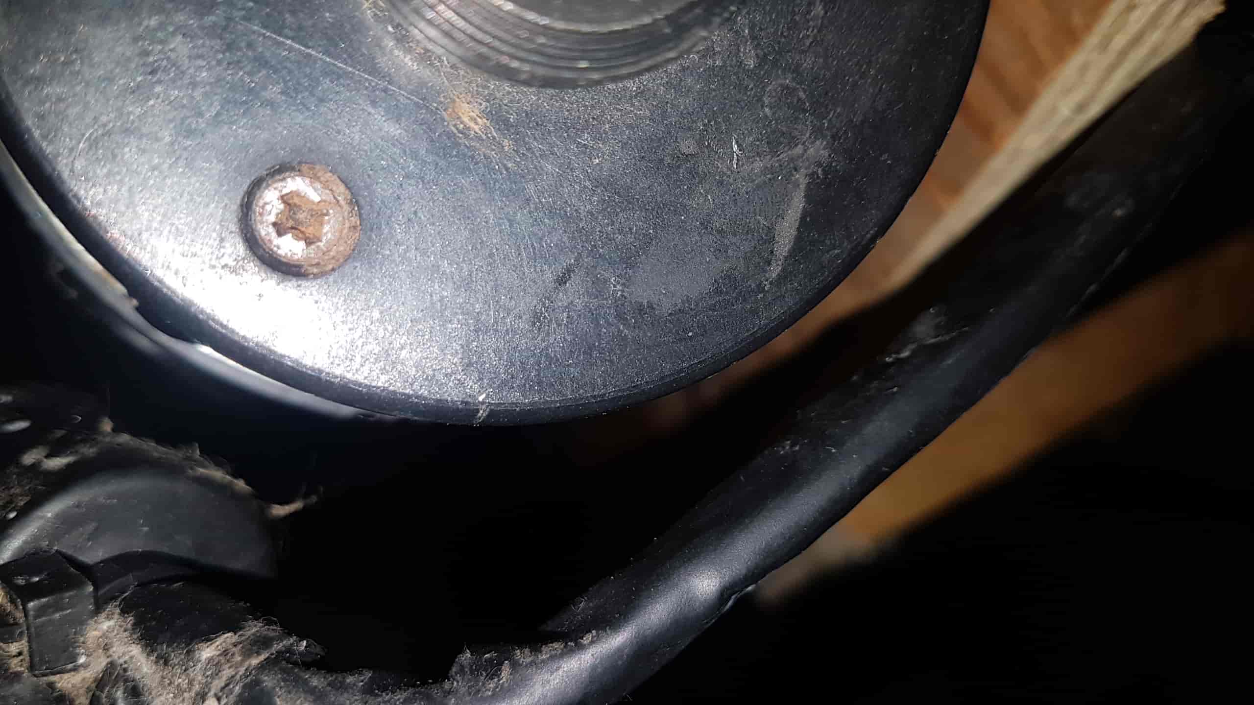

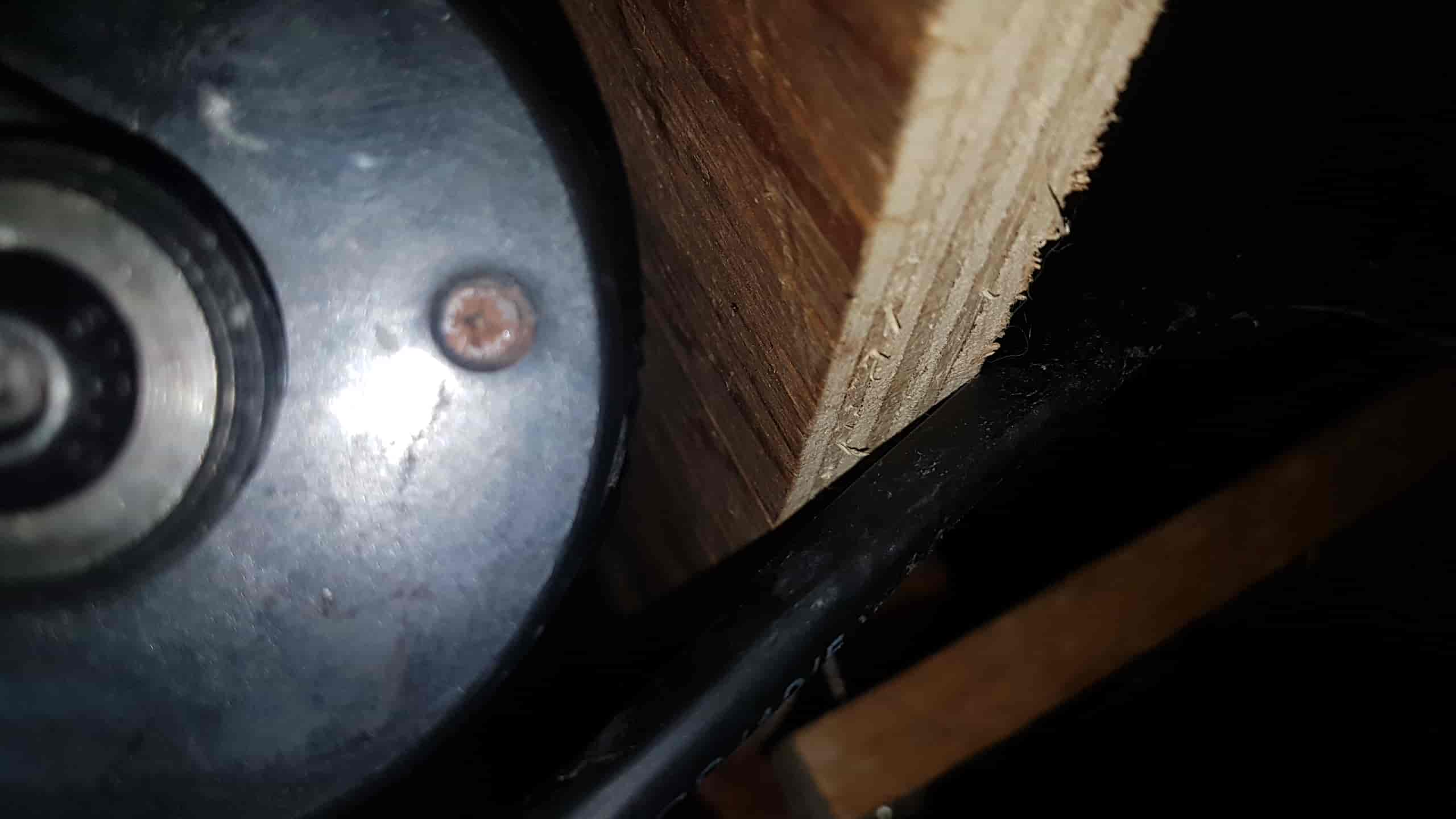

About the black dust. Opening the can would be better but the pozi 1 2 3 dont really fit deep in the front cap screws of the motor. There is probably rust layer preventing to go deep in the bottom. It feels like i would strip them if I try them like that. Also the motor probably has a seal or glue (maybe dried) that would probably not be as water proof after if I open it. The motor works so Im not sure it is a good idea to open it .

here are pict of the front screws

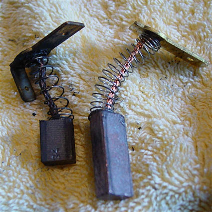

ex-Gooserider wrote:the only real way to get a stuck brush out is to do a lot of wiggling and gentle pulling... It can sometimes help to push down w/ a probe at the same time in order to cause the brush to wiggle in different directions until it lines up with the holder enough to come out. (this is a sign that the brush should probably be replaced...)

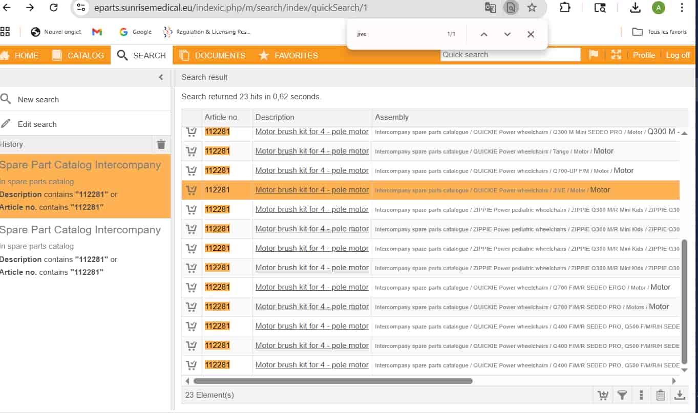

Burgerman wrote:8mph linix motor as used on the Jive chair, same as yours.
Part 112281 Motor brush kit for 4 - pole motor 4 pcs./pack £ 6.00
So £12 total. Plus delivery. Sunparts website.
